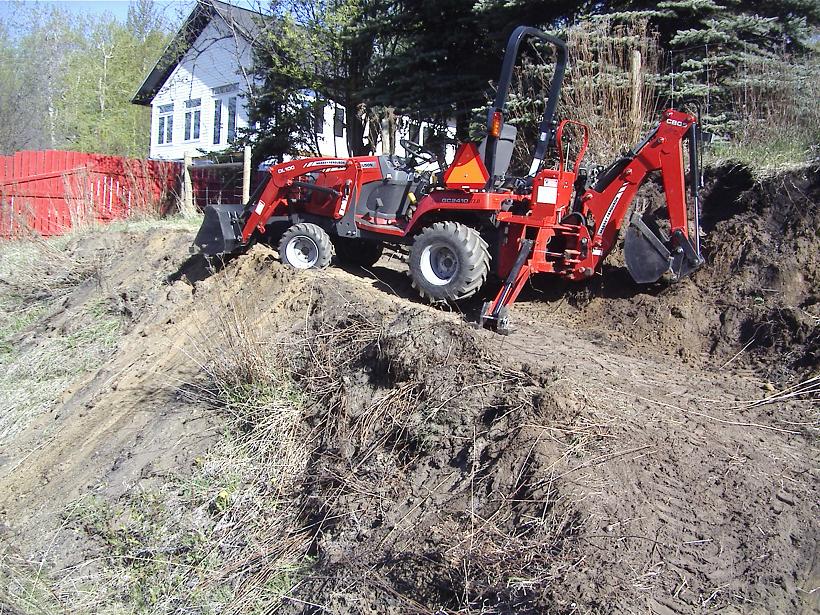

i almost flipped mine over with about 5 hrs on it. learning to run the backhoe, at full throttle, in a dangerous situation is really not good practice. lucky for me there was no disaster, except the near heart attack when i realized the machine was going to teeter and stop, or teeter and go over (with me in the backhoe seat), and there was nothing on this earth i could do about it. good luck with your repairs... cheer up, if your going to use these things, some roadrash is inevitable anyways.:thumbsup:
btw, did you damage your mower?
you can't really tell how steep the hill is from the picture, i imagine these things will keep running even if they are upside down, given that the safety shutoff switch is bypassed with the seat spun around.

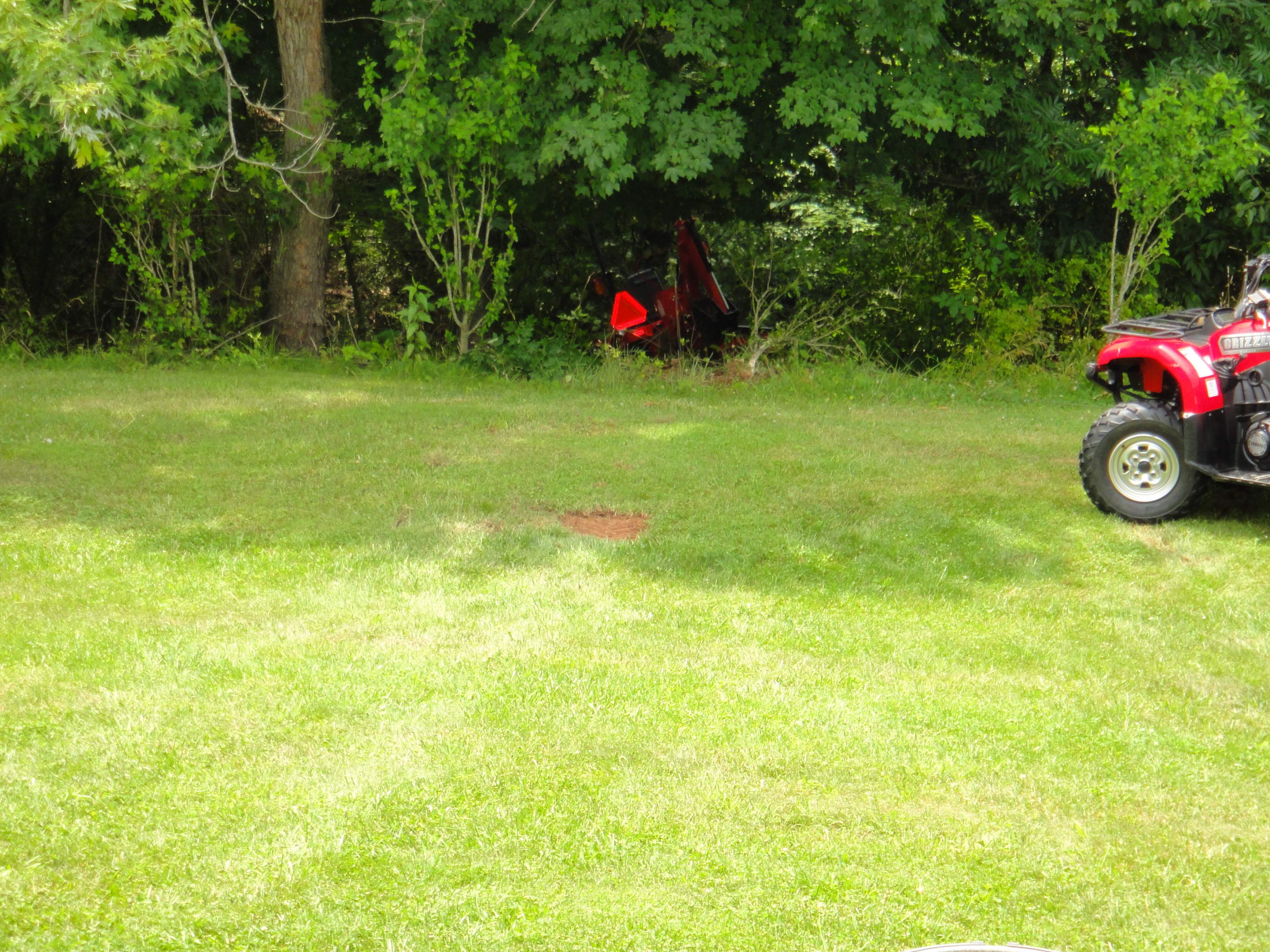

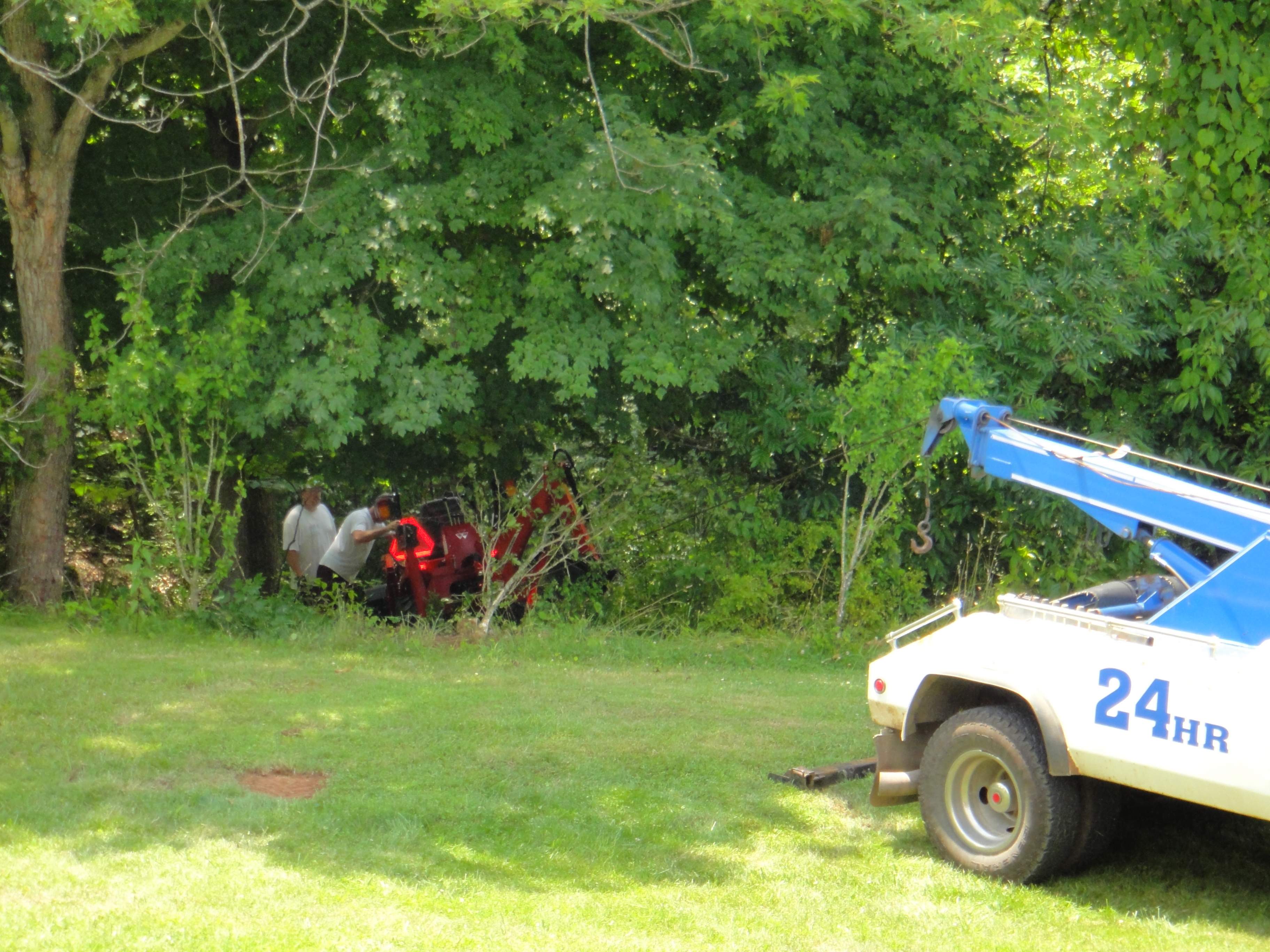

Well nobody got hurt. But who knows about the ones that did. This, I believe, is a safety issue that needs to be addressed. I am going to call the dealer Monday to see where they stand. And I am not looking forward to a long wait to get my machine back. You guys watch I won't see it for a month or 2!

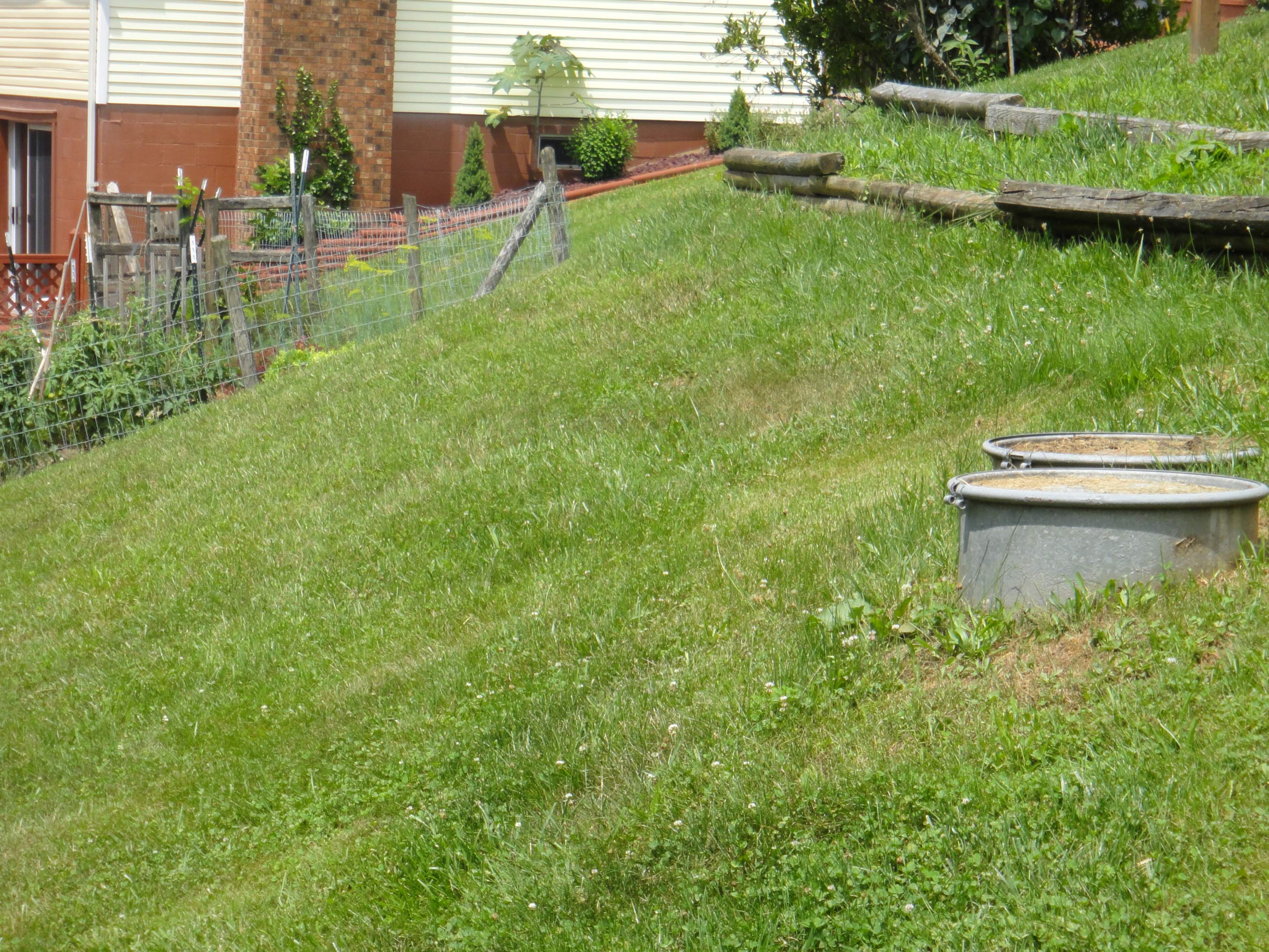

I am going to mention it to them, all I have are hills around here.
And yes the bucket was about 2-3" above the ground, just raised up to move forward, set the brake and got off to inspect the digging I just did and then went to get insecticide. The brake should hold if it was not moving all that time. As I came around the house I heard a loud click, then it started rolling. So if the weight of the tractor is too much to hold, there in lies the problem. I attached the picture of the grade I was on, the bucket did take a small chunk of turf too, and a small tree with it, you can see from the pic attached, but neither slowed it down. As for the FEL being down, if it was not attached, the tractor would have done the same thing, except, with a worse outcome. So FEL or not it should hold. Lesson learned,:mad: I will never trust it again. If the parking brake should not be used on inclines, it should be indicated so. If it holds the machine on the incline, then releases on its own, there is a problem.
