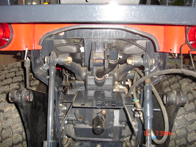

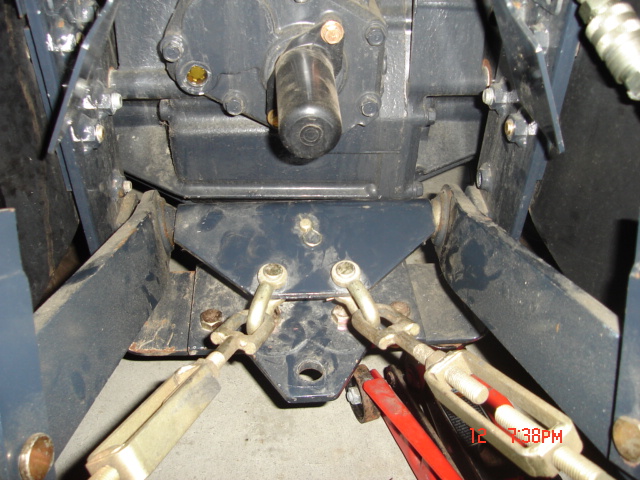

Here it is on the 2310-- same set-up, I believe.
In the first pic guard is in up position, in second one it's down.
When it's down it's secured by 2 bolts on each side; when up, only by one bolt on each side, with unused bolts replaced in their spots.
There's my issue. You can see in you pic how the nuts are welded to the guard for the bolts that are always in place (the pivot bolts). The issue is that the bolts must have been tightened too tight while the guard was up so now when I try to rotate it down the nuts just try to tighten them selves even more onto the bolts and won't let it move. The head of the two bolts are not accessible because of the backhoe frame work. I guess i could grind a slot in the ends of them both and try to loosen them with a screwdriver??

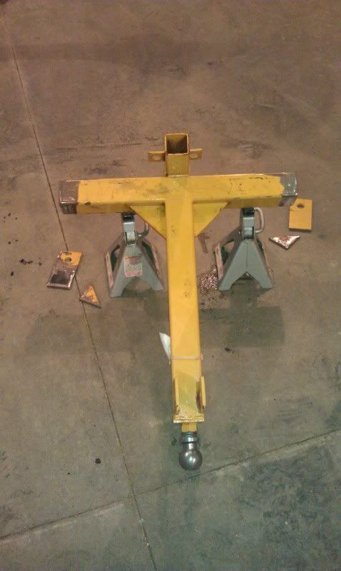

Here is the project I am working on to use the 3-point. It's a trailer mover from TSC. I am narrowing it because it makes the 3-point arms hit the BH mounts. It will be used for towing and I will make more modifications to it to drag logs.
