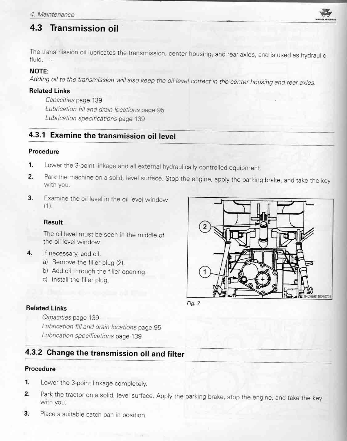

I just looked in my manual again and it's funny what I read that I don't remember I read. It says: "Lower 3-point linkage and all external hydraulically controlled equipment"

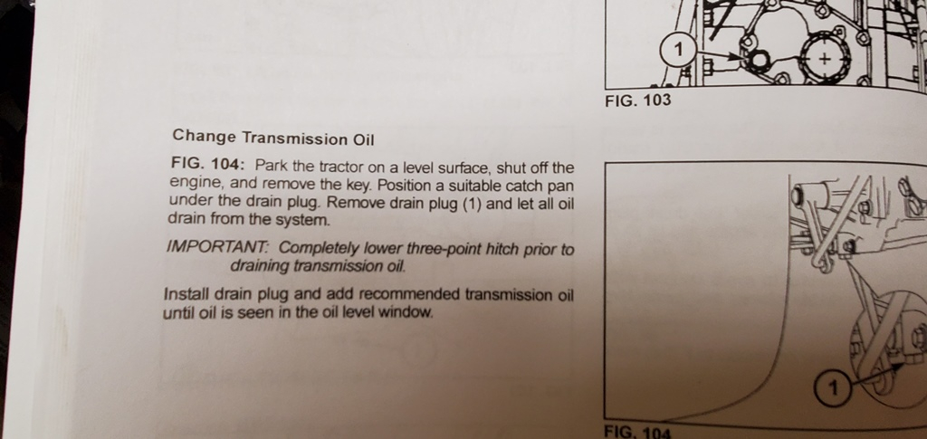

newer tractor and updated manual possibly.
I just poured over the 2010 GC2400 manual again, all it mentions is check sight glass and add as needed. the only section that mentions anything about implement lowering is page 56
under the changing the oil section.
   / GC series checking hydro fluid with bucket on #6
Yep, newer just got it last year. Probably have an update manual as well. I have a different model, but I imagine most of the information in the models is cut and paste. The section in mine that talks about changing the fluid also says nothing about other equipment, just mentions the 3pt.
where in your manual did it mention lowering 3pt and bucket? very good chance I overlooked it and knowing what section you saw it in your manual may prove me wrong about my manual.
