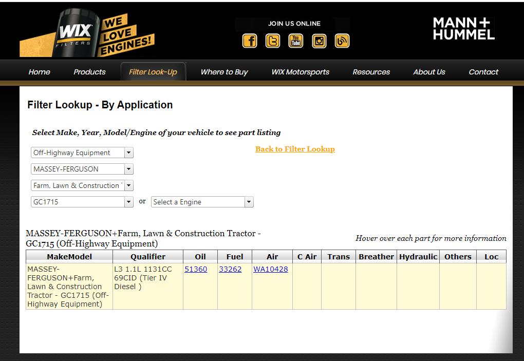

The thing I like about WIX is you can go their web page and put in filter number and you get a page as to all the important specifications like "anti flow back or not", thread diameter and pitch and micron rating. burst pressures, gasket size and so forth... And yes Wix makes most NAPA filters, NAPA just adds 1 or more digits ahead of WIX numbers...
WIX Filters, Wix oil filters, WIX air filters, Wix Heavy Duty Oil filters - Home
For instance...
Part Details
Then there's this sort of lookup....BUT MF does not want you to know the hydraulic/HST filter number but there are several Kubota filter (read as 11 micron) that will fit... MF manual does say buried in one obscure sentence that hydraulic/HST filter is 10 micron rated...
