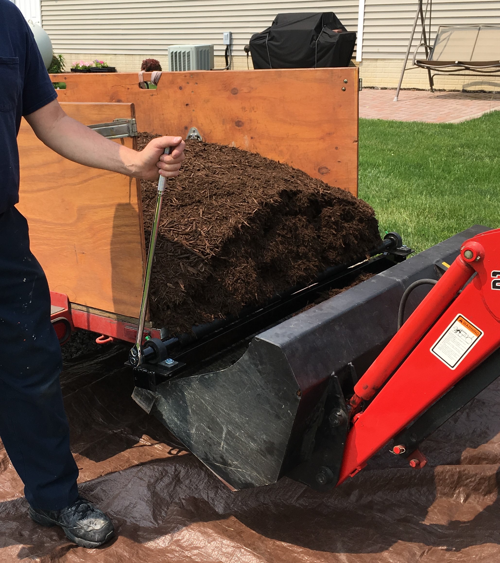

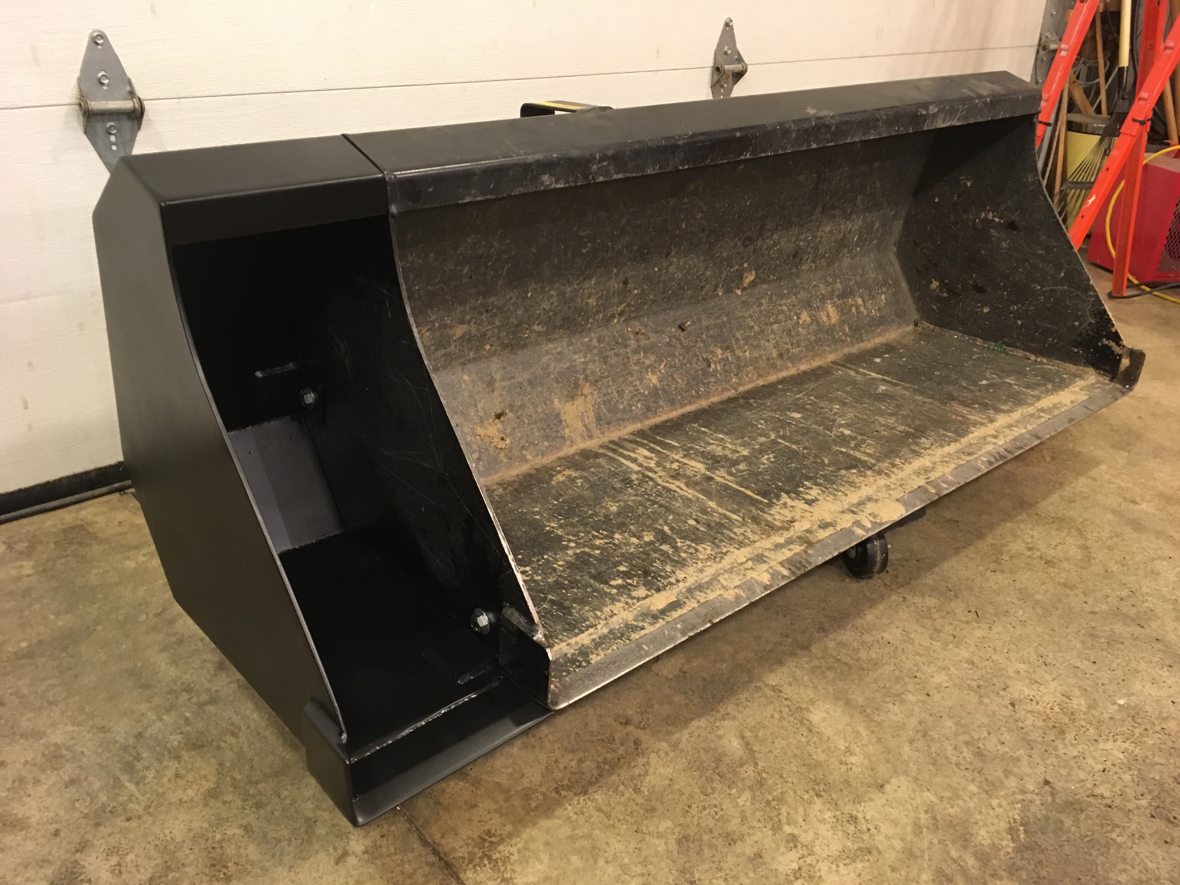

So that bolts on the outside of the side of the bucket, then?
Yes sir.
It was a lot of trouble to gain 7". But, I had all the material in stock, so it didn't cost me much. And, it works great.
You can't see my face, but I am smiling. I can't believe how easy unloading my trailer is now. Might even put an electric motor on it next, so I don't have to get off the tractor. :D

I am thinking about this because I need more snow capacity.

Ok gotcha, that second pic clears it up for me. Cool.

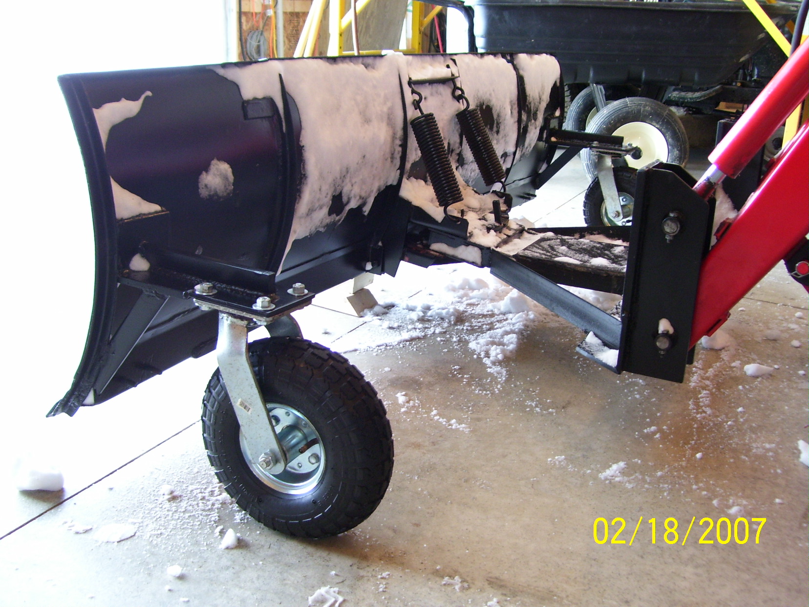

It would probably be best to follow the 12" bucket rule with that. Any bucket less than 12" will tend to have sticking problems when trying to empty it.
I probably would have gone 12", but the materials I had on hand, were 7" wide.
I would have added 12" or more if I was making it for snow. But, since you could eliminate the original side panel, you could weld on a smaller extension.
I have considered welding the extension on, and re-centering the bucket. I know the tractor can push a bigger bucket than this. But, I kind of like the slight off set. It allows me to get close to objects with a little more clearance for the wheels, and still doesn't take up much more parking room in my crowded shop.
You could also make a scoop to bolt on the face of the bucket, since you won't have clearance issues. I didn't have much room to do that and still get under the back of the trailer.
A loader mounted plow is a much better option for snow.
