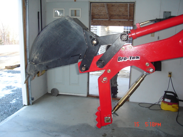

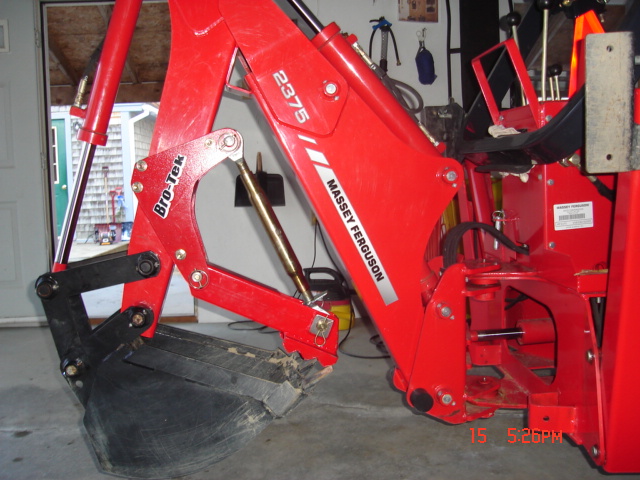

Are you speaking of an FEL grapple or a backhoe grapple ("thumb")?
I have a thumb for my backhoe, and it has been extremely useful. One of the best add-ons I've purchased.
