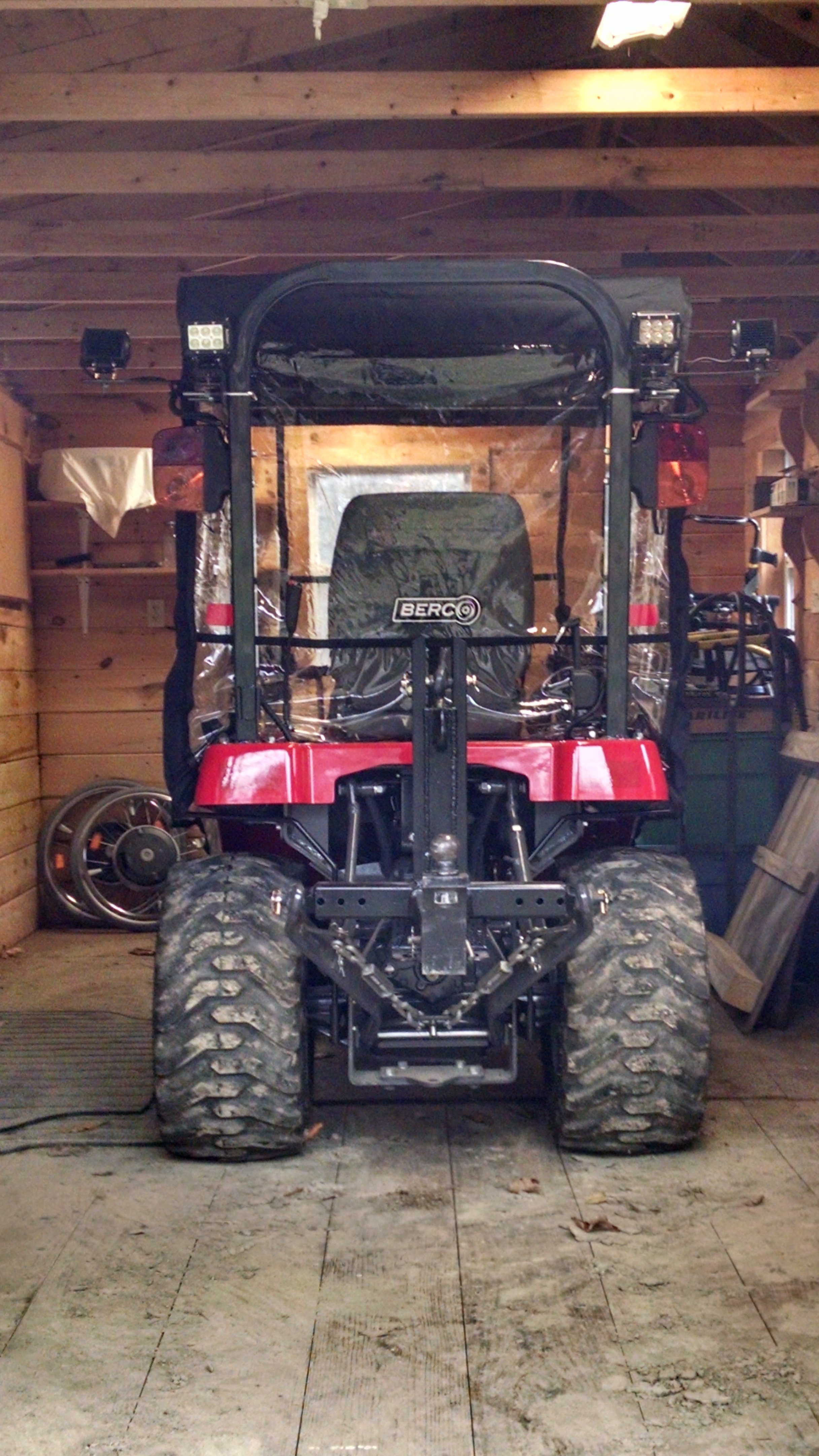

I saw this thread and decided to buy the flashwolf's and give them a try, the stock ones are pretty bad.. I installed four 4 inch led AUX Beam's on my rops and they are nice and bright..
I like it. Those look like they will put off some light. I just finished switching out all of my bulbs for brighter LEDs. Much less watts.

They are very bright, I do a lot of snow removal at night and it's like working in the daylight.. I made the brackets for the rops wide enough because now I have 5 inch LED magnet strobes in between the front and rear flood light on both sides.. I bought the Abrams class one strobes that are super bright even during the day, I'll get a picture of my complete setup up one day..

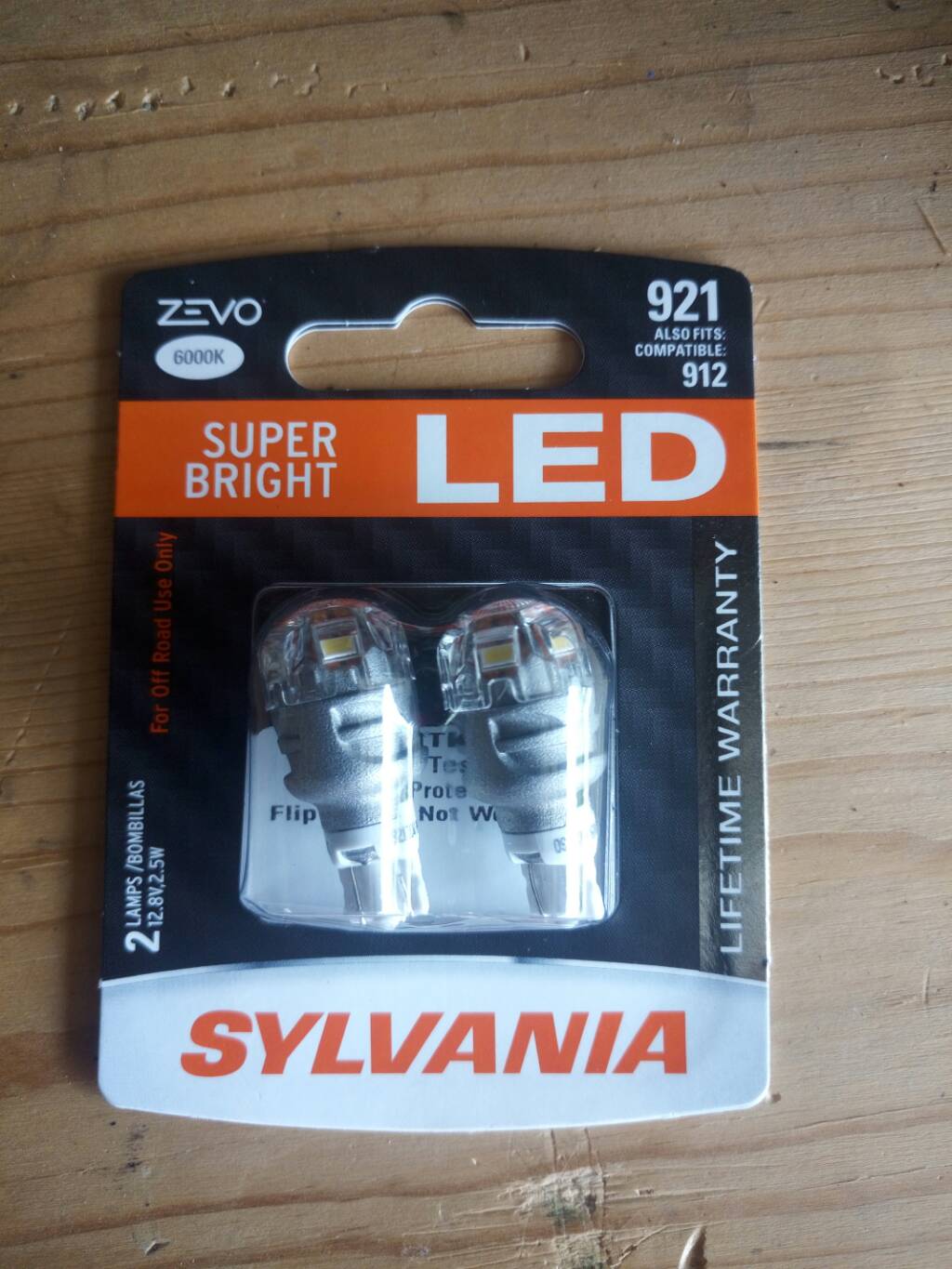

So I installed four of the wolf flood lights, then I went out and bought two of the sylvania 921 for the inside bulbs because I wanted a more concentrated bulb on the inside, I think the outside wolf's and inside sylvania are the best combination.. Either way it's worth the money to change them, it's like a night day differance..

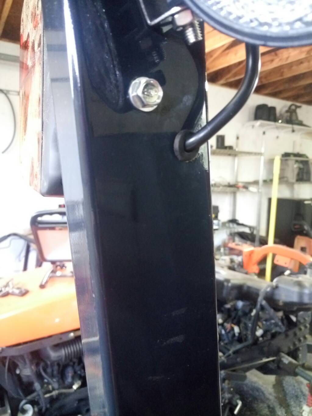

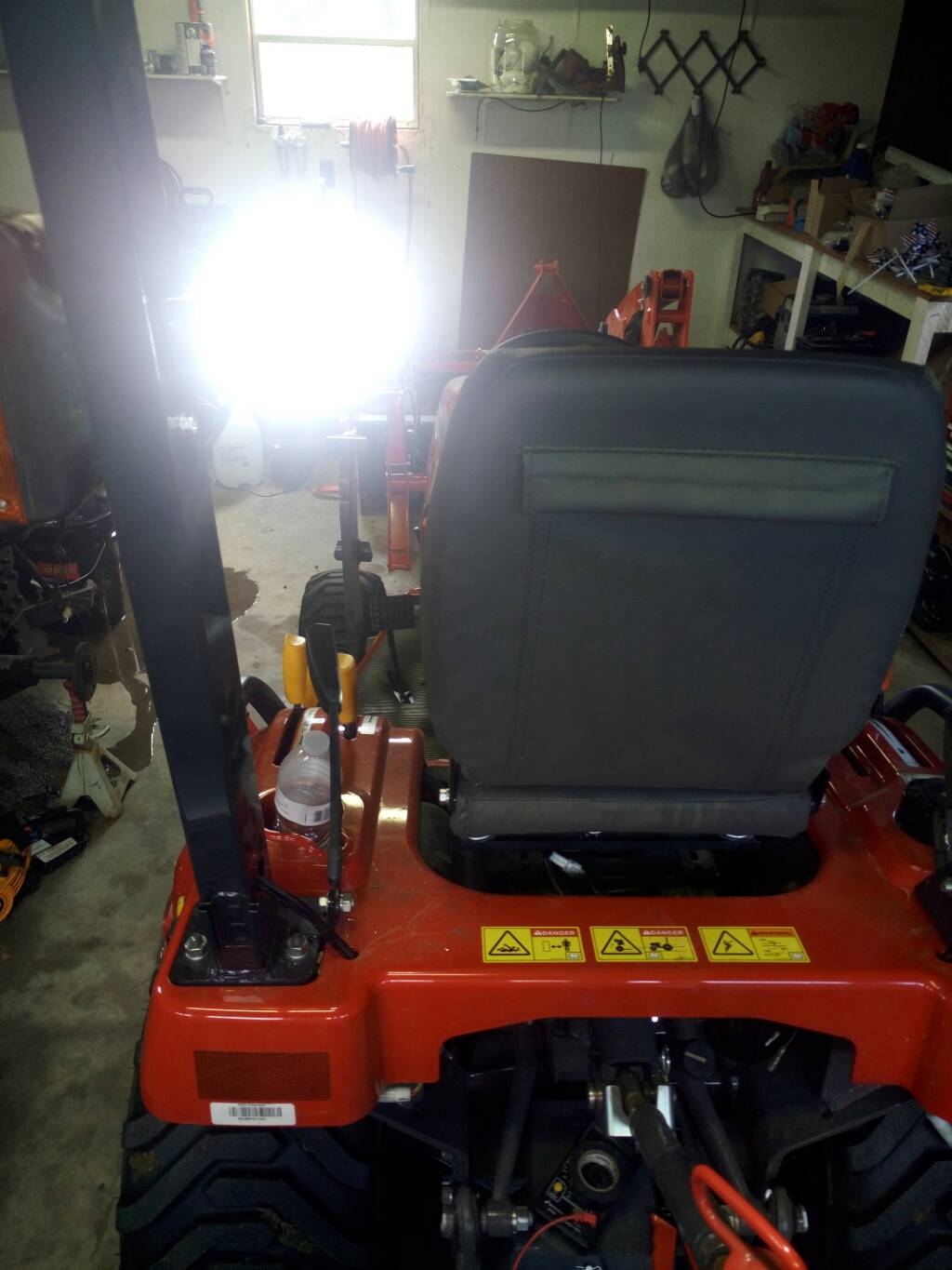

I have to correct some information. The work light is 8x3 Watts. Everything works, but I will run a new power source.
   / GC1705 LED headlight bulbs and rear LED work light. #19
Well, I am done. I used power from the tail lights for my rear work lights. The rear work light is 3 watts. The standard tail light is 5 watts, so I replaced the taillights with some LEDs I had on hand. The LED tail lights are 1.5 watt, so I came in .5 watts under the original power draw on the left side
I was at Advance Auto and pick up two new LED bulbs for the front, just to try. Wow! They are even brighter than the first LED bulb I put in. They are the inside bulbs. $24.95 (pricey)
View attachment 476177View attachment 476178View attachment 476179
Based on info you shared I also installed two of these bulbs. Holy mackerel, what a difference! I'm going to get two more, these things are awesome!
