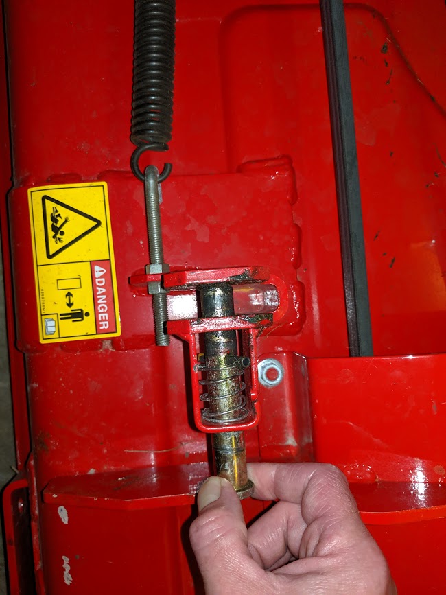

GeneV I have had the same bending problem. I was surprised how easy it bent back. I was thinking that mine bent when I drove over the deck. Now I am super careful with that area.
I wouldn't rule that out, there's not much clearance there between inside edge of tire and that pin if it's pulled back and locked in detent.
I noticed how close the pin was right away to the front tire and put mine back in, I can see how a person could run over it when driving back on the deck, something to keep a eye on for sure.

   / GC1705 MMM deck! #26
Yeh, I also turn them in before driving over the deck. The manual outta be more specific about that.

One thing I found on the deck, the housing holding the slide pins can get bent a little from holding up the deck, off-setting the pin a little bit so that it doesn't line up perfectly with the hole in the tab it's supposed to go in. If you notice it's hard to pull those pins out when you're taking the deck off, it will be even harder to put them in fully when you're mounting the deck, and the following time they won't even fully engage with the tab...meaning your deck is not properly attached to the tractor. If you see that happening, the simple remedy is to hook a pry bar or something along those lines under the pin, using the fin (just underneath my thumb in that pic) as leverage. Just pry up on that pin, which will bend the housing it slides in enough to line it back up with the tab. The pic shows how the pin wasn't going fully in the tab until I bent the housing back into place.
