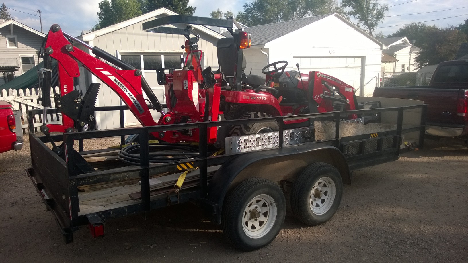

Just measured mine, rops done is about 60". With the backhoe boom locked with the pins about 70". You can drop the boom/bucket to the deck of the trailer and you should be ok to fit. The annoying thing is that the rops "rests" on the backhoe boom when its down.
   / GC1710/20 clearance
#12
Awesome, thanks for taking the time to measure! I'm assuming the trailer isn't more than 20" right? I guess I should be able to find a trailer that isn't if that would end up being the limiting factor. Thanks again!
   / GC1710/20 clearance #13

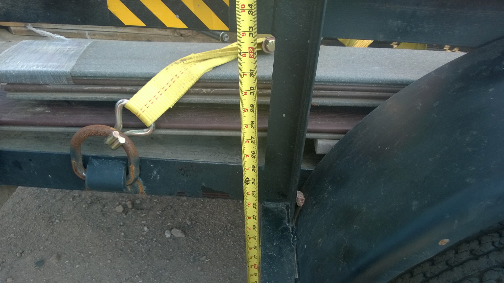

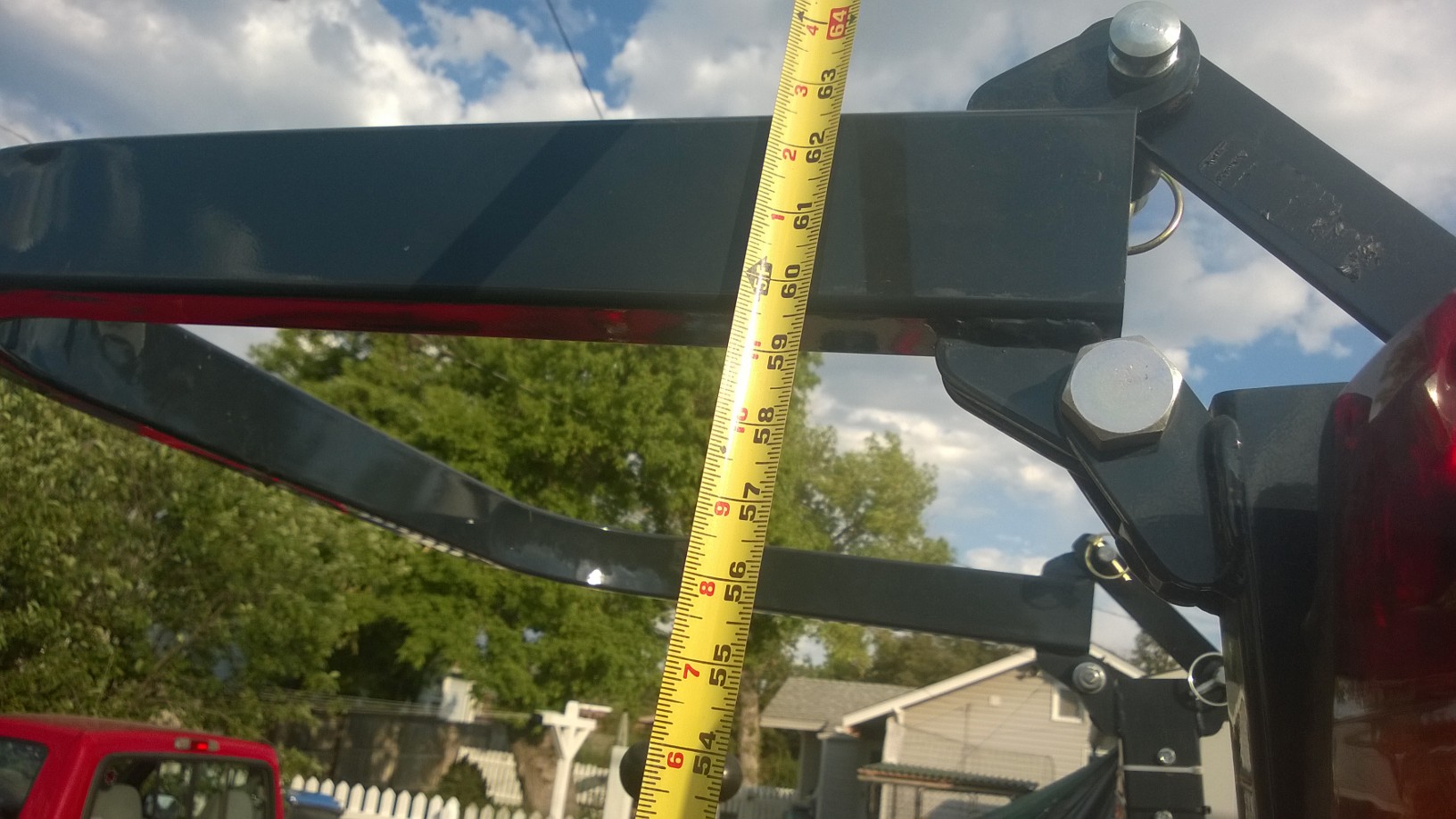

Well, here you go.
Trailer height - 25 inches
From deck of trailer to top of rops - 64 inches.
I built some brackets to keep rops off backhoe and keep it level. Rops is the tallest point.

Awesome idea for the brackets! Might have to steal that ;) What length is that trailer?
16 foot trailer. It fits the tractor perfectly.
