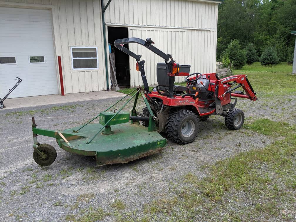

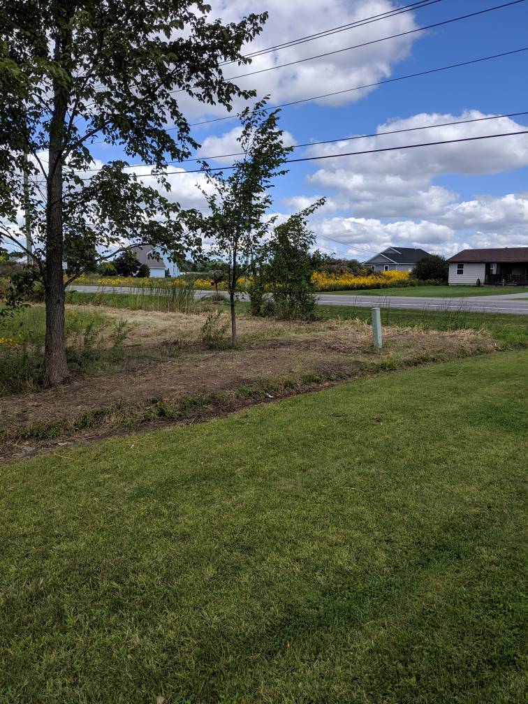

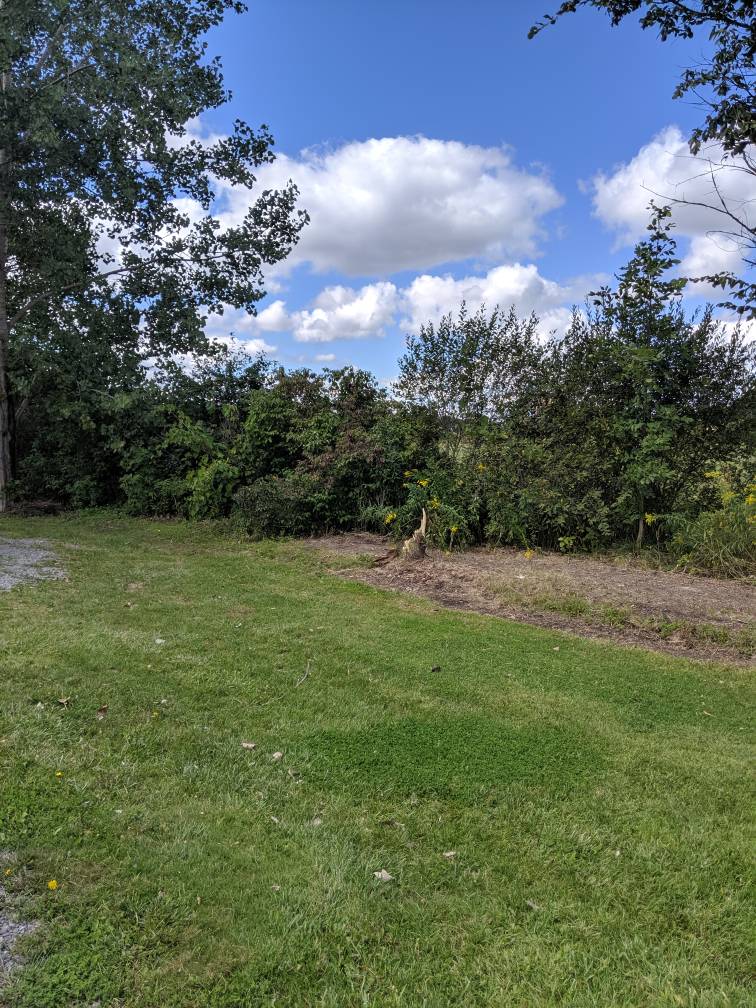

I have the GC1710TLB running a 1960's John Deere Gyramor 205 5' cutter. Works well. To run it at least the front loader arms have to stay on for counterbalance and I'm usually in 4wd for traction in uneven fields but the PTO absolutely can run it. This particular model uses a friction plate slip clutch. I took pictures of what the hedgerow used to look like vs what the cutter did and I was fine. Cut 2" crab apple trees (which was noisy) but the tractor took it like a champ. The hard apple tree wood is the first time it's even bogged down but it didn't stall it. Cutting grass runs like butter. Keep the blades sharpened and I think you'll be absolutely fine. IMG_20190720_113217.jpgIMG_20190905_122059.jpgIMG_20190905_122107.jpg

Added note. Assuming you haven't added wheel spacers your tractor width should only be about 44-45 inches. A 4' cutter is the cutting width typically and the actual deck is a bit wider than that. 4' or 5', both would cover your tractor width
