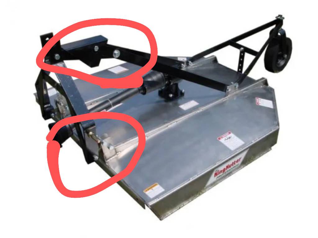

Newby here,what is a flex hitch,or guick hitch?
Flex hitch is a king kutter exclusive 3pt implement hitch type that allows the cutter to articulate about 15° on the horizontal axis and roll up and down freely on the vertical axis without binding up on the tail wheel and 3pt system. They're a pretty neat concept but patented last I knew so no one really has anything quite like it except king kutter. Screenshot_20190905-180926.jpg

Flex hitch is a king kutter exclusive 3pt implement hitch type that allows the cutter to articulate about 15° on the horizontal axis and roll up and down freely on the vertical axis without binding up on the tail wheel and 3pt system. They're a pretty neat concept but patented last I knew so no one really has anything quite like it except king kutter.View attachment 619977
A chain for top link (lift) will do same thing....
