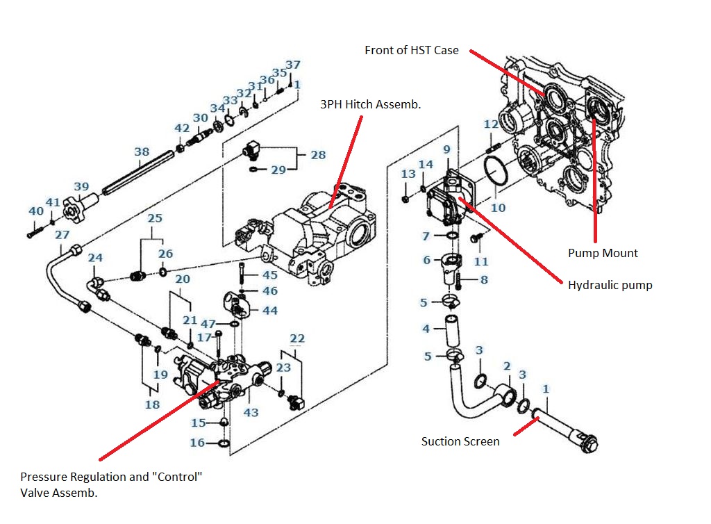

Hmmm. You didn't have the same experience that I did. I wonder if I legitimately have an issue with my HST, then.
/ GC1720 - Deadheading hydrostat? #42
It might just need some adjustment, after all they are built/assembled by humans.
Jim.
#43
I have no idea how to adjust the HST pressure. Hopefully someone can help me out, there.
/ GC1720 - Deadheading hydrostat? #44

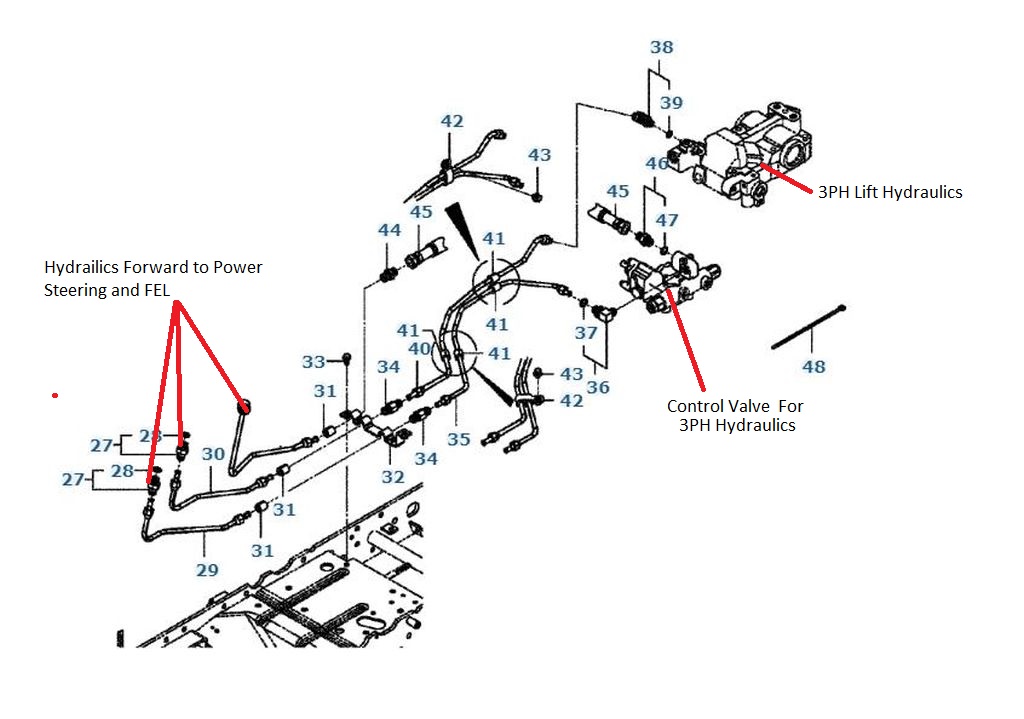

Shop manual (Section 4.7.6 - Page 4-52) seems to indicate it has internal spring and poppet for pressure relief and does not have any external adjustment or port for checking pressure.... Pressure changes (adjustments) seem to be by shim washers against a spring under a cap plug... I see no comment/documentation where to hook up a pressure gauge....
