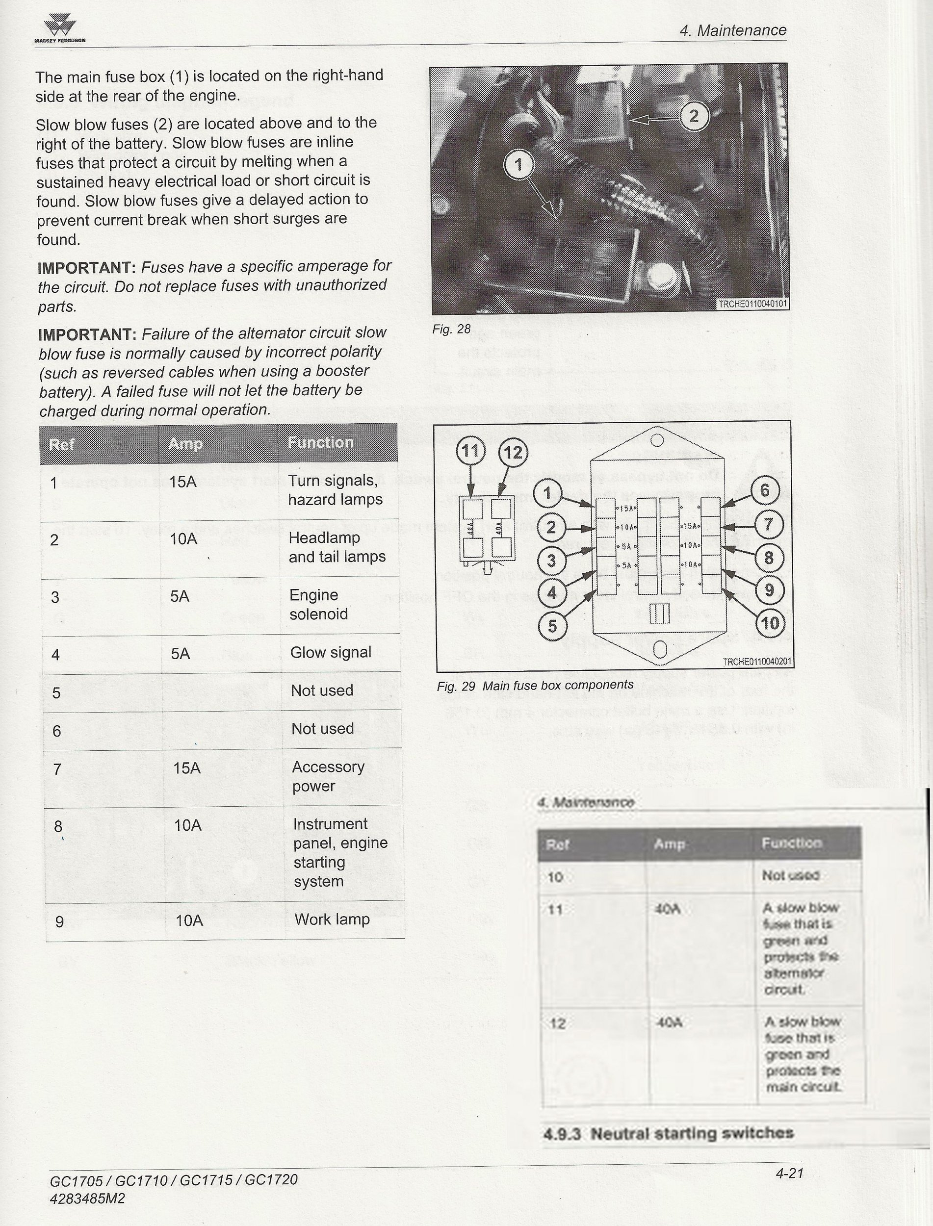

Here are the wiring diagrams

your going to need to link the manual. I can't read that well enough

Positive (+) side of battery goes directly to large terminal on starter, from there power (voltage) goes to fuses #11 and #12.... Check for power (voltage) at fuses #11 and #12 first.... Negative (-) side of battery should go directly to chassis as "ground"...
Be sure you have voltage on both sides of fuse #12.... From fuse #12 voltage (power) goes to main switch terminal "B" (#25 on diagram) and to fuse #3 for engine stop solenoid. ....
Blurry lettering for #12 fuse reads "A slow blow fuse that is green and protects the main circuit"...
