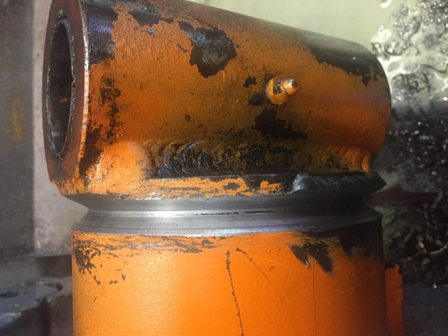

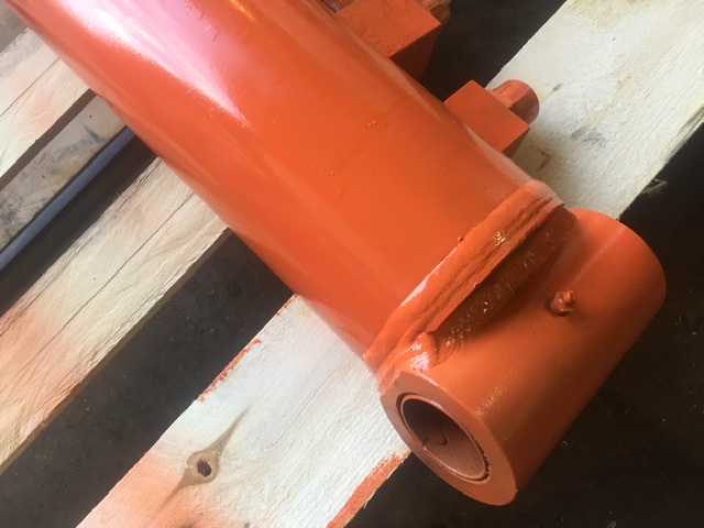

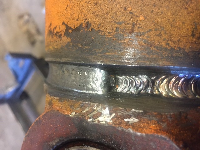

Some shops use compressed air, unfortunately it is not a proper and accurate test of a cylinder rebuilt. Our test unit is rated for 3000 psi but is capable of intensification of up to 5000. After a fresh rebuild it only takes minutes to ramp it up, operate the cylinder at full in/out and mid stroke, then an air purge to recover most of the oil (if it doesn’t have counterbalance/lock valves).
Here’s a few pics of a cylinder that leaked above 1000 psi (cracked at cyl base plate), we had to machine, reweld, repack and test to 3000 psi. Compressed air would not have shown a leak. 876BB515-82BE-4805-9BB8-EDF2AB615F6E.jpeg0D6F073E-22E8-4A28-9C08-4E4D91F89C5E.jpeg970397D8-BC7C-4EDC-9391-EE0BC71A7ADB.jpeg
