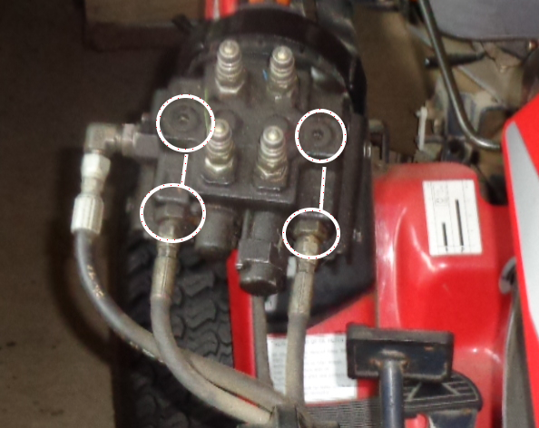

I had all 3 control-to-tractor lines made new. got cocky and took all 3 lines off without labeling. figured the correct connections would be in the manual like they are for the FEL lines.
welp, the manual shows only 2 lines and the various parts diagram only confuse me more. I'm second guessing my memory because the new lines have longer metal sleeves and one of the lines seems slightly short. The icing on the cake is the lack of documentation from the nimco site. it's as if the 10339-2S never existed! I can usually get my geek on and get out of a jam like this by reading documentation, but I just can't get the info I need.
controller is Nimco 10339-2S
I did some searching and have determined that some GC2300 have been 'upgraded' throughout their life with a 3rd power-beyond line. later models included this from the factory.
anyway, I can narrow my question down to these two questions:

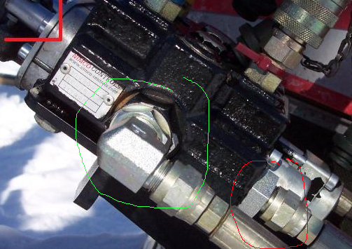

- can anyone confirm where this side-port (Green) line goes to?
- can anyone confirm that the red port goes to a 90deg elbow on the back of the tractor?
also, what are the consequences of guessing? I imagine either no control (fluid going strait to tank, or pressure side hooked up to tank side), triggering the relief valve on start-up, or weird control issues... but i'm not sure if one of those scenarios will damage something or myself

Can you get a good look at the 2 ports that are the Inlet and the Tank ports on your valve? The inlet could be labeled with a P (for pressure) or I (for inlet), and sometimes the words are actually embossed right on the body.
Then maybe T or R for return to the tank.
Try blowing into one of the hoses. I would wager that the return-to-tank hose would allow your lungs to push air thru it. Doubtful you could blow thru the pressure supply hose back into the pump.
It might be helpful to get your hoses bundled and pointing into a 5 gallon bucket. Roll the engine over (or quickly start it and shut it off) and note which hose supplies pressure and which one doesn't.
Typically the Pressure and Tank ports are on opposite sides of the valve, opposite of each other. The Delivery ports are usually side by side on another face of the valve.
It is very possible to wreck something in the valve body, the pump or pump drive train if pumped oil doesn't have a way to flow. The oil needs a circuit from tank to pump and then thru the valve body and back to the tank. If you supply pressure to the wrong port, perhaps even the relief valve might not relieve it. This could cause catastrophic damage, so proceed carefully.

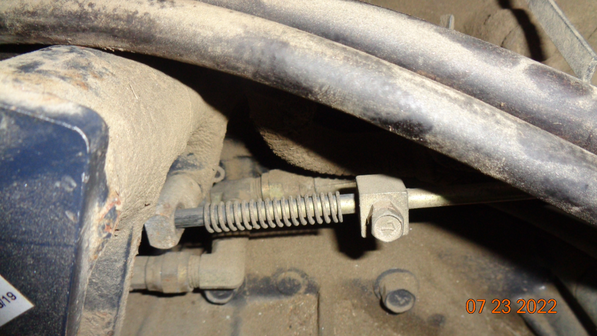

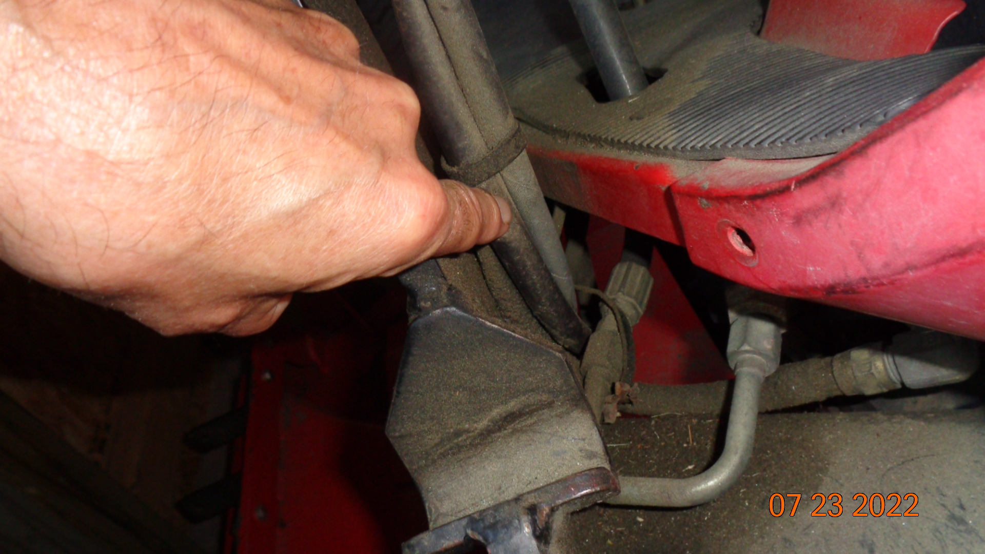

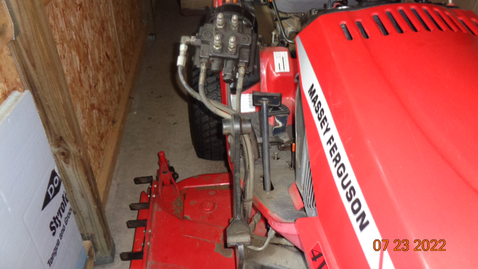

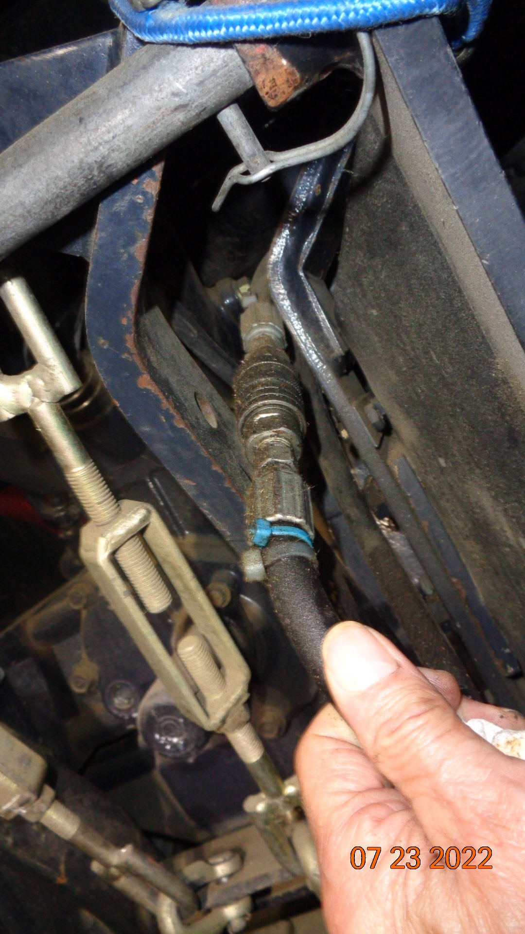

The one you have circled in red --my finger's on it in the second pic-- is the one that goes all the way back, connecting to another line to become the return circuit when the backhoe's off. On my 2310, it has both a white and a blue zip-tie marker on it. When the BH's on, those two lines separate and connect to two of the BH connections (one male, one female).
The one you have circled in green goes to a metal connection on the side of the transmission -- just behind the spring in 4th pic. On mine, it's not a 90, just a straight-in connection. Hope this helps.
