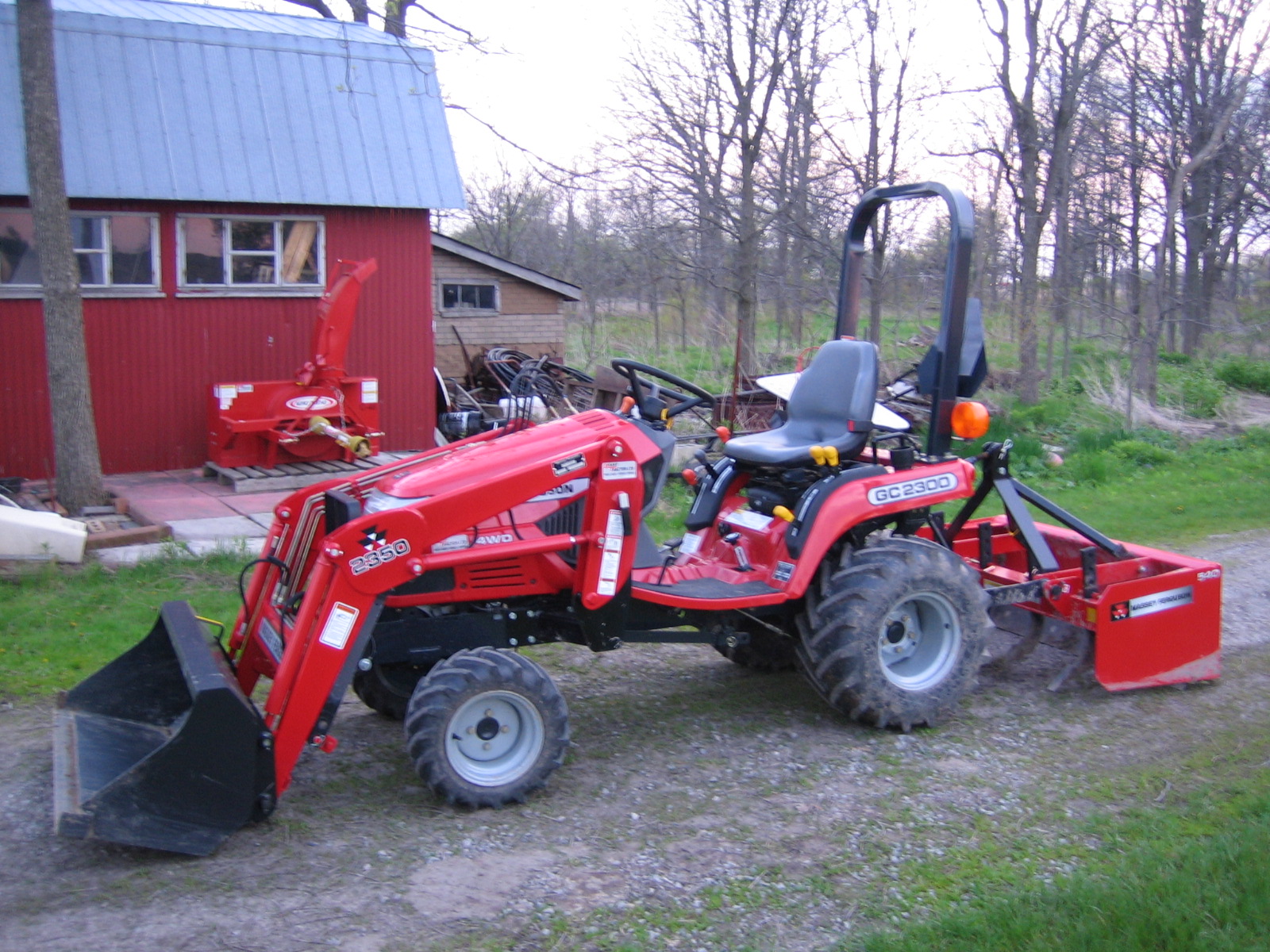

I use a 48" MF540 boxblade with mine, bought it with the tractor to take advantage of the financing rates.
The 48" boxblade is more than enough width unless your scaping sand. It will still bring the tractor to a complete stop if the angle of the boxblade is too aggressive(tilted too far forward), but it has little problem with a full box of material. The scarifiers make breaking up hard surfaces very easy. Sometimes the boxblade will just bounce around unable to bite into the ground. Lowering the scarifers allows for easy breakup of material. In my use this has been the big plus with the boxblade. I spent 12 years using a rear blade on my gravel driveway using a much bigger tractor and always had to fill in the potholes again after the next heavy rainfall. The boxblade w/scarifiers means I can do it just twice a year now. There is a huge difference.
The 48" is narrow enough that it will fit into the width of the FEL and cover the tracks of the tractor., and makes a good counterbalance. I never take mine off until it's time to mount the snowblower.
In my experience a rear blade hasn't been needed, the boxblade with scarifiers and FEL can take care pretty much everything.
   / GC2300 box blade question #6
DMW
I see a snow blower in the background of you pic. Is it a 3pt model? How do you like it? $$$? I have about a 700 foot paved driveway and I am torn between plow and snow blower. I know not related to thread but I had to ask.

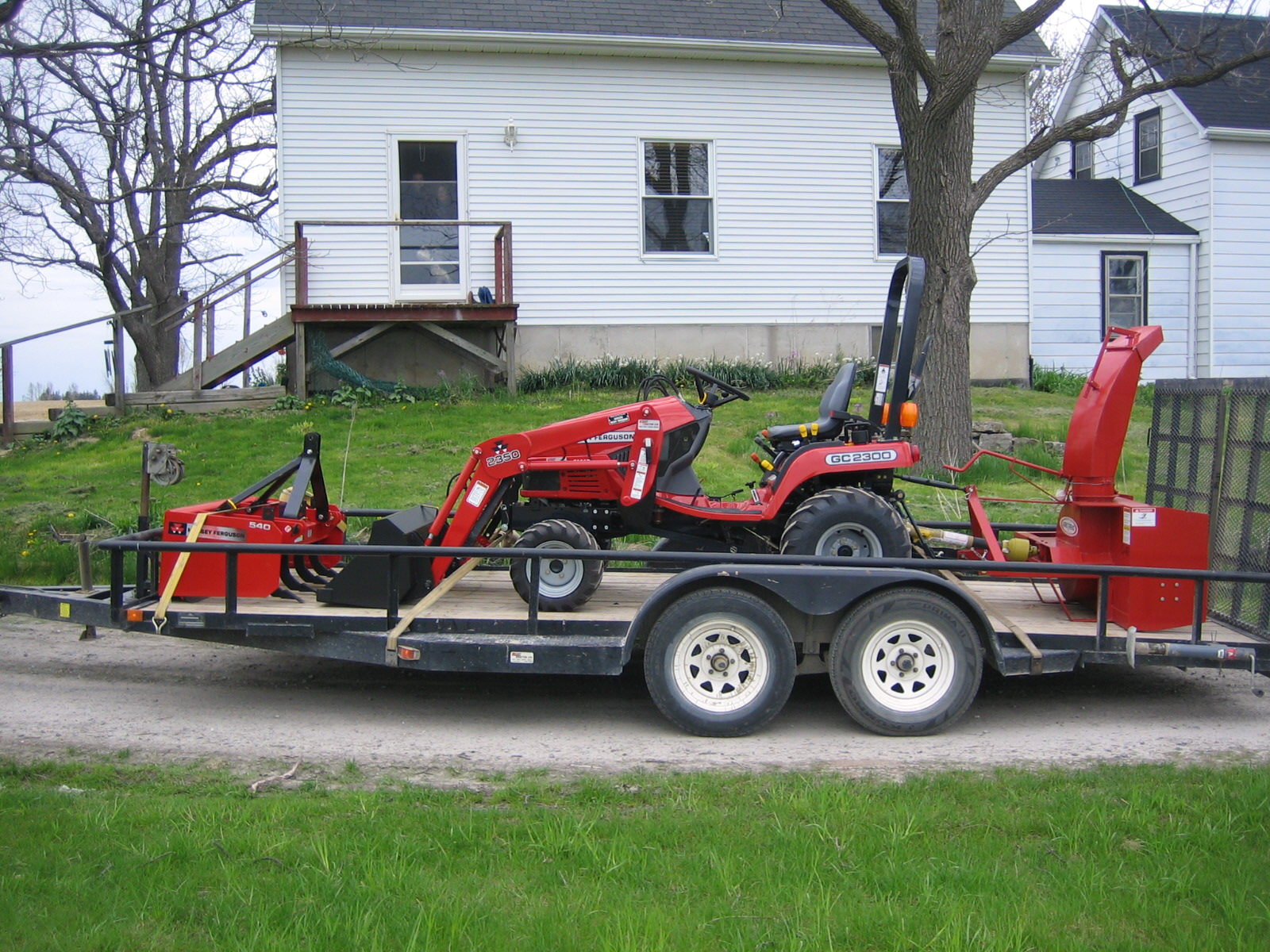

Agro-Trend 48", 3ph. $1100 cdn.(excluding taxes) 16 months ago. Not sure if it was a good price, my wife bought it for me. 3 passes of the driveway does it. A 60" would have still required 3 passes to do the driveway. I have included a picture of the tractor with the blower. It extends out a lot farther then the boxblade, lever effect even when on the ground made steering difficult. I don't think the front blowers have this problem but cost a lot more $$s. I could have just put a couple cement blocks in the bucket but instead got the front tires foam filled. Each front tire now weighs 64.5 pounds. The extra weight made a noticable difference in steering control. I was also paranoid about scrap metal in the ground (the farm is over 150 yrs old) ,old fencing and discarded parts everywhere!
After 3 shear pins I finally learned to engage the PTO at idle. No heavy snowfalls last winter, 6 inches of powder was the most. It has no problem with it or the wettest slush, it blew it all.
I have used both a front blade and rear blower in the past on other tractors and have a preference for the blower. The sides of the driveway stay lower and collect less drifting snow, and having a gravel driveway the blower leaves a lot more stone in place. There was always a 1/2 to 1 inch of snow left, but the sun would melt it quickly. If you get a lot of blowing snow the blower is better IMO. I am surrounded on 2 sides by sod fields, and an open field on another. The drifting can be worse then the actual snowfall.
