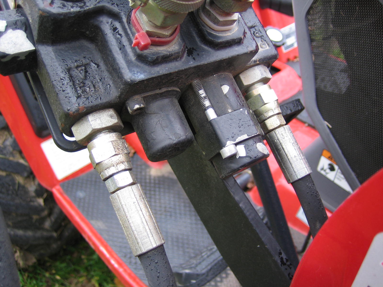

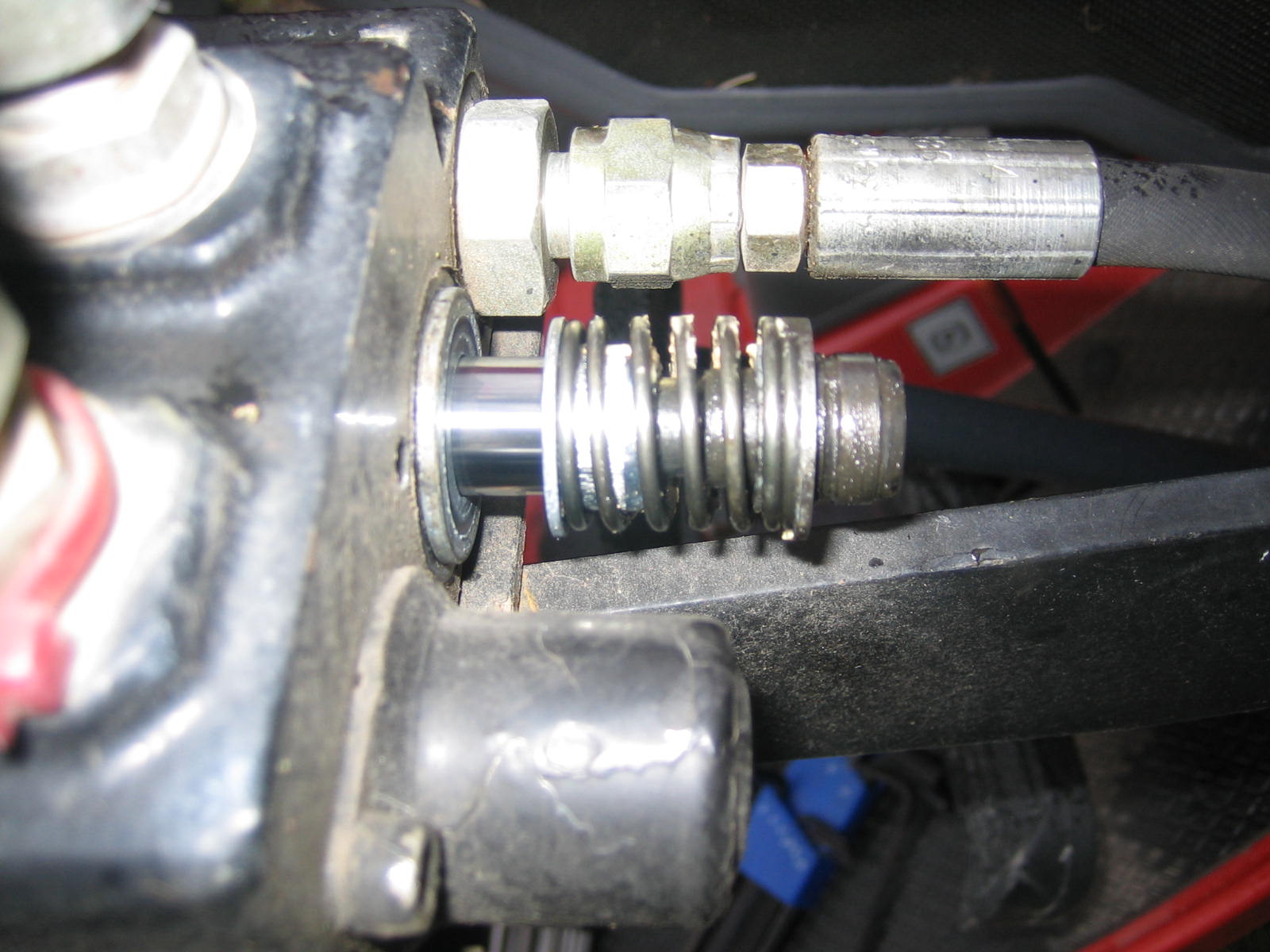

I had a similar problem, losing the float at 10 hrs, and lifting the font of the tractor if I tried to use it. The dealer came out, removed the end cap off the lift spool, tightened up the end of the spool which had come loose. The bolt? on the end of the spool had loosened off and extended out so that the lever could not push the spool forward enough to engage the float. It was hitting on the the end of the cover.
My spool cover is held on by 2 4mm hex key bolts. A 7/32 will work, but can slip when tightening. Remove the 2 bolts, the cover will come free, be careful not to drop anything. Check inside the cap, you'll see a metal ring inside a groove, that's the detent. Make sure that it is intact and moves freely in the groove.Check the bolt? on the end of the spool to ensure that it is tight as well. 4mm again I think.
The bolts are on tight, a little penetrating will help.
I added a couple pictures showing the valve body and the end of the spool. You can see the paint chipped off the lift spool cover.
It also could just be dirt inside the cover stopping things from moving.

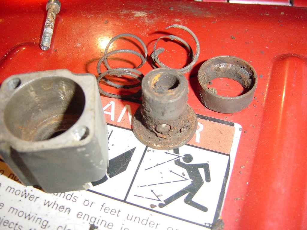

   / GC2300 - Got Float? #18
I have float! Thanks to DMW and the others who responded I was able to find the problem with my FEL control and now my bucket actually floats. If it had not been for this forum I would have probably never thought the FEL could float.
The end cap was completely filled with junk and the spring was really corroded. Will probably have to replace the spring eventually, but after a good cleaning and greasing it seems to be working good enough for the time being.

   / GC2300 - Got Float? #20
Thanks again for all the help!!
Get you a generic spring from the hardware. To get the right strength, you may have to stretch or cut it. I rewound one to fit. If you get the parts from Massey / AGCO you will have a heart attack from the price and Nimco won't even talk to you about parts. Hopefully you won't need any other parts. I know that mine looked almost as bad as yours and it cleaned up pretty well. I put Mobil One synthetic grease on everything under the cap to prevent it from happing again.
