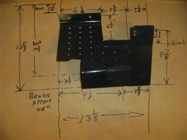

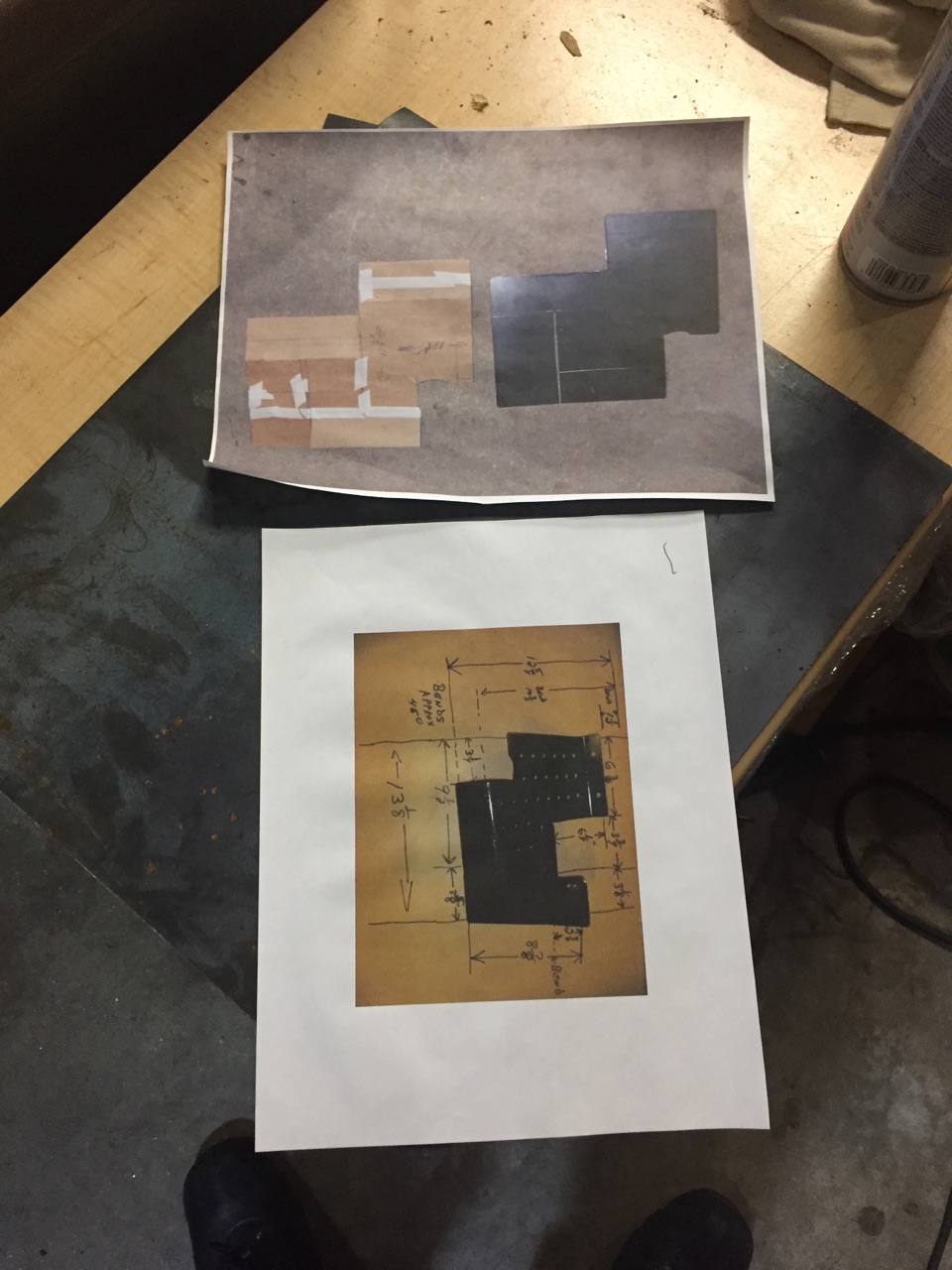

Any chance you can draw up a pattern for the fan guard? Or just another picture of your template with dimensions?

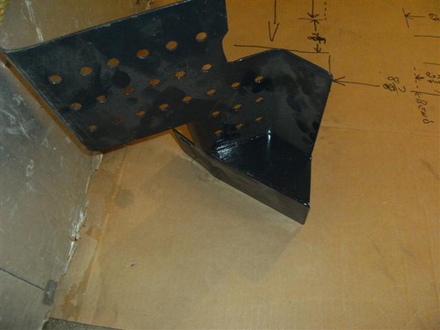

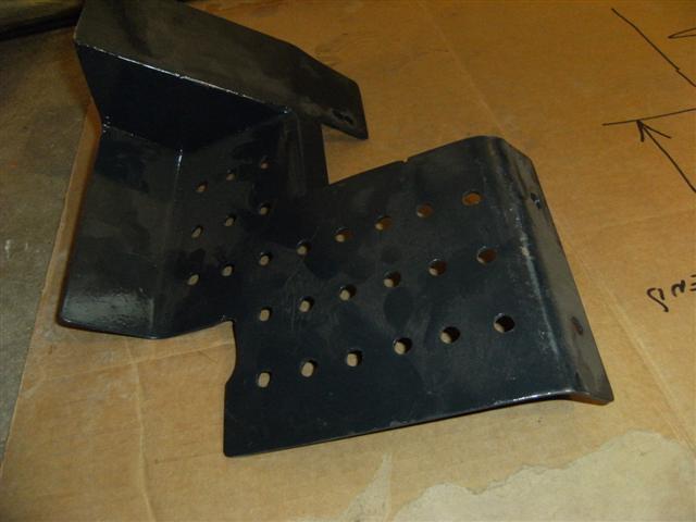

I went out and took some pics and measurements for you this morning hope it helps.I can say this seeing that I built my own filter guard mine gonna be different then factory one.My advice would be for you too make a mock up one out of cardboard [I use cereal boxes] and make it to fit yours out of cardboard first then you can lay the template onto the steel plate draw it out cut out and bend and fit.:thumbsup:Larry

Perfect! Thank you!

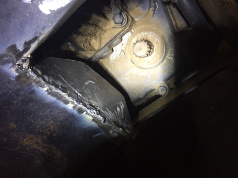

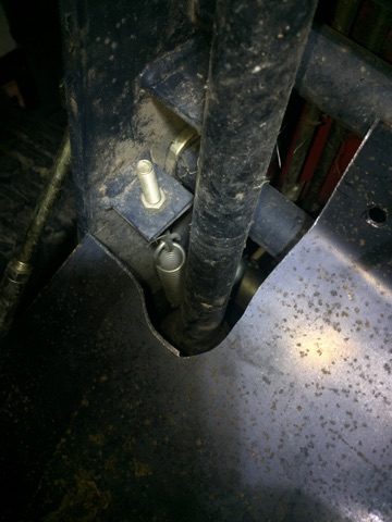

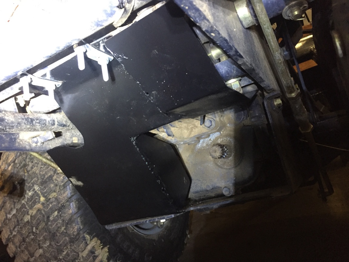

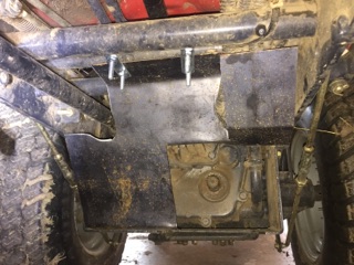

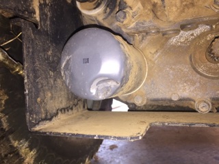

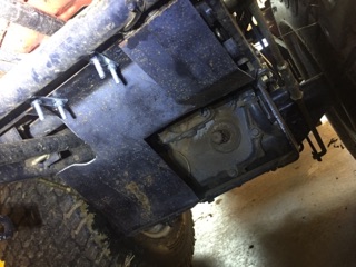

Resurrecting and old post to say THANK YOU Larry.
Took the measurements and used them to make a guard for my GC2300. My oil filter had a dent in it and it was time for some protection. It was not to hard to make up. Pardon my example does not look as nice as Larrys' but it will get the job done.
