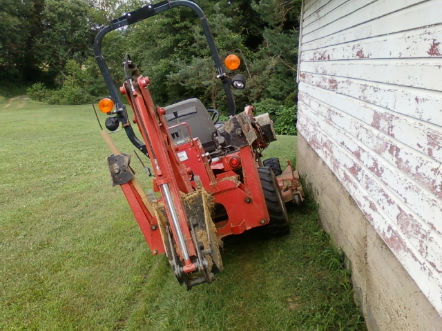

I go across some slopes at about 20 degrees and have not had a problem. But I have a BH for weight on the back. I even swing the BH for counterbalance on the steeper stuff if I have to go across it. What are you using for weight on the back of the tractor? When I don't have the BH on I have to be much more careful where I go and what I can do because of not having enough weight on the rear. Just be careful because you DO NOT want to find the true limit. Also keep the FEL as low as you can.

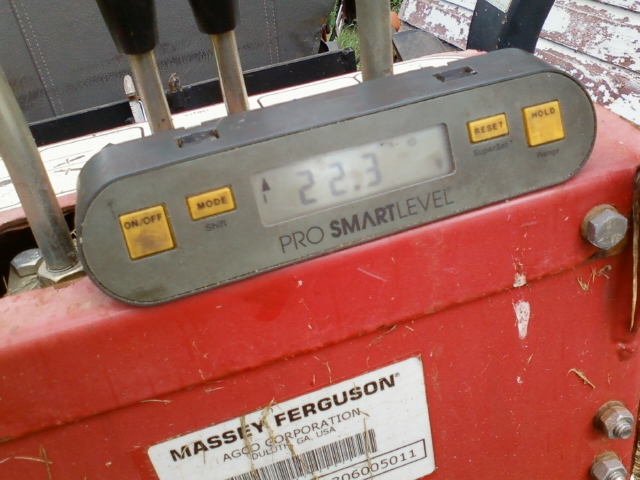

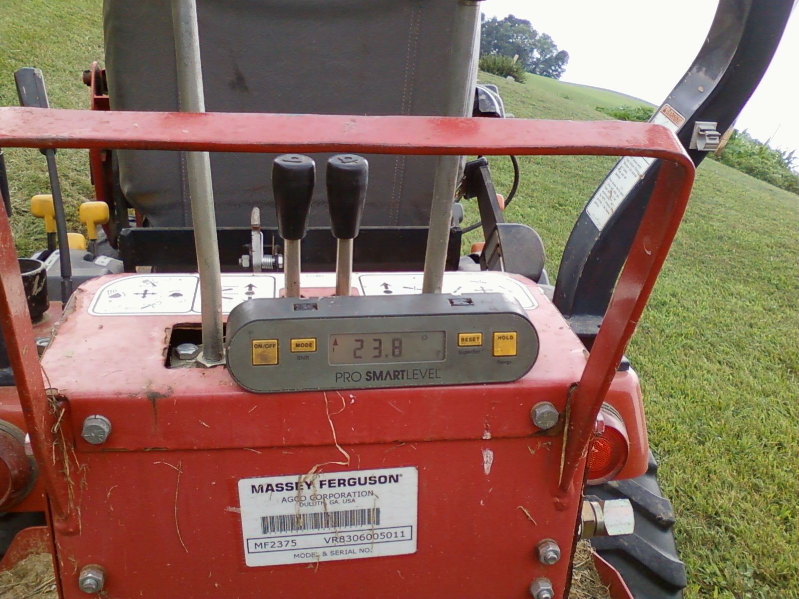

When I was mowing today and had my inclinometer with me, I took some pictures where I take mine without swinging the BH for counterbalance. It helps having weight on the rear axle for stability.
Doug

/ GC2300 - How Stable? #7
tx2310-- OK, where'd ya get it? Interesting device; I've often wondered what my personal "pucker factor" limit is....
/ GC2300 - How Stable? #8
Lol, he said "pucker factor" :)
/ GC2300 - How Stable? #10
I have had it for years. I believe I got it from Home Depot it comes as a 24" level and you can remove the torpedo. Now you can get a app. for your smart phone to do the same thing.
