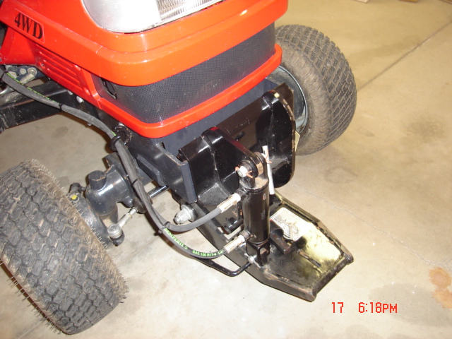

Gave the mower to a freind that needed one. When it comes time - will be asking how to attach front quick hitch to tractor. Thanks.
That's the easy part actually. Just hang it on the front part of the frame and tighten the "T" bolt.

I guess i'll have to remove the FEL and grille guard first ....... ?
/ GC2300 Snow-blower #24
Piece o' cake-- four bolts to remove grille guard. As Don said, quick-hitch just hangs on the frame there. The "T" bolt pulls a slab of steel up against the back/underside of the frame to secure it.

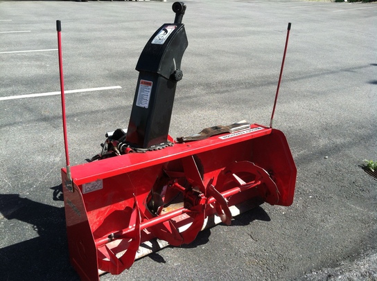

Got the blower and a used Honda 4213 riding mower (didn't run) for $ 1500.00. Honda mower had a broken wire to fuse box - fixed that Runs and mows great. The same JD dealer had a Kubota BX2750C blower also ...... identical to the MF 2360 except orange.
Hi guys. Newbie here from Eastern Canada. Being that both MF2360 and the BX2750 are identical and both built by Radtech in Quebec, I'm wondering if a BX2650 blower would fit my GC? Aynybody have any idea?
A guy has one listed on another site here in NB and is looking to trade for a rear blower, in which i have. My 50" Meteor rear blower works awesome but my neck bothers me after a while, having to look over my shoulder.
I had a front mount on my JD X300 before the Massey and much prefer the front mount
Ay suggestion guys?

HubGC-- The blowers themselves are identical, but the way they attach to their respective Kubota & M-F tractors are quite different.
Other folks have talked about that on this forum (you might try a search), but as I recall, there are big enough differences in the quick-hitch parts (see pics in my post above) that it would be difficult to accomplish. irvingj

Yah , thats kind of what i thought. I wish i could see both of them in front of my own eyes to have a close look. Thanks for your help

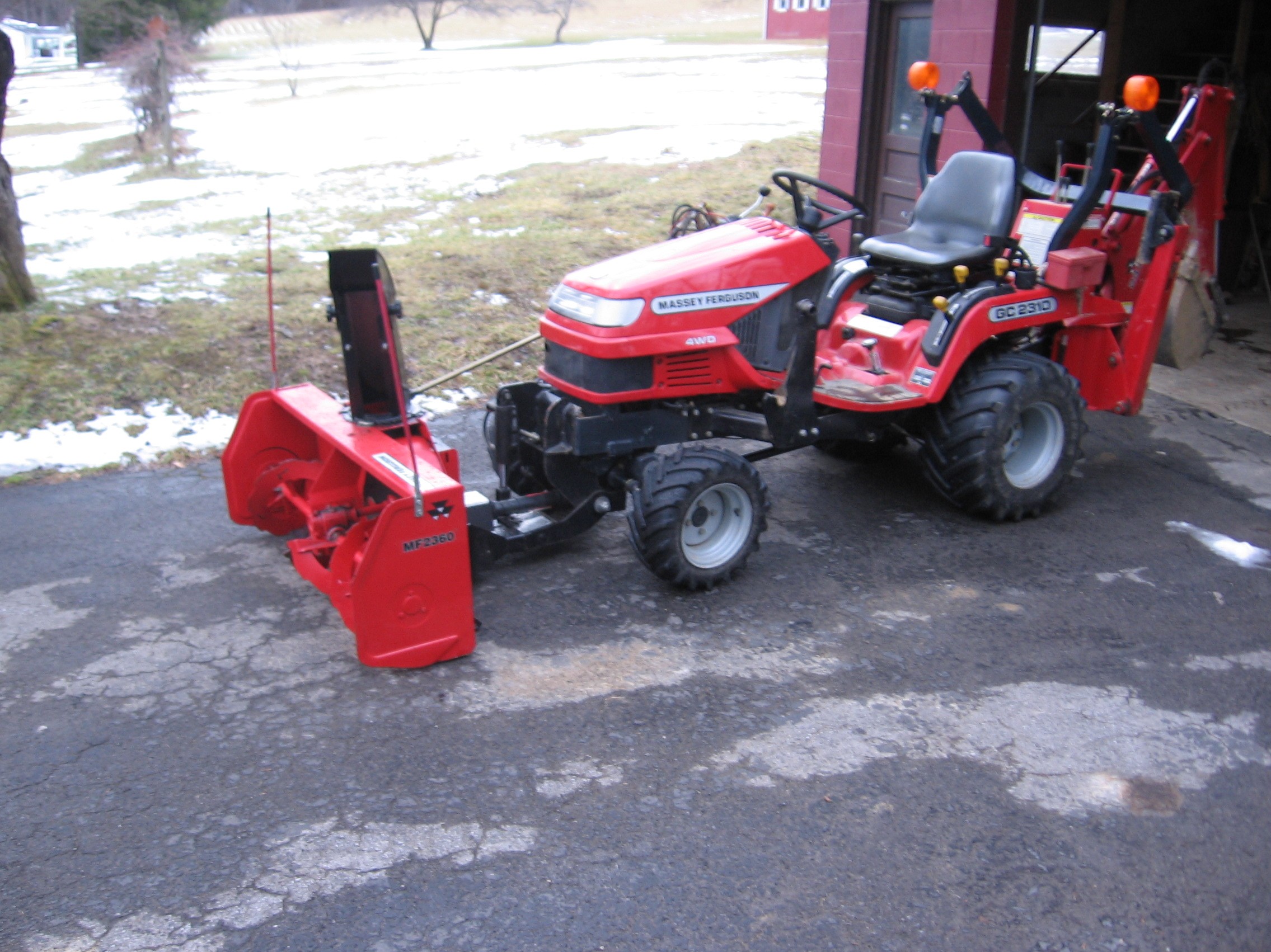

#29
Got it ready to blow some snow ...... thanks for all the advice.
