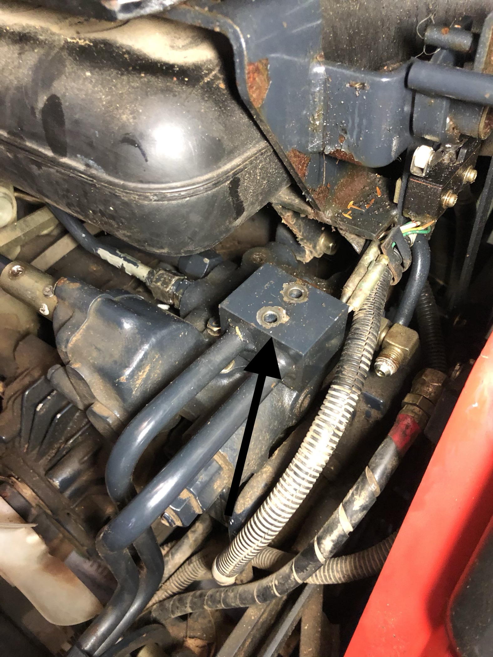

Thanks so much for your reply. Your pictures are great. I just got started a bit ago dismantling to get down to the pump. I致e been taking short videos as I progress to help some other poor sole, I will post them on YouTube when I知 done. And yes it痴 is a big job just removing parts to remove the pump.
I致e added a couple pictures just to see if I知 on the right track. I am removing the main control valve off the top of the pump first as I can稚 see any other way but to remove the connections off the top and bottom of the pump first so I can get at the 4 bolts holding on the pump. Just wondering if you found an easier way.
There isn稚 much room to work and the pipe connections on the side of the valve are hard to get at. And the darn roll pin seems to be really stuck. See picture with arrows. I removed the connection on top of the valve that feed the front bucket etc.
My hoe is still on too my I haven稚 taken it off yet. Could me fun.
Any suggestions would be greatly appreciated.
Thanks
Peter. View attachment 673218View attachment 673217

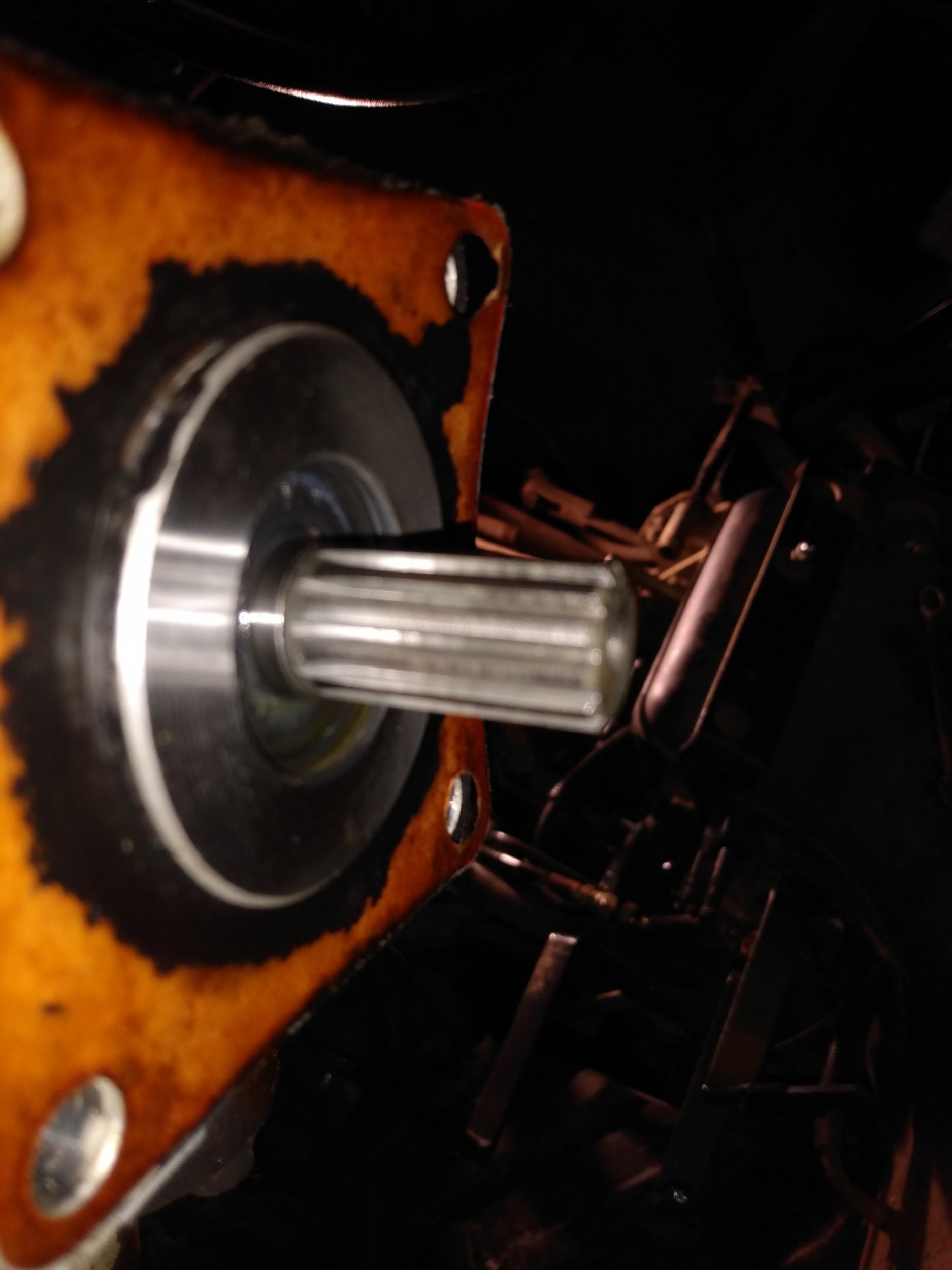

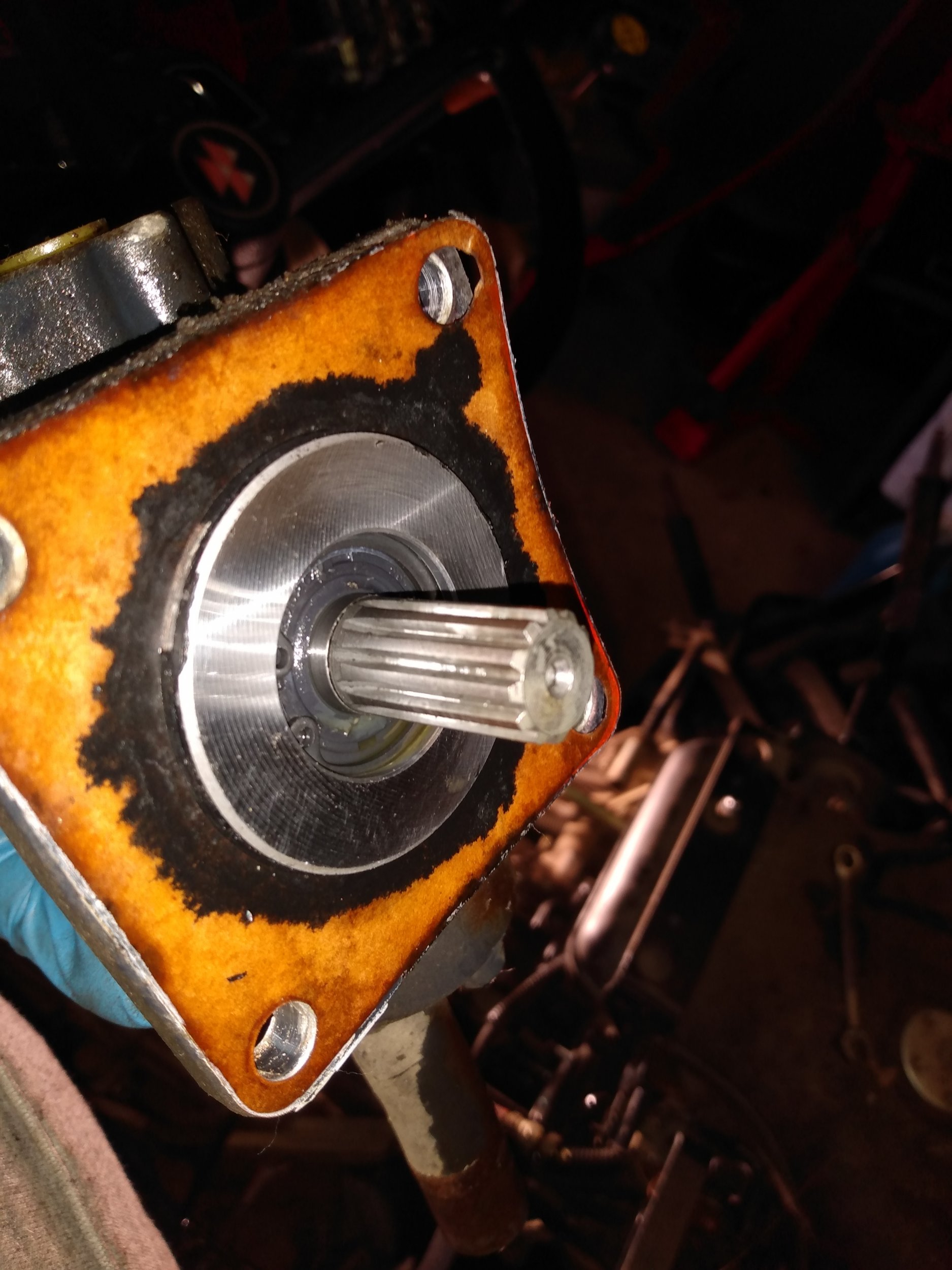

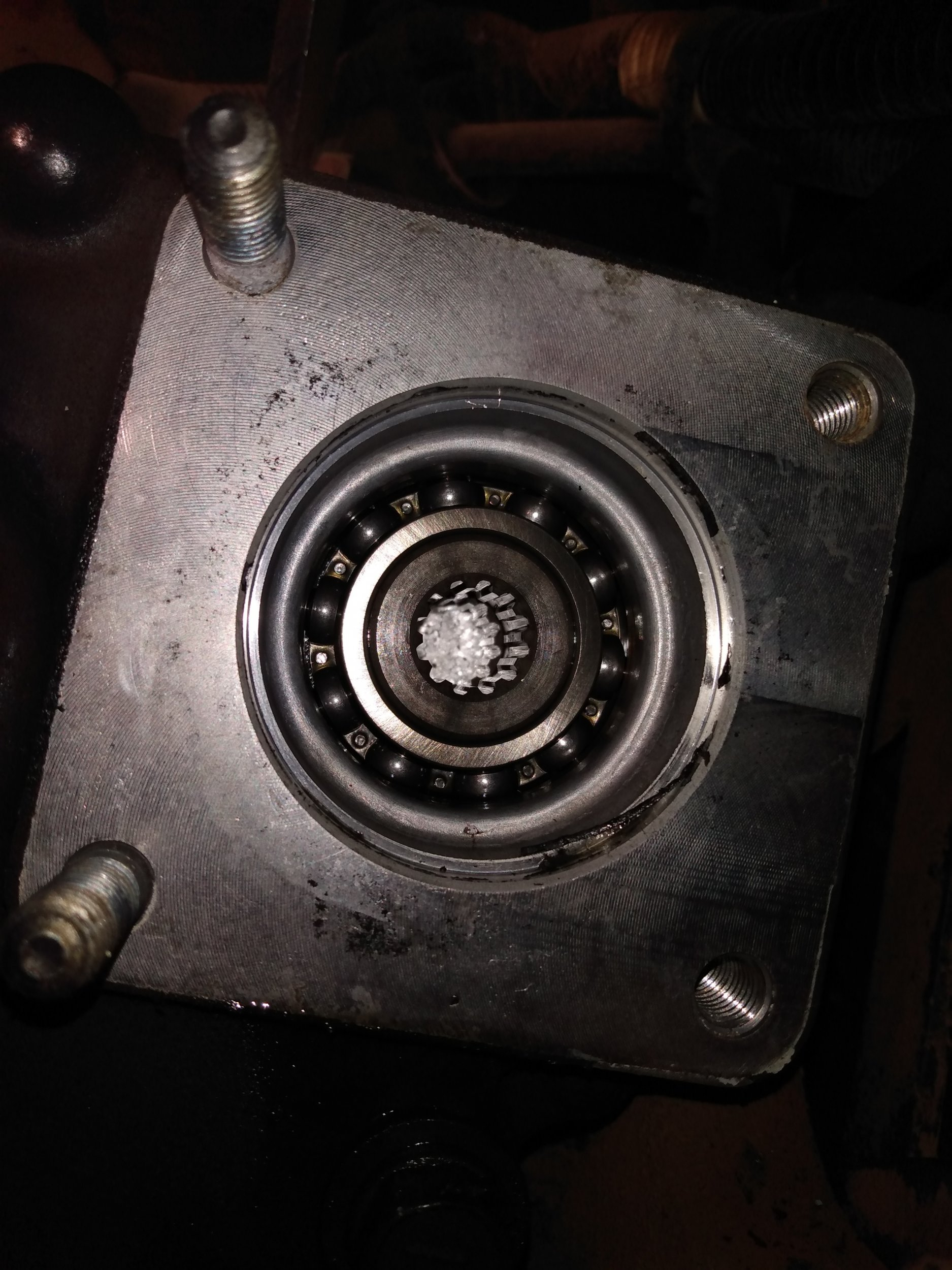

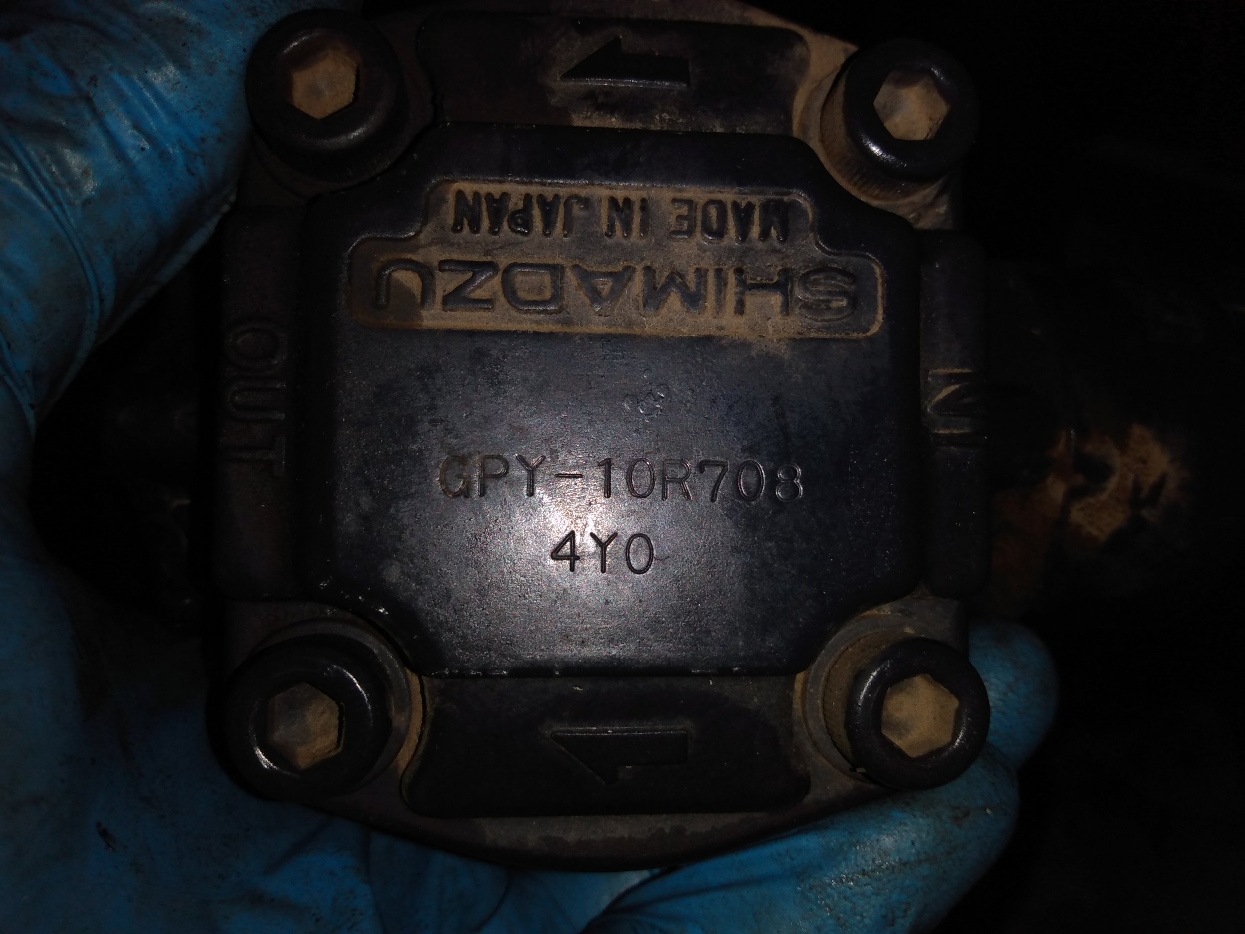

05 GC2310 here. I got nervous and wanted to check my pump gear. Now I only have just under 300 hrs on my tractor but this is what I found... Not much. The end of the pump shaft is definitely worn more than the rest of the shaft and the trans internals look good. I'm thinking I may just put everything back together. Pump is the GPY-10R708, S/N JPA203XX
