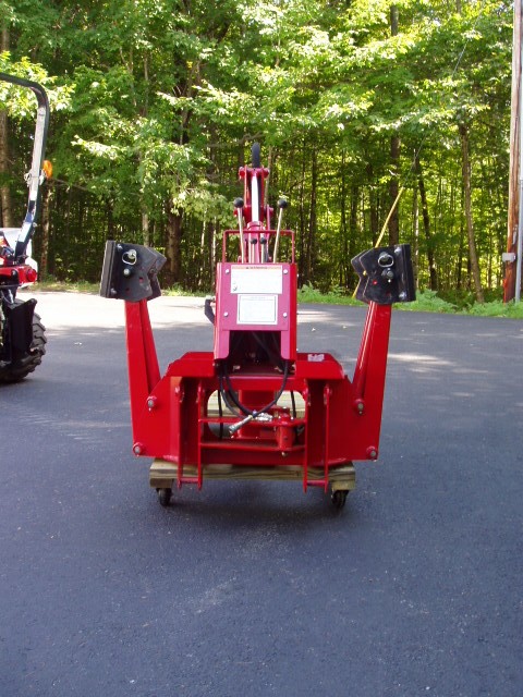

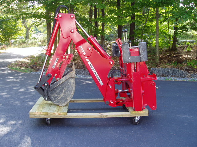

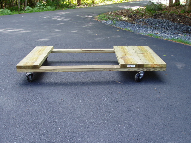

Unless you are seriously cramped for space, I would be very nervous about trying to take off the BH with a jack.
I also have a storage issue, so I made a dolley out of pressure treated wood. It fits nicely under the BH frame; and I use the stablizer arms to lift it off the tractor. Then once in position, I lift the arms and use a bungy cord to keep them in place.
It worked great. I rolled it into a storage room in the garage last November when I put on the snow blower, and then rolled it out in April when it was time to switch implements (during the summer, the snow blower rests on the same dolley).
Jay

The bxpanded one is very nice, but I needed something that would be a bit more tolerant about the bucket placement (not sure I've ever done it exactly the same way twice) and be able to accommodate both the BH and the snow blower. The sides on mine are pressure treated 2 x 4, and the ends are 2 x 10. I got the wheels at Harbor Freight, but they have the same thing at TSC (which just opened a nearby store a couple of months ago).
My total cost was ~ $40. and my wife was (temporarily) impressed with my creative abiliites. The only downside was that since I already had all the tools necessary to make the dolley, I could not turn this project into a "new tool" opportunity. :rolleyes:
Jay

Excellent idea with the dolley!! :) How big are the casters??
   / GC2410 Backhoe removal with jack? #8
I got the idea after reading about others on TBN who had done the same thing. For the BH/snow blower dolley I used 5" swivel casters. I also made a slightly smaller version for the 3PH wood chipper and used 4" swivel casters for that one.
Jay

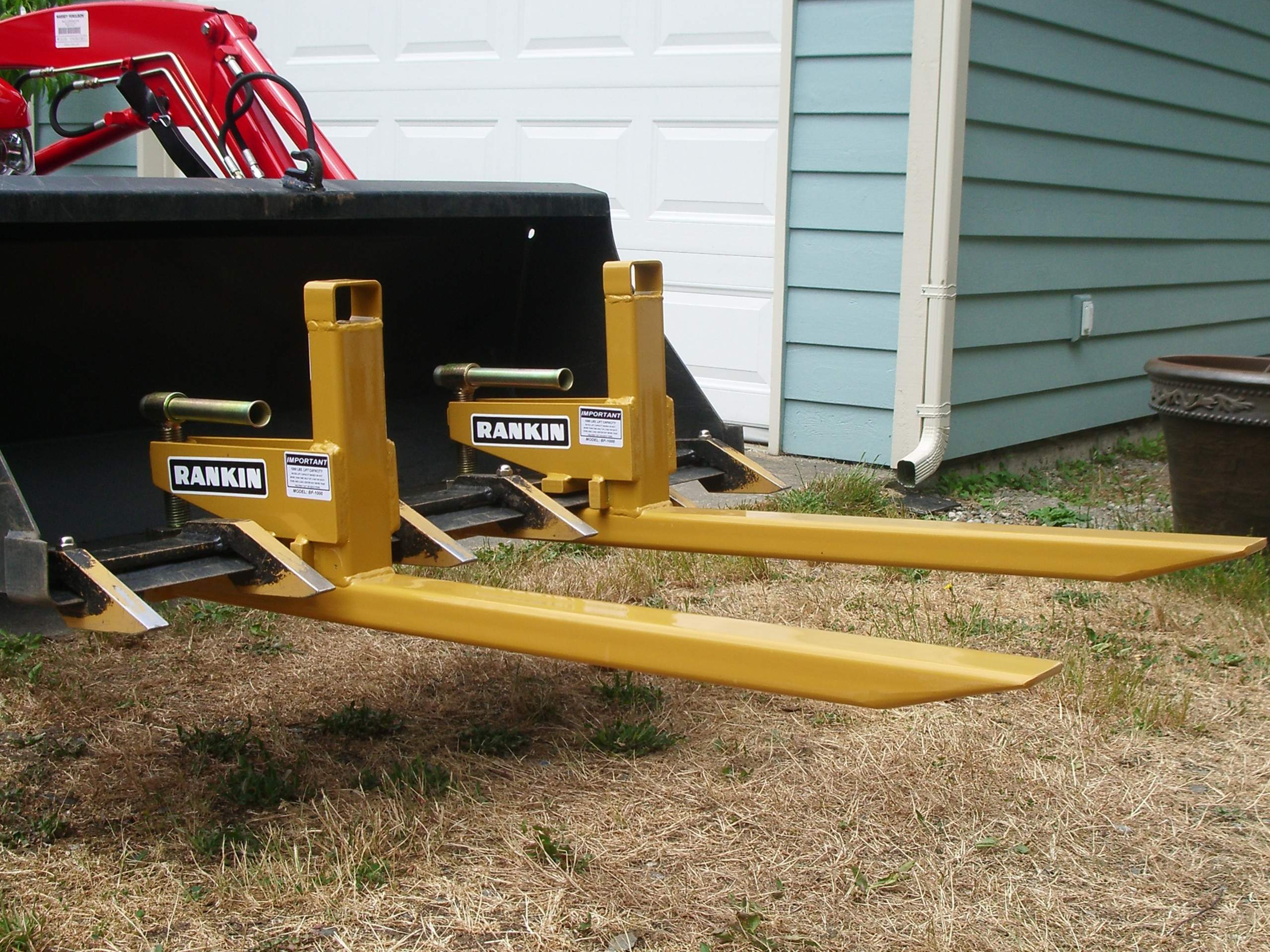

Hey Jay, what are your measurements for the one you built for the back hoe. LxWxH . Also the sizes of lumber. The one in the pics look like 1X6 and 1x4, but my eyes or can be bad......Any other members have pics of ones they built. Sort of leaning towards bxpanded, have a garage with cement floors. I also have plans to build a shed with shelf with racks or shelfs that i can back intor and or remove my attachments. I bought some forks for the bucket and thought about putting some attachments on pallets to store...... They are made by rankin. ray
