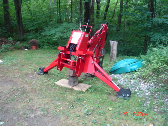

Completely different solution, perhaps, but, since I keep he BH mounted on the tractor in the winter (with front blower), I simply "park" the backhoe off to the side of my driveway area when mowing.
I put a couple large blocks of wood under it to keep it up high enough (outriggers slowly settle) so I can just back right up to it to re-attach it.
This may be temporary, but works with a minimum of fuss!:D
Aafter sitting a few days it still settles some --still have some finer points to work out-- so I just hook up the lines & re-level with the hydraulics.
