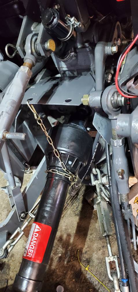

I thought the hoses for the BH were power beyond?
Anyway..I spoke to my dad yesterday and he reminded me that at least I have a warm garage to fix this in:)
Yeah Im nervous about removing that safety plate but it is the main reason for destroying these hoses. Its impossible to manage them around it.
even w/o a backhoe (eg a xx00 series) that stupid plate is a PITA.
on 2400 its not hinged.
so hooking up pto shafts SUCKS.
yanked mine off w/i week of getting tiller in 2021.

So I think im good now. Going to try one more time with that stupid safety plate.

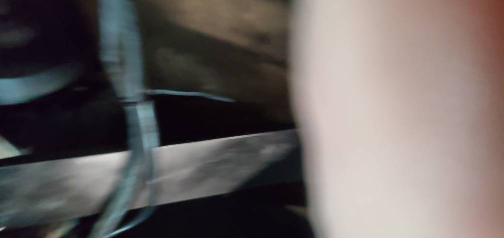

was that bend in hose (first pic) right where the return goes back into hydro unit? looks familiar but hard to tell. if so stuff I dealt with was leak on the thread end there.
edit: nope I see the red tie wrap, not the return hose thats pressure (iirc for outriggers) hose and not the blue (pressure)-blue/yellow (return) stuff.

The dealer messed up when color coding them and I was to lazy to fix it lol. One has yellow and red because the yellow ones connect to each other when the BH is off and the red one is when its off or visa versa lol.

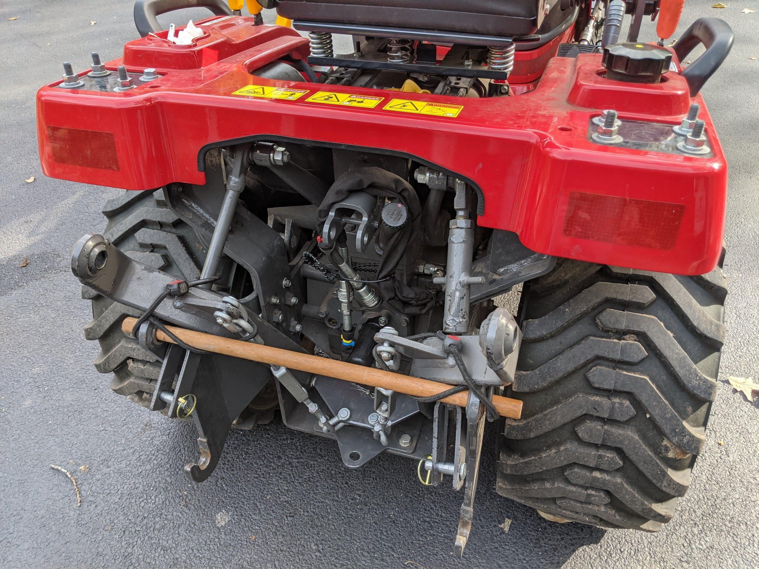

The unfortunate side effect of owning a compact tractor is, there isn't any room for anything. ☹️

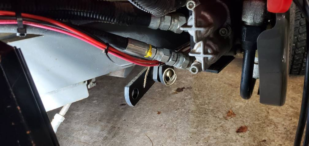

Got everything ironed out and hydro lines managed better. Later I will work on having some spares made up just in case.
Lost almost two gallons of hydro fluid which had me worried I hurt the pump.
Last snow storm with heavy wet stuff had me trial by fire the fixes and pump condition and I am happy to say its running like new again.

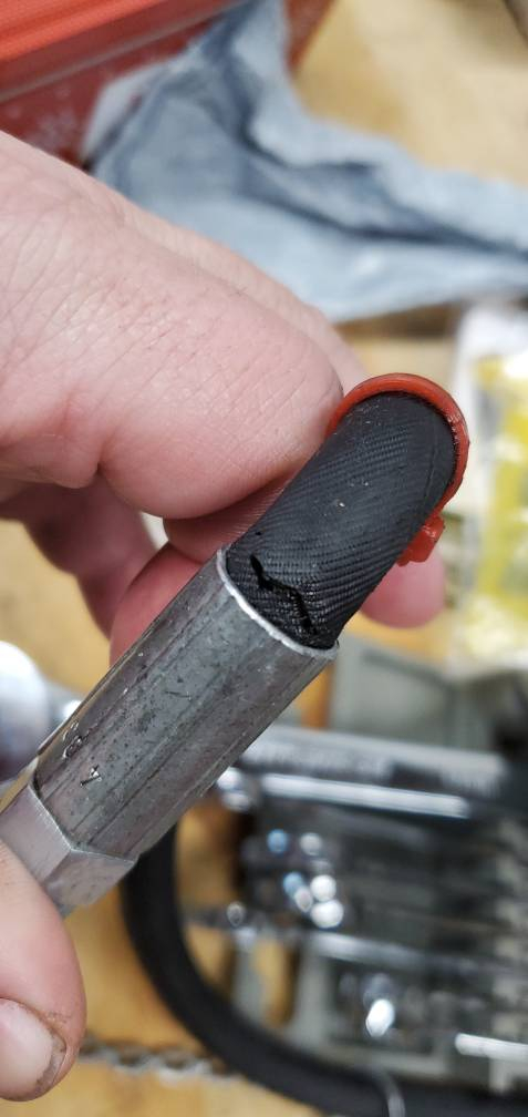

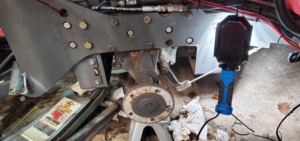

I am so frustrated with this setup on the power beyond hoses. Finally replaces the hose I thought was busted...added 1.5 gallons of hydraulic fluid (thats what I lost) and tested it.
Pump seems to be ok.
Well..apparently the 36 inch hose wasnt the only one leaking. A 24 inch hose is also leaking. Will have to take the rear wheel off tomorrow so I can remove it and get another one made up. Im done with the Massey dealership..they cant follow directions so i will get it made by the Deer dealership 2 miles from me instead of traveling 50.
Somebody...anybody have a bullet proof way to manage these hoses so the 3 point wont pinch, pull or cut them? Even the PTO safety bracked is poorly designed because it cuts the hoses on its edges.
Pictures of your ideas will be much appreciated.
I want a perm. fix because this leak almost killed my pump.
I so hear ya on that, I hate how janky all that back there is with the hoses and stuff! So for me, I don't use any rear PTO implements, so I just took off that PTO guard, and have that plastic sleeve permanently mounted on the PTO shaft. As for the hoses, here's how I route mine:
