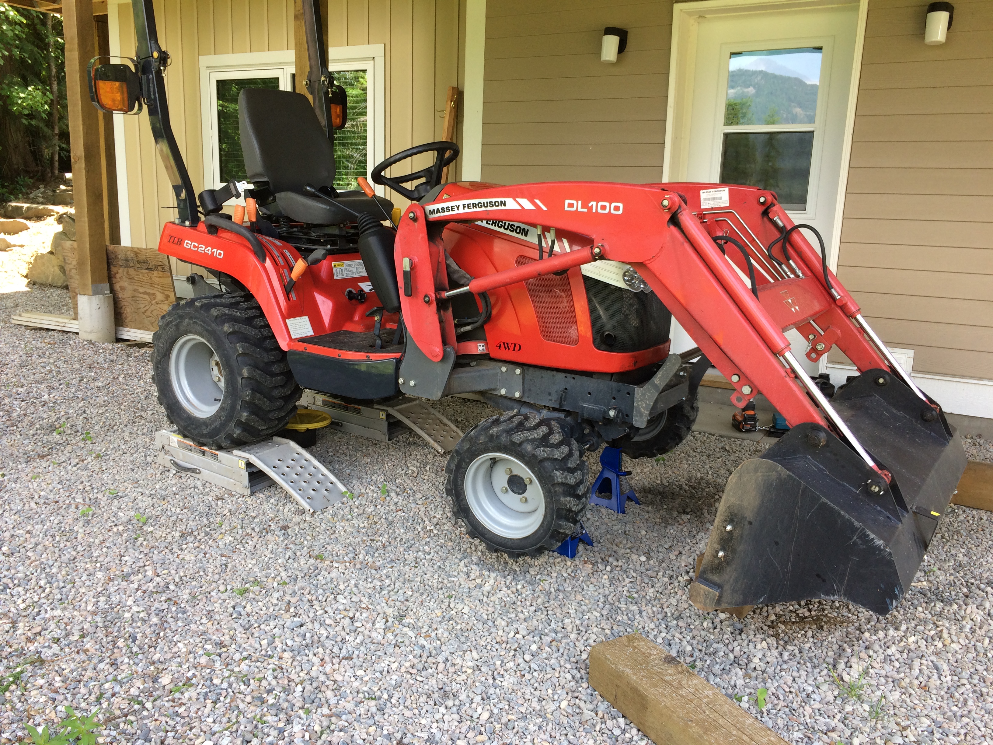

First thing I noticed when looking at the drains for the hydro and front axel, is that they are all LOW to the ground. Too low for my oil-catch containers anyway, so I had to look at getting the machine in the air. With some car ramps, the FEL hydraulics and a couple of jack-stands I gained 6"+/- and commenced the freshening operation. Pic here of the elevated patient.

From the pic, once you lower the FEL and bucket, it should raise the fluid level so it can be seen in the sight glass. If not, start it up and take a look while it's running. Don't over fill, as you have just changed the oil to the spec. capacity.

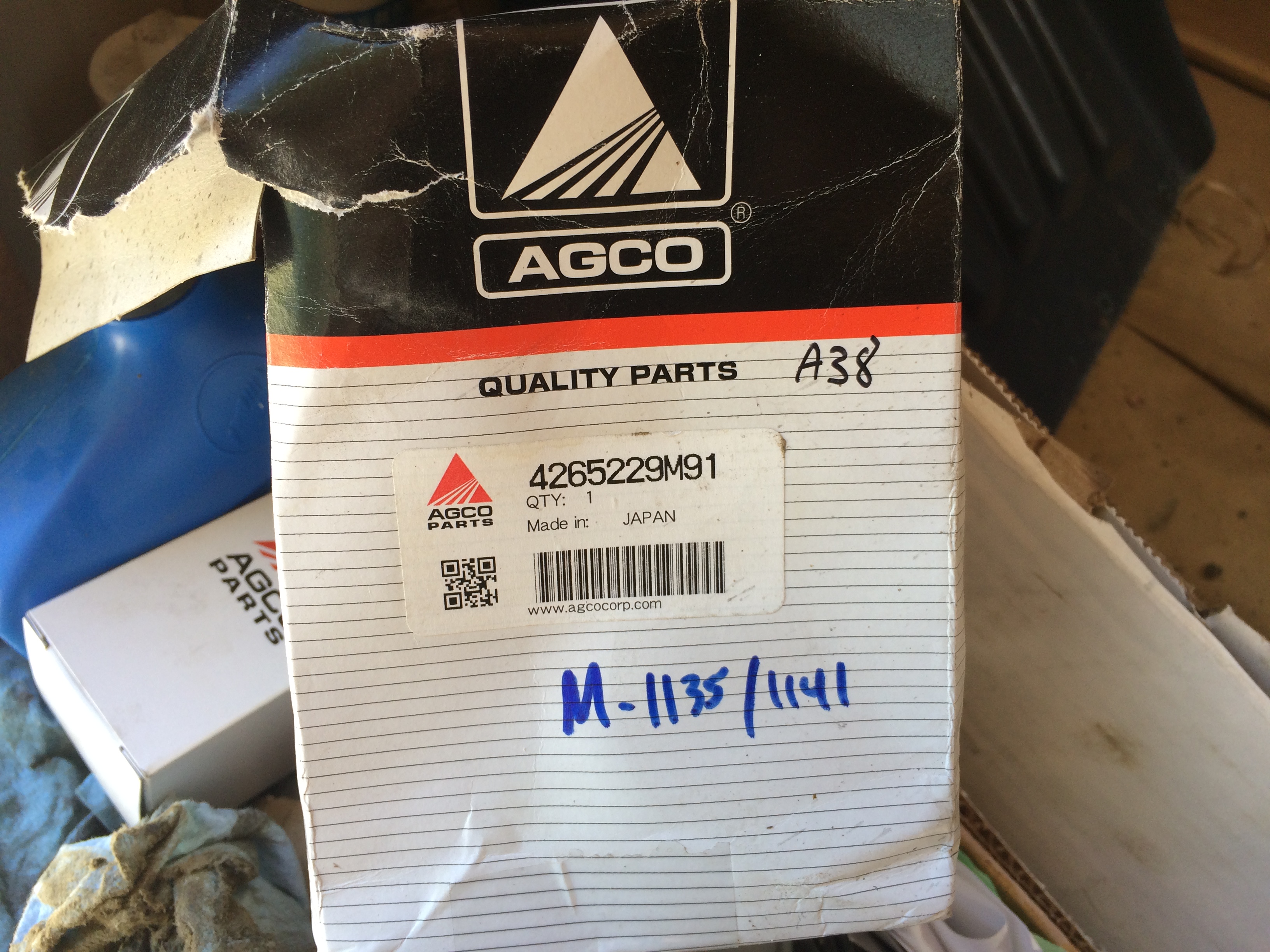

Hmm.. The replacement filter and the one that was on it are a very dark green, so perhaps at least the 50 hour was done at the dealer..?
With the oil, I know the manual's specified quantity has been added. I wondered if a new filter is taken into account on that capacity?
I know of no such approved filter.
Only the OEM and a NAPA filter, (the NAPA filter just came out), are known approved filters for this application. Both were using white, the last time I bought from them.
The fluid capacity is never exact, because of the loader and residual fluid in the hoses and cylinders. you have to go by the sight glass, not the book.
If you can't verify you have a MF filter, I suggest you order one, and change it. If you are having issues It could be the problem.

Yeah, the filter came from an Agco dealer, dealer invoice for it, and came in this box. The part number says it's the OEM part in an online search.
It should be fine. I would like to gather more opinions though: Which to follow/believe for the proper hydro fluid level: the window or the listed capacity?
