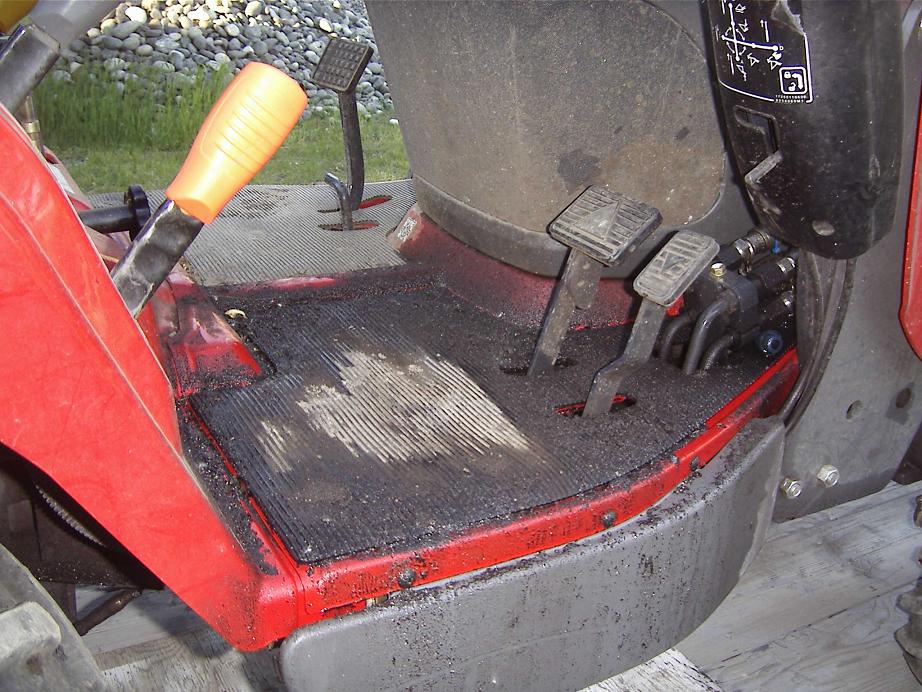

The dealer I bought the machine off 'repaired' a nasty hydraulic leak (19.6hrs) by pressure washing the machine, and the decals off one side of the loader, it has not seen a pressure washer since. I do hose it off fairly regularly as a heavy layer of dust makes the paint look faded, and frankly, I prefer it to be shiny.
btw, name of the dealer was Selmac Sales in Stony Plain Alberta. They knew that I was taking the machine 550 miles home directly after they made the repairs so another 20 machine hours after I got it home I had to take it to another dealer 55 miles away to have the same leak 'repaired' again... but that's another story...
