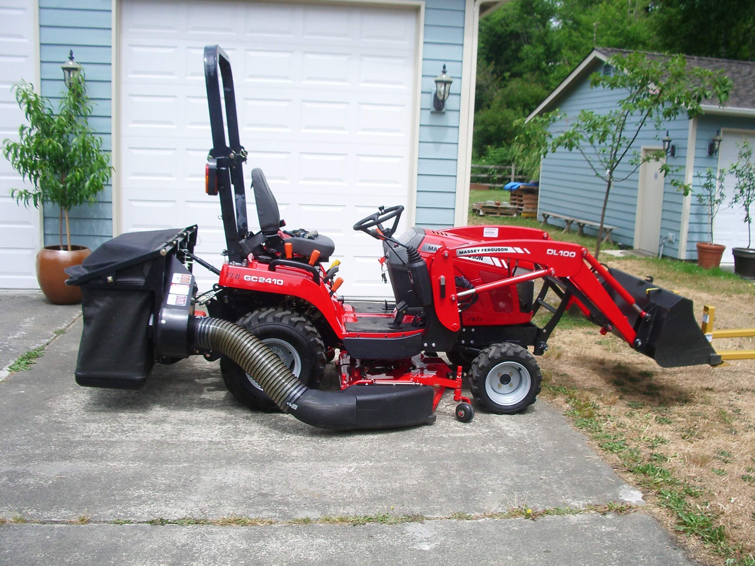

I'd like to see pics of the bagger on a GC:cool: Are they very expensive?
   / Gc2410tlb mmm raise and lower
#12

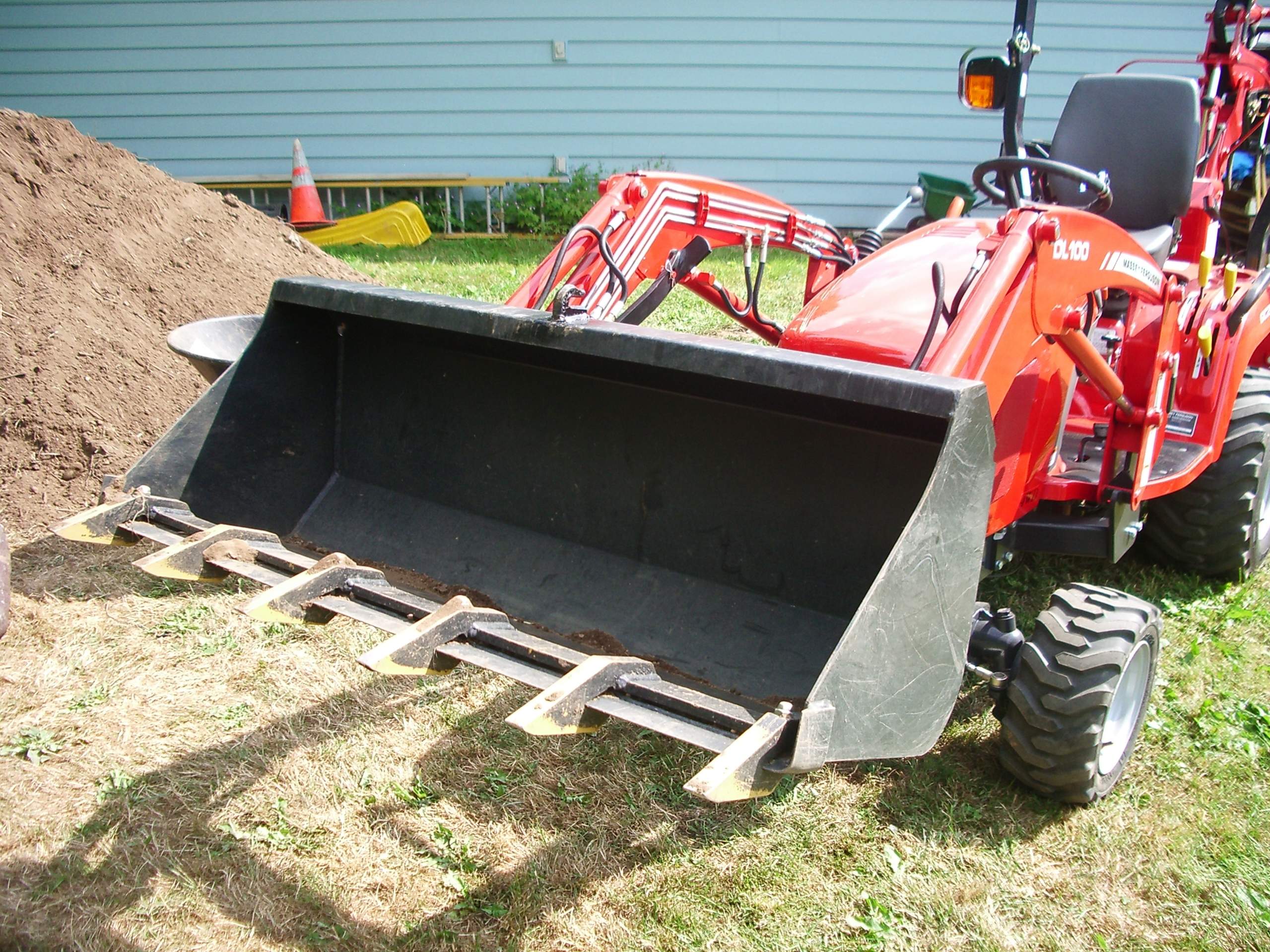

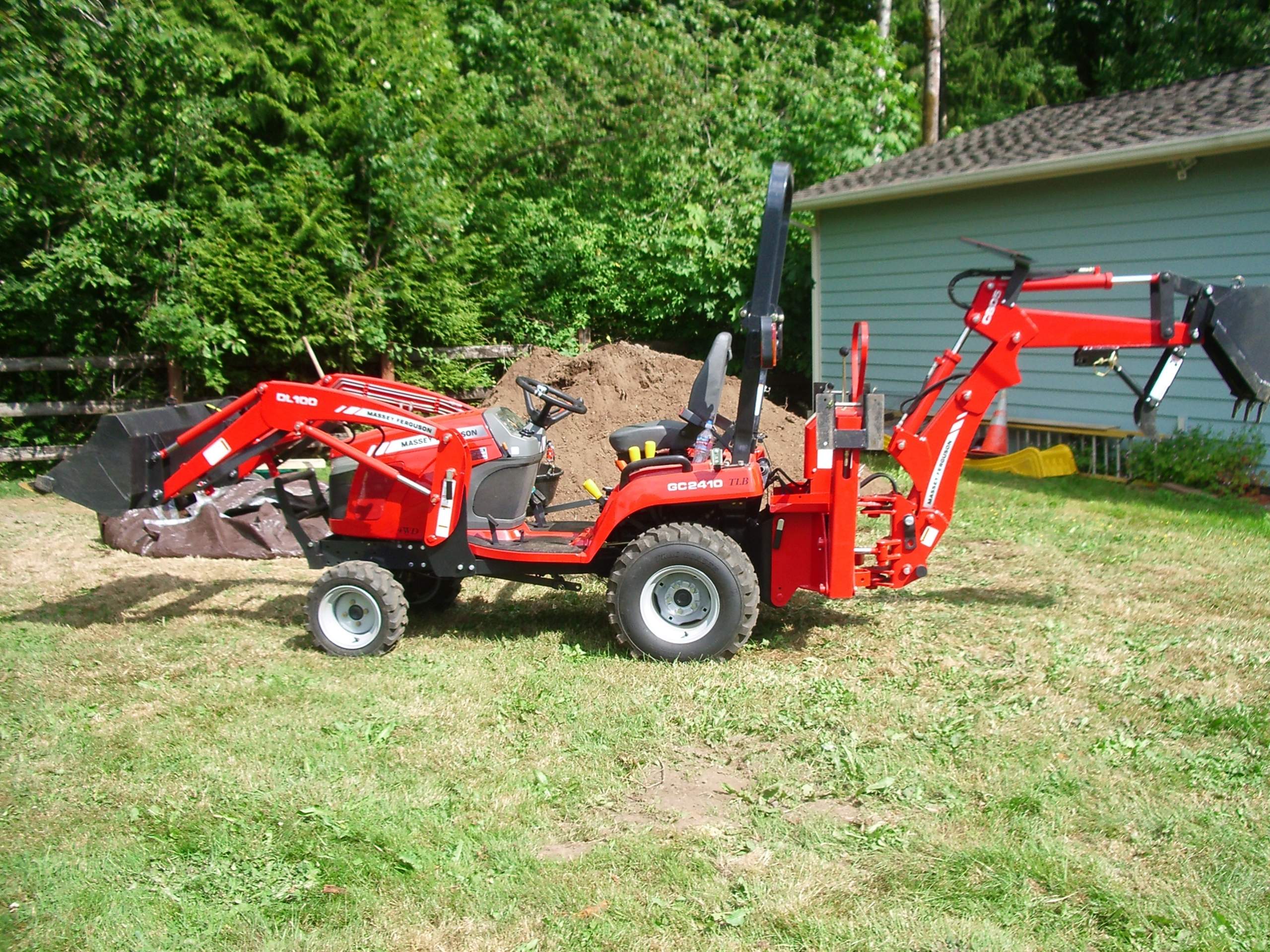

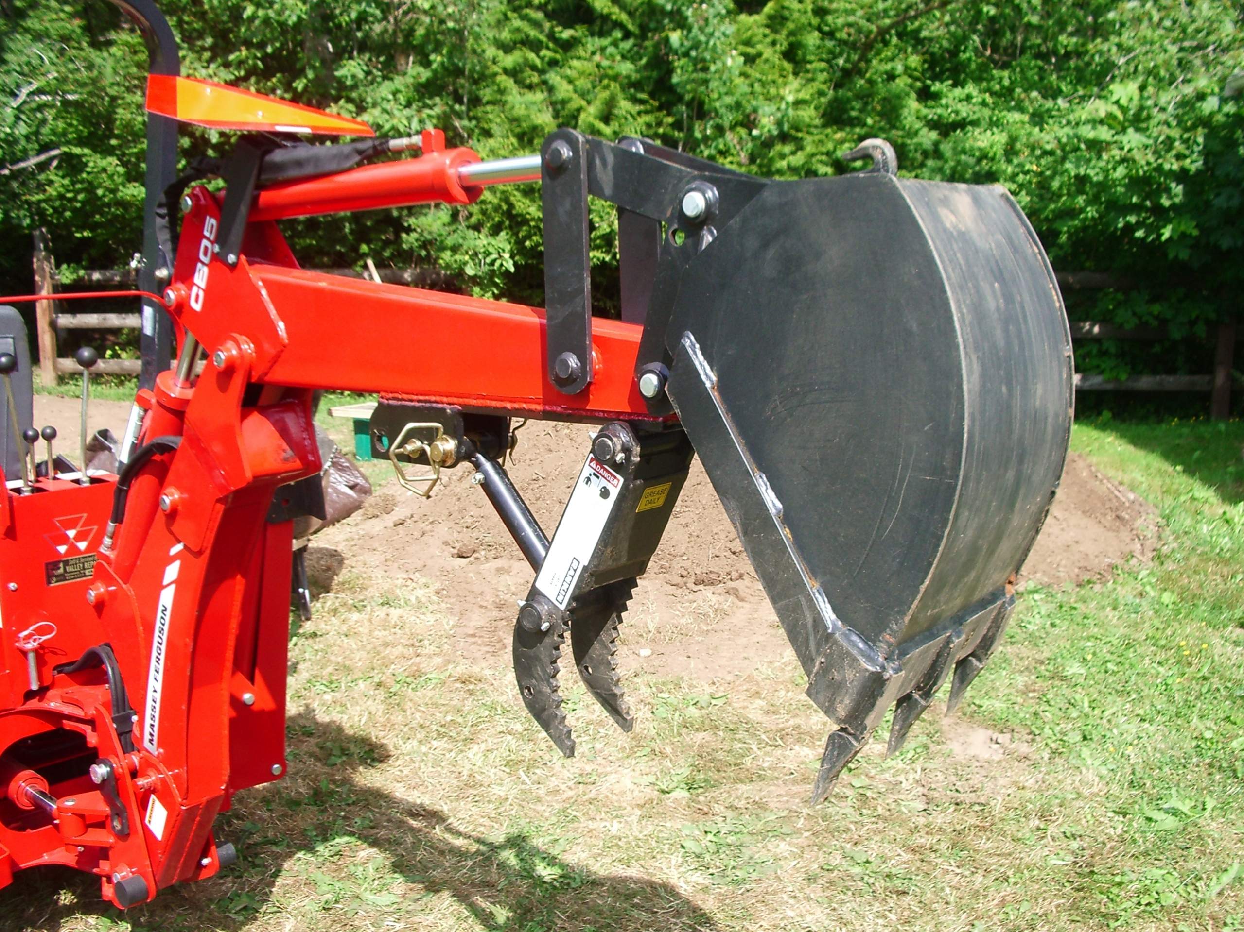

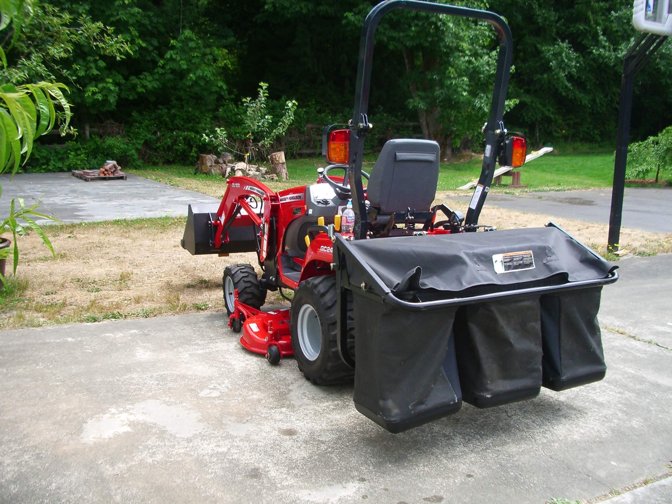

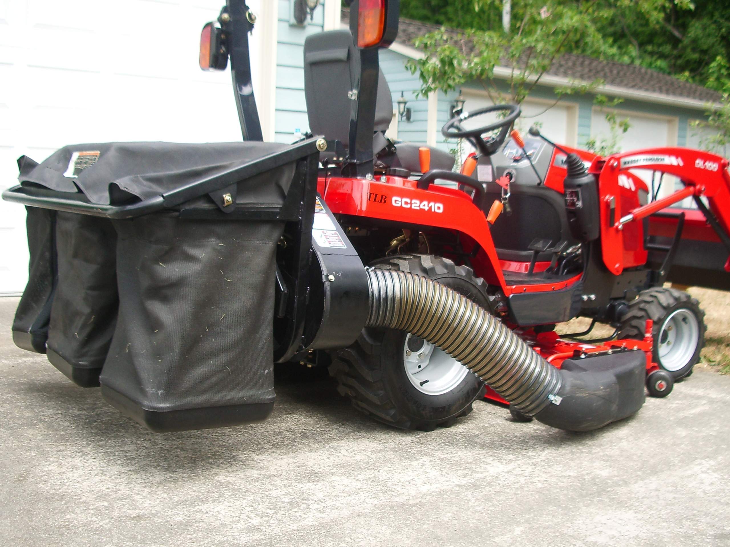

here are some pics of bagger, and rankin toothbar and thumb welden on.. Yes the bagger by humbolt not cheap about $2100. Does a nice job but in the process of having a problem worked out. The one for the gc2410 come with a adapter bracket that bolts on with U bolts and this is where you attach the 3 point pins. The bags rub on the brackets causing the bags to tear after one or 2 uses. If you switch the brackets around the way they should be, the pto shaft is about 3 " to short. So in the process of having a new shaft made . Dealer is helping me out..Wonder if massey knows about this problem as they deal with humbolt for there bag system. Have replacement bags but still using old until problem fixed. Ray

Sweet machine rayban1. thanks for the pics. How is the Humbolt for plugging? i've read of the John deere guys saying the mcs for them is a pain as far as plugging and trying to clean it out. Some have said the design like the Humbolt is easier to unplug?
#14
The side discharge shoot rotates up, so you can clean it out when grass gets stuck, plus the hose snaps off also. Pretty easy to clean. Will keep you informed about the problem with the bags rubbing against adapter plate. Talked to dealer yesterday and they said they are having a longer pto shaft made by humboldt. Other then that nice system.....Rayban1
