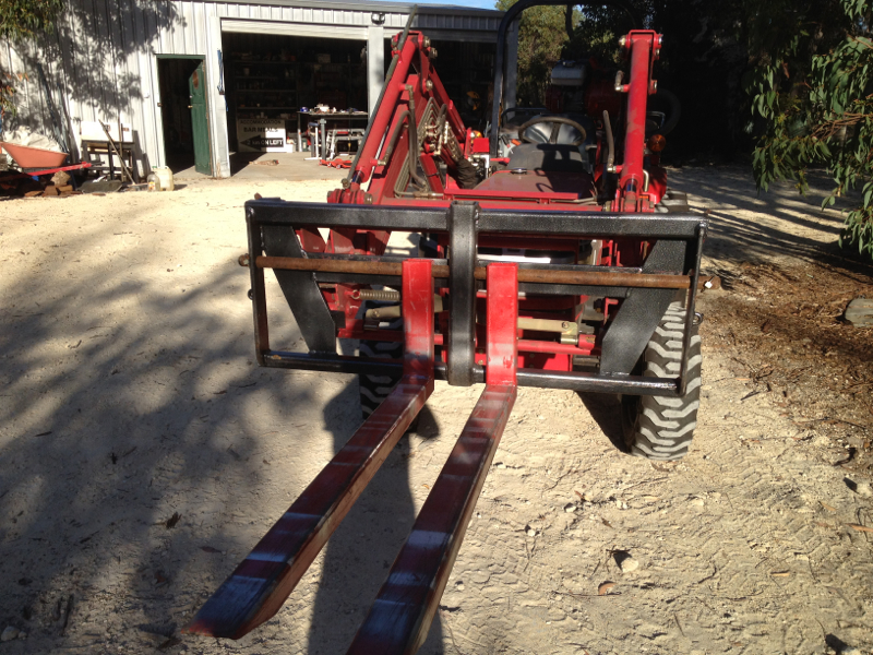

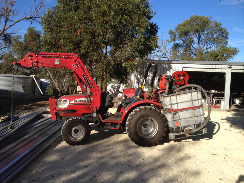

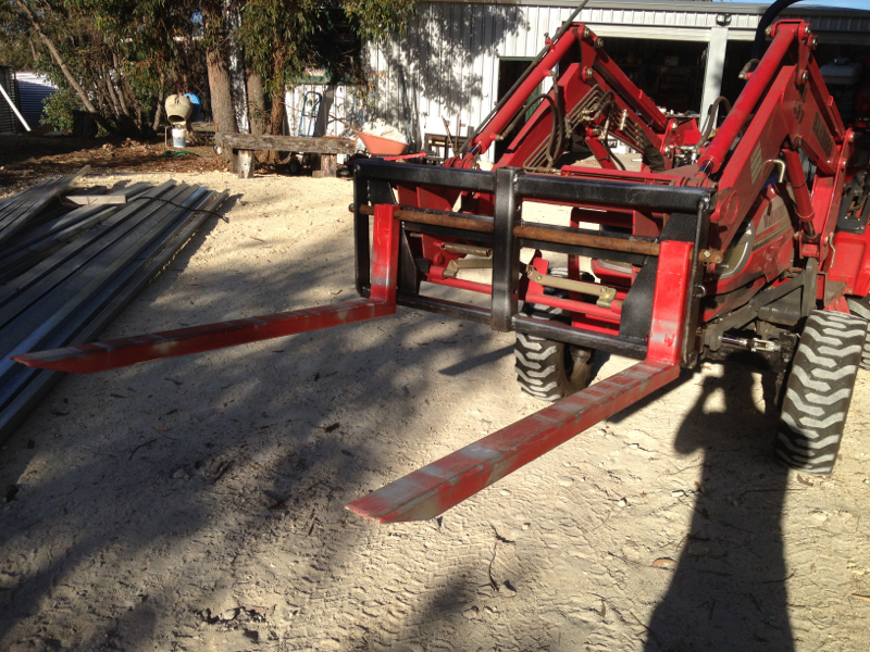

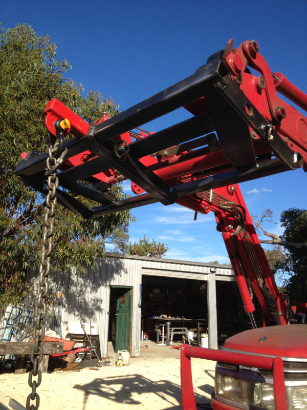

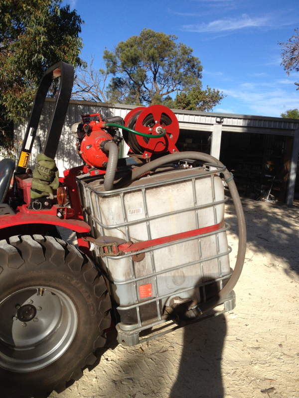

   / G'day! New fella with a 3215 hydraulic question
OK Ozykioti finally got around to pics!
Basically I just knocked up some 3PL forks with 50mm hitch atop, so that the pump and reel can be removed for other duties, servicing, etc.
The pump and reel base are alternating sizes for neatness. It's a small tractor but I can lift 700 litres of water, to save the hydraulic pump I lock it with the 3pl lowering speed valve.
I've also attached some pics of my fork come crane attachment. I will be making up a longer jib to install some patio roof trusses later in the year
