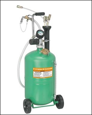

I bought one of these from Harbor Freight Tools few years ago and it works great even on very cold 90W gear oil.
It's called 6.25 gallon Oil Extractor & utilizes compressed air to create a strong vacuum.
Many cheaper options, but usually you get what you pay for.
PS.
I use it also when doing brake fluid flush in car & truck, works great for that.
