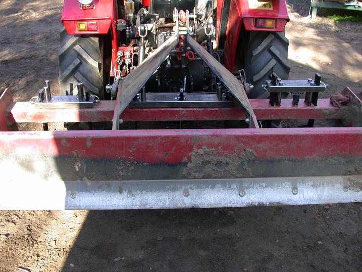

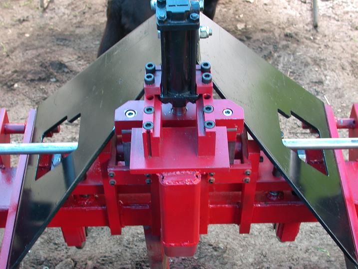

So here's a closeup that shows the back of the center bar and the support mount for the hydraulic cylinder. You can clearly see the clearance I had to cut into the boxblade brackets for the entire shaft and also when the riser bar and shanks move up. Again, the final assemble required having them on the blade while each gear set was assembled with keys. You can also see the 2 sets of bolts and clamps that hold and position the hydraulic cylinder to it's mount here.

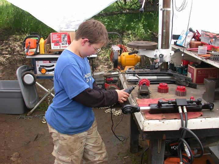

Here's a picture that shows some of the tool room at camp. It's a 10' x 20' enclosed canopy. This is my 10 ear old son Wesley helping to clean the paint off the gear teeth. So I've got all kinds of help too! I'll tell you what...having to drill large holes or sawing steel at camp is no picnic. Plus welding, assembly and whatever else is just plain hard on uneven ground, dirt mud and rain. But then...who would I get to do it for me? /forums/images/graemlins/confused.gif

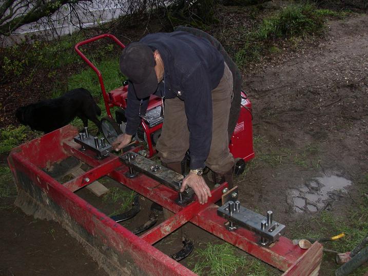

This pictures shows me trying to fit the riser bars in the rain and mud at night on my rural property. I had to pull and push them up and down hundreds of times after each time I opened the holes so they would slide freely. My back is shot now. /forums/images/graemlins/grin.gif

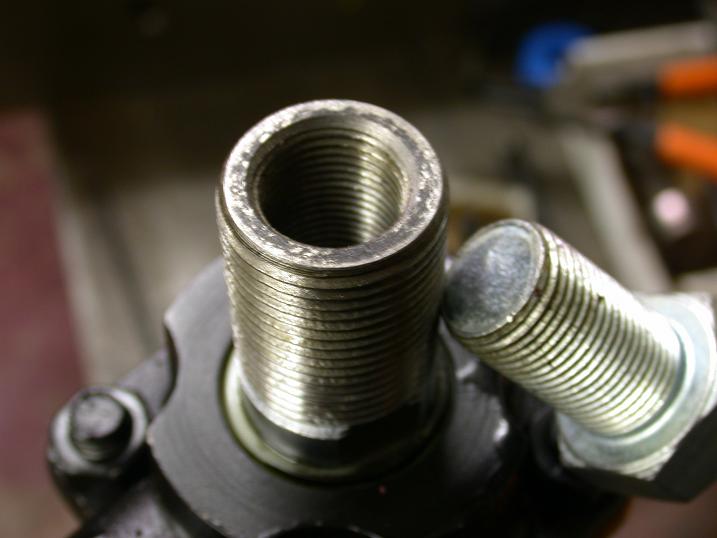

This picture shows the tapped hole in the cylinder rod and lock bolt I used to set the position of the push bar on the cylinder so I could get full travel.

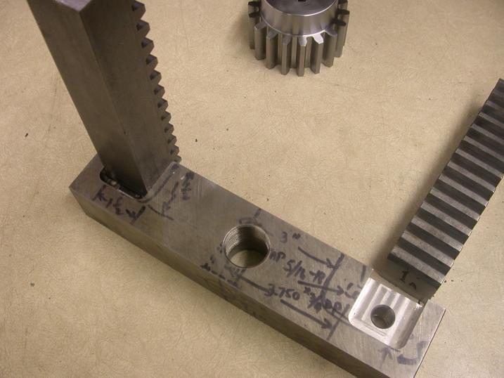

Here's a picture of the hydraulic cylinder bar that holds the racks that activate the system. I pocketed the position of the racks to match up the gear locations.
