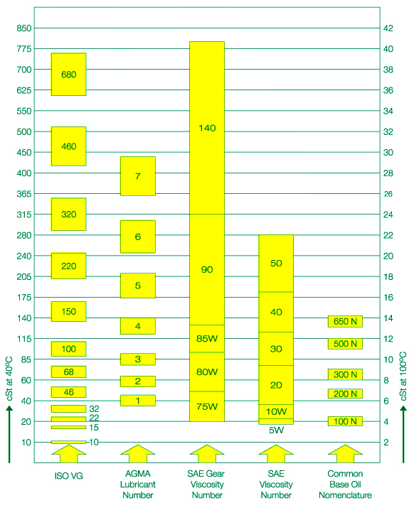

This chart shows the different oil type classifications so you can see that in general 80W gear oil is close to SAE 20 engine oil, but from there you need to consider temperature, viscosity index, dynamic viscosity and kinematic viscosity. If you get your 80W-90 gear oil up to 212F it will be more like SAE 40 or SAE 50 at that same temperature.

To illustrate how these products vary in viscosity:
Hy-gard has a viscosity of 59 cSt @ 40C. Using the chart Harry provided, (thank you), you can see from the scale on the right hand side, it's the same as 80w gear oil.
Kubota SUDT is indeed slightly thinner, 37 cSt @ 40C. putting it in the top range of 75w gear oil. But, it does thicken to perform as 80w at 100C, with 8.1 cSt.
Amsoil ATH, (what I use), is 53.7 cSt @ at 40C. and, 9.8 cSt @ 100C. Both would be 80w on the gear oil scale.
I used to have a link to the spec's for Permatran, (hard to find), but I don't anymore. For some reason MF keeps them a secret. :laughing:
So, if you have one of those ugly orange tractors, you could look for a gear oil in the higher viscosity range, and indeed have an oil in the front axle that would be slightly thicker, to help with leaks. Whether it is enough to matter is the next question. :confused3:
