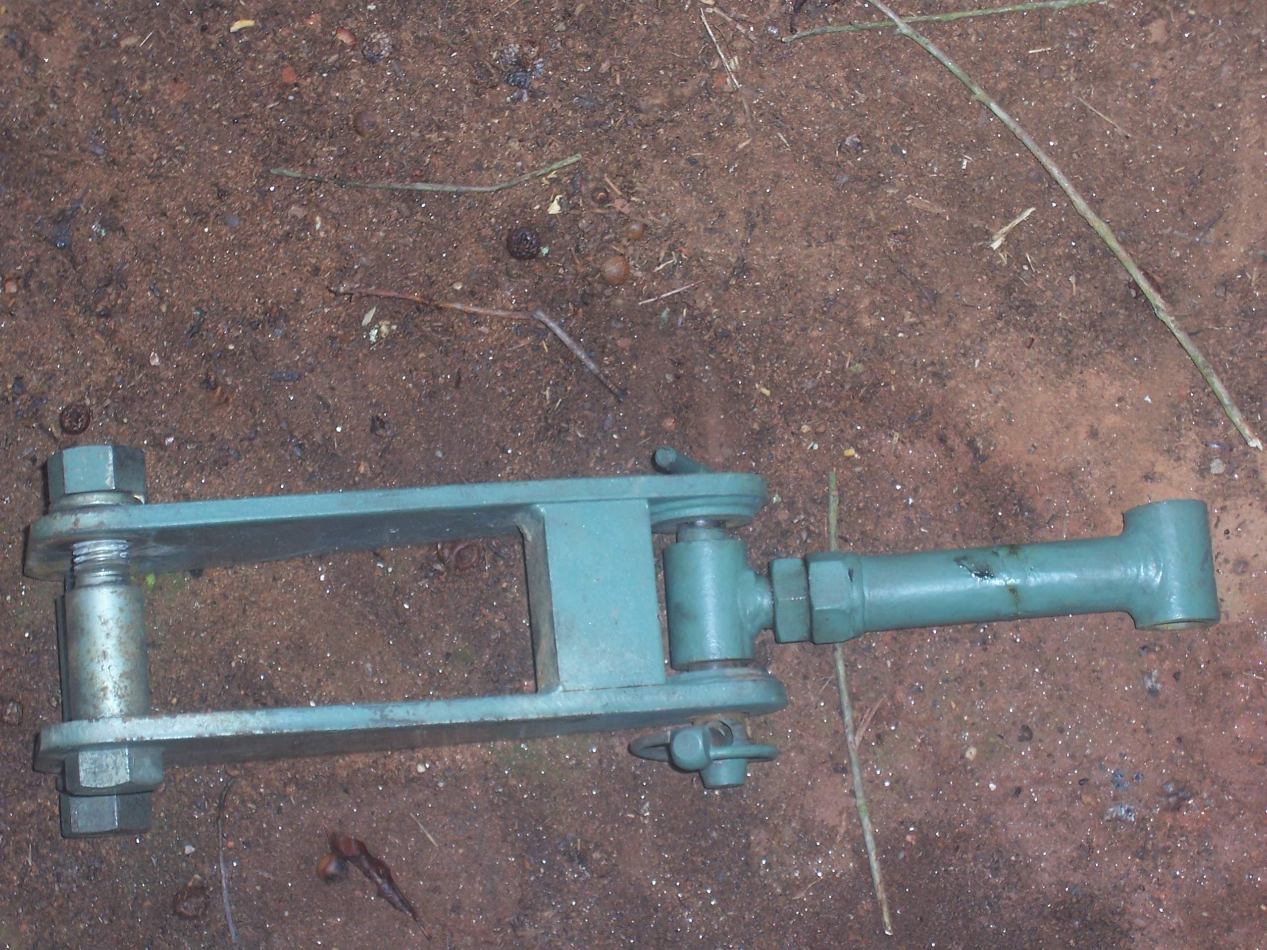

And a comment on what to look for: Some of the Yanmar 3-point tillers have a special top link. The link coming from the tiller is about half the length of an ordinary top link. This short link meets a 'bridge' pinned on the back of the tractor at the ordinary 3-point upper link attachment point.
This geometry lifts the tiller without jamming it into the tires - which is what happens if you try to use an ordinary top link.
Be sure to get the special upper link components and the original driveshaft along with any used tiller. Everything will fit together easily just like Yanmar intended. This will avoid a lot of needless and expensive complexity later.

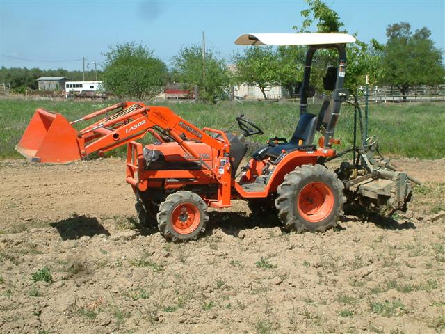

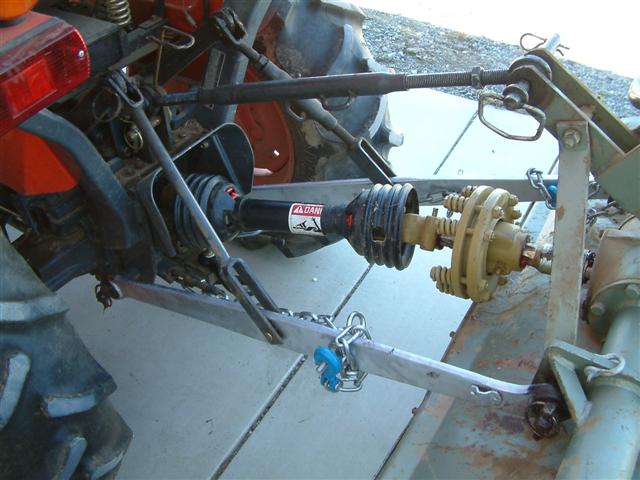

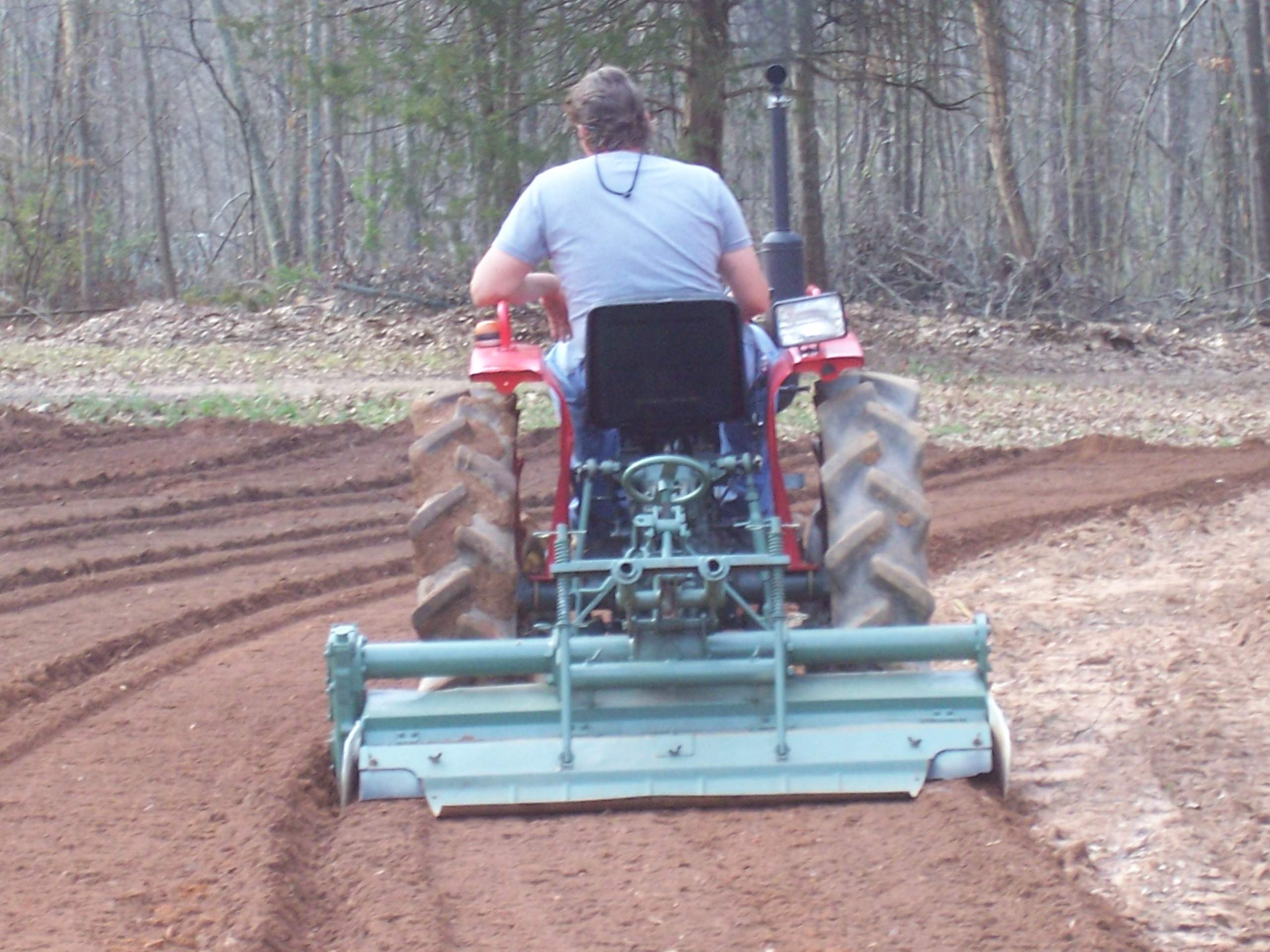

When I had my 2005 Kubota B7510HST, I bought a used 3pt Yanmar RS1200 tiller (48 inch wide, $300 at my local grey market tractor guy). Chain driven.
Only problem I had was fitting it on the 3pt hitch. I couldn't find any shear pins on the tiller, so I used a slip clutch. To fit that slip clutch to the tiller, I had to use a 6" long pto extension so the clutch wouldn't rub on the tiller's sheet metal. With those two parts in the line, the pto shaft was too long. I cut the shaft down, but still had a fit problem. So I replaced the 26" long lower arms on the Kubota with the 35" arms from my Massey Ferguson 135 to get the tiller to fit.
No problem doing the landscaping at my new house and rototilling the veg garden.

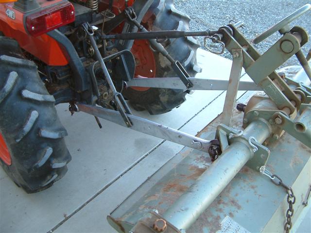

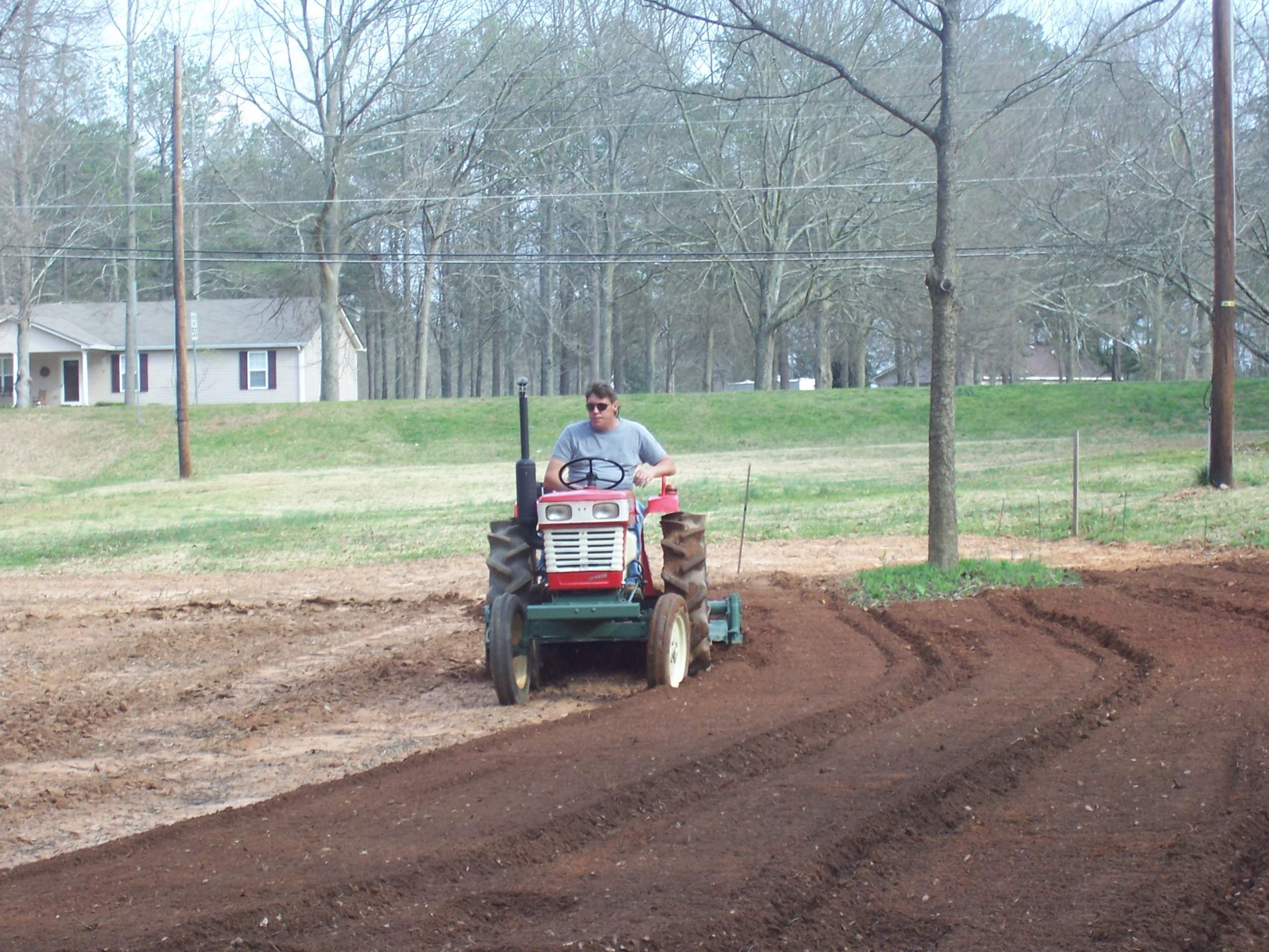

Here is a RS1400 gear driven behind a Yanmar 2000.I believe that I would have Chain stretch and Sprocket wear and with gear more of a heavy duty setup.Also I think this a pic. of the top link California was referring to.It is really user friendly when hooking up nothing to it.

That's it! The tiller isn't complete without that top link assembly, or the driveshaft. Thanks Carey! (I have a RS1400 tiller too - photo).
Everybody, watch out for ebay or roadside sellers who sell Japanese tillers without that top link.
Absent these components, all you've found is an incomplete project. The tiller may clear the tires on a larger tractor that has longer lift arms, but it can't be used on the intended size Japanese tractor without a lot of modification. People have posted here that they welded on new lift pins a few inches forward of the original ones, or like Flusher, put longer arms on the tractor to get the tiller away from the tires. It's easier if you set it up like Yanmar (or Mitsubishi etc) intended in the first place.
