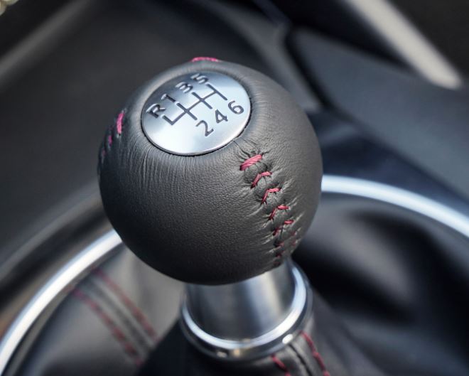

My son's Mazda Mx-5 is a manual 6 speed. You get to 55mph doing 6 clutch shifts. Fun to drive- keeps you alert and gives you something to do so you are not bored! This is the shift pattern: Capturdddddddddddddddde.JPG
