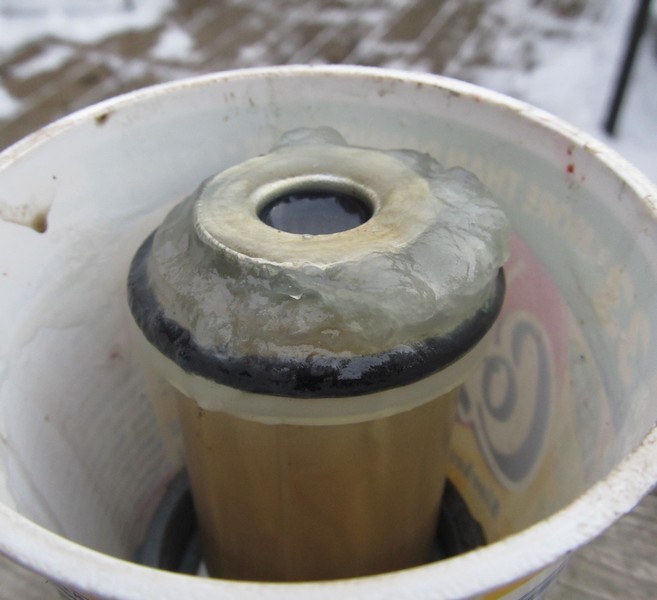

This is from a few years ago when I had first experienced gelled fuel and thought I was good to go adding Power Service(white). Pretty much had to do what Btown just suggested.

   / Gelled Fuel - How Much Additive #23
Sometimes if the fuel is bad its better to drain in out get new fuel and change the filters ,add power service . Its cheaper than a starter and battery
