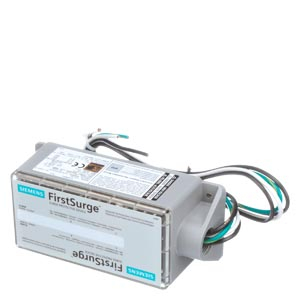

i have a Siemens FS140 ( 140,000 volt) surge on house and 1 on shop. nice, but sure as heck wont prevent damage from direct strike. were talking millions of volts

Like @grsthegreat, I put in the Siemens 140; cheap insurance in my book. I do have another half a dozen outlet surge suppression strips scattered around the house. Each one of them helps attenuate surge as well. (Each is another 4,000J, supposedly.)
