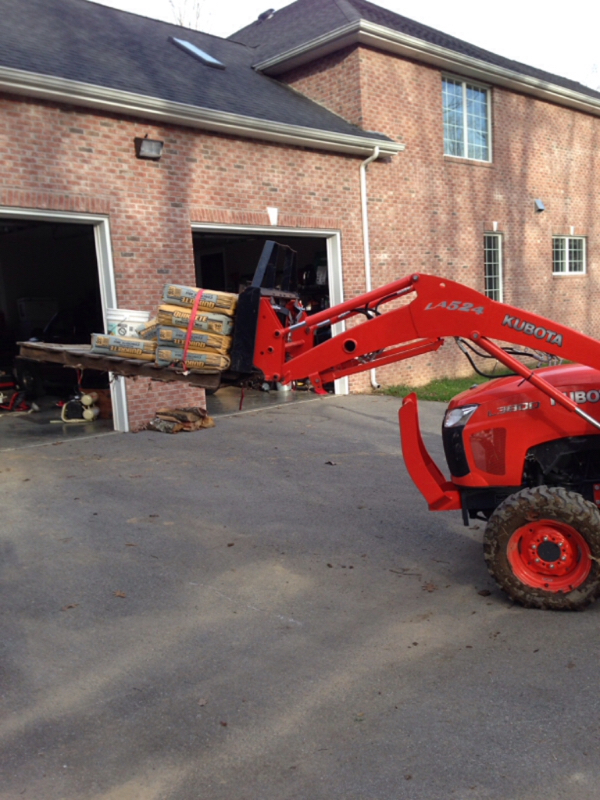

I would get 42" forks. Here is what a little L3800 can do with 1000 pounds. My LA724 loader which is rated almost identical to yours can lift quite a bit more.

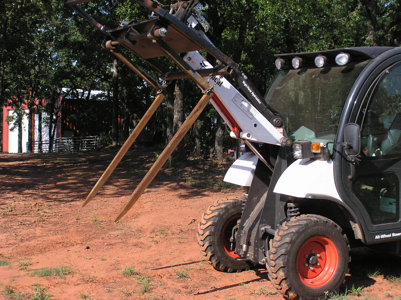

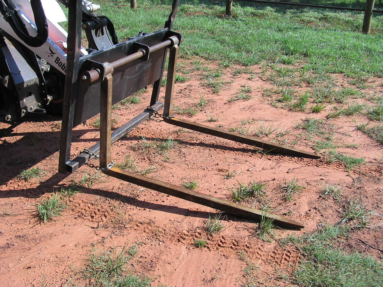

I have both types and prefer the "Pin Top" floating adjustable width style.
These are 2"x2", 48" long, "Block" or "Brick" Forks that I found on eBay. I put a short chain on them if I need them to do a max dump.
