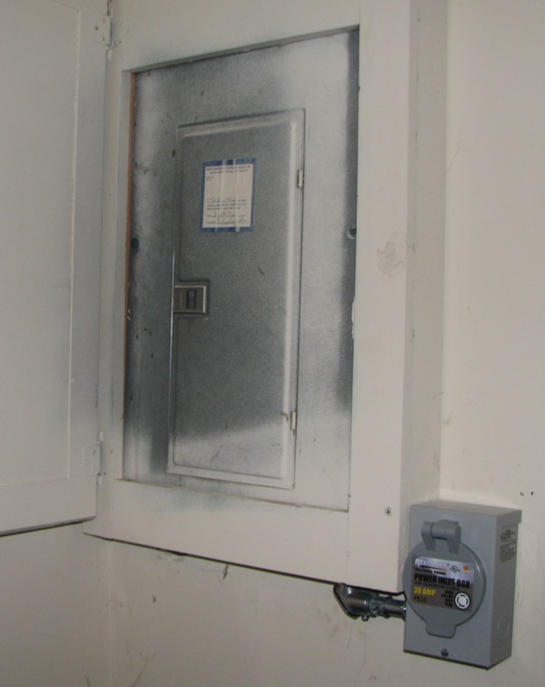

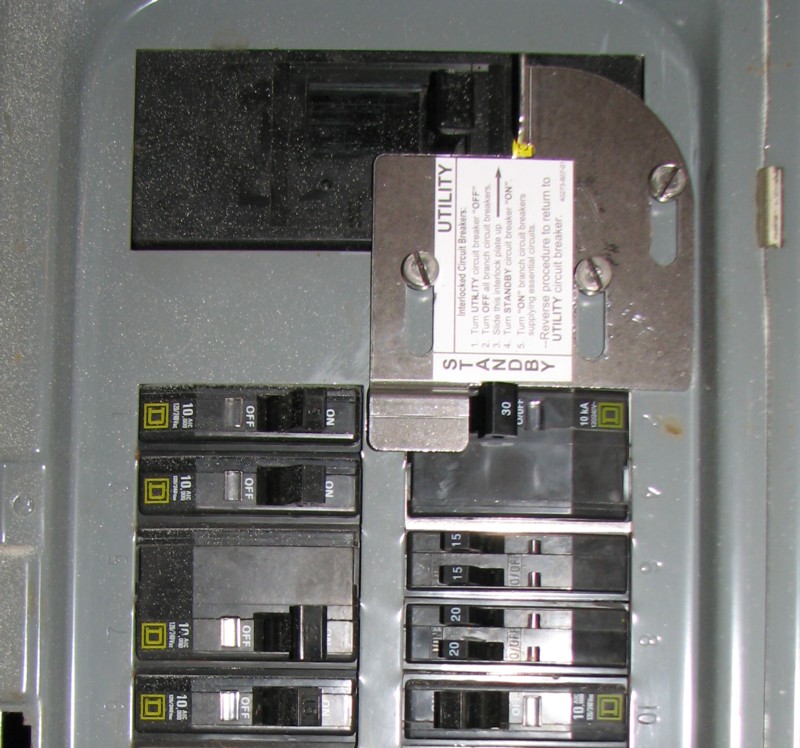

Here's my follow up concerning the information I requested.
I took the advice of daybreak1998 and CurleyDave and and want to express my thanks for their help as well as the constructive comments by everyone else.
The installation of the new breakers, the interlock and the inlet box went smoothly for a total outlay of about $214.00.
The house hasn't burned down or caught on fire even once and I didn't electrocute myself either.
The generator plugs in and provides power to any of the circuits that the breakers are turned on for. It all works just right. Thanks very much, again.
It has been discovered that many of the circuit breakers are mislabeled and I'm going to have to do a lot of running around the house turning breakers on and off, flipping light switches and testing outlets to assure that I really know what breakers are for what. It seems simple on the surface of it but that's going to take a lot of time and it's probably going to be easy to miss something. Is there some shortcut that I'm not smart enough to see on my own?
The biggest load for the generator and the main reason I needed it is the well pump. I wanted to make sure that the generator would be big enough so I did some more reading on this forum and decided to buy a cheap clamp meter. I tested the current draw multiple times and learned that the running the pump draws about 6 or 7 amps and that when I watch the meter closely during start up there's a momentary surge of about 16 amps. When the peak hold function of the meter is used it records a 30 amp draw but I'm convinced that is of very short duration. In any case the generator I got starts and runs that pump quickly and without any apparent strain. I'm happy about that.
Here are a couple of pictures of how it turned out. Thanks again!
   / Generator and electricity flow #110
The electric runs will be grouped together like upstair, downstairs, living room, bathroom, etc. Most runs will power at least a room and often a larger area. Shouldn't be hard to track everything down. You can then buy some small colred stickers and label the breakers according if you want on when feeding from generator, want off, or occasionally want on. Kitchens normally can have a number of breakers including 220v feed.
