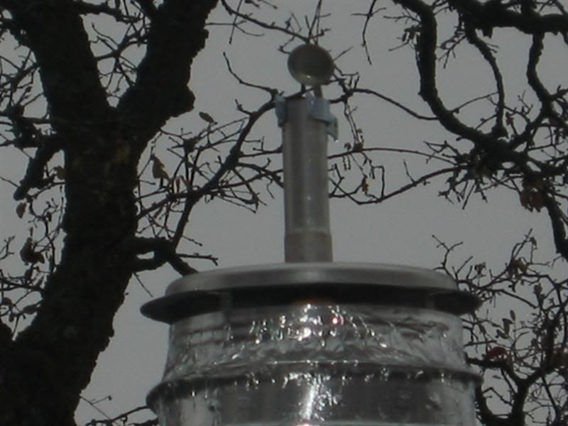

Here's what I did to my Cummins 20kW generator.
I ran the exhaust pipe through the roof and insulated the crap out of it where it breaks through.
I also put one of those flappers on it. It's quieter now than you would think, both inside and outside.
   / generator exhuast silencer? #19
Rob
Nice setup. Is there any problem with back pressure because of the diameter of the exhaust being reduced?
   / generator exhuast silencer? #20
EdC said:
Rob
I think that's just an insulator pipe. I think...looks like the way it's foiled together.
Rob
