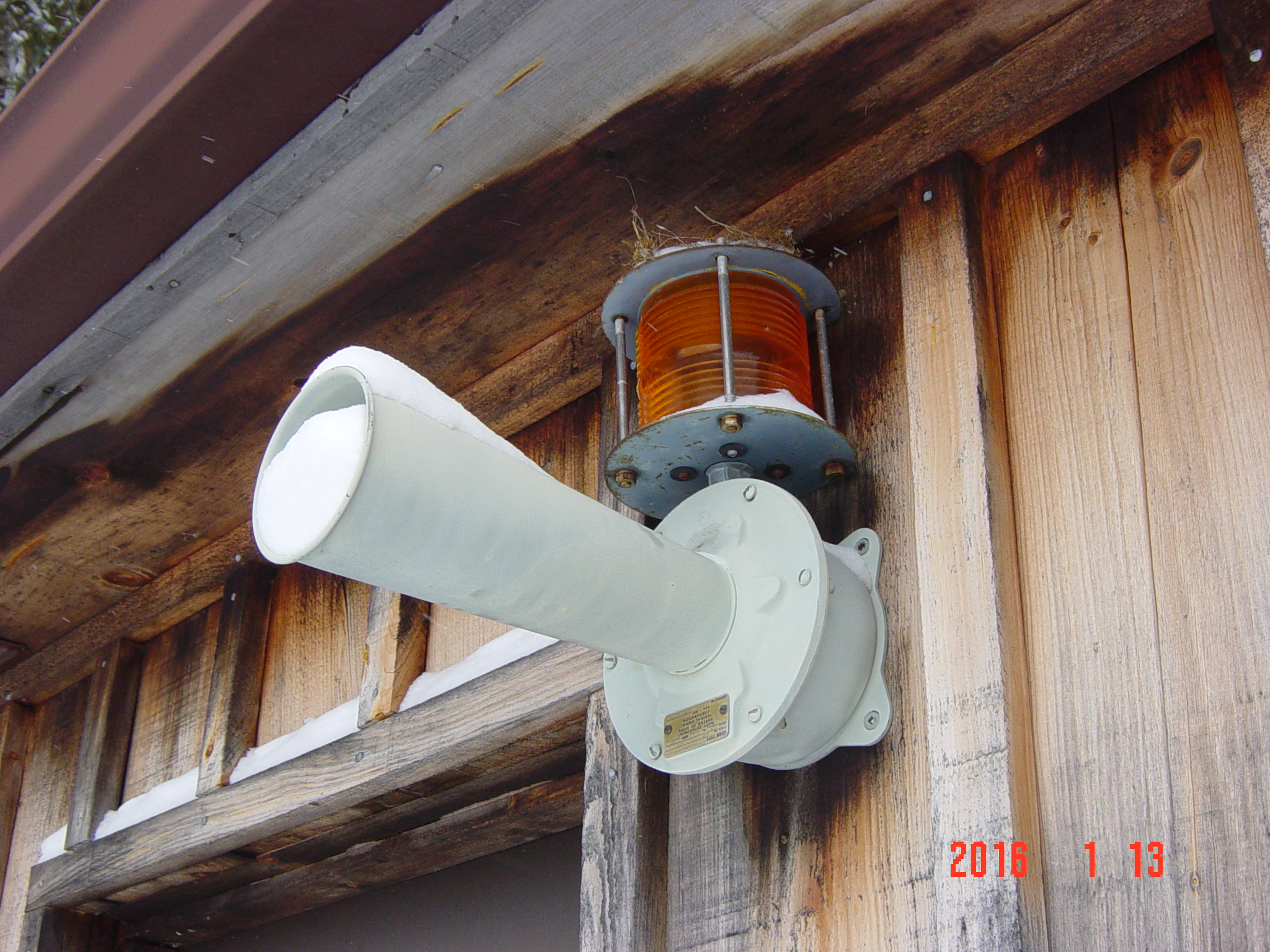

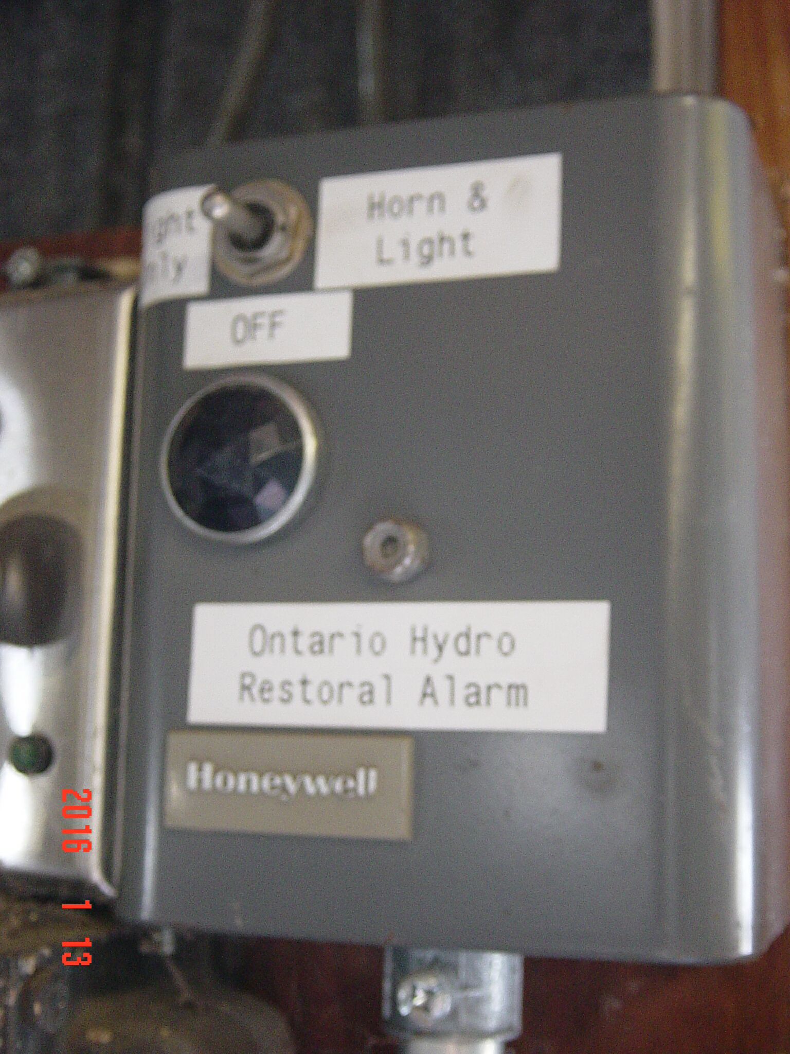

Seems like the lockout would be the best for this situations but again, how do you know the power is back on? :D
   / generator hook-up question #24
EASY
   / generator hook-up question #26
I can't give you the details. Safety issues have been addressed, although some still wouldn't like it. Having said that, there are inductive style (non connected) sensors available today. I guess, I should tie the thing into my ASCO aux switch contacts.
This was done many years ago, when I did have a PTO set and simply threw the main switch, opened the splitter and clipped on some big booster style clamps. Not something I would suggest to anyone.
Having worked back in the 80s as an apprentice electrician, working very often on live circuits, maybe I didn't think my hook-up arrangement was anything scary.
   / generator hook-up question #27
When the neighbors come over and says "Hey, the power's been back on for 4 hours!!!"
   / generator hook-up question #28
Ha ha, that's kinda what I was thinking earlier. Not too bad if you have close neighbors, but some people here have lots of woods around their homes. Personally I like my 6 button transfer switch. It does what I need, my 4kw inverter generator sips fuel and I know when the power is back on. I would love to go to solar with battery back-up but that would take money I don't have at the moment. Maybe in the future.
