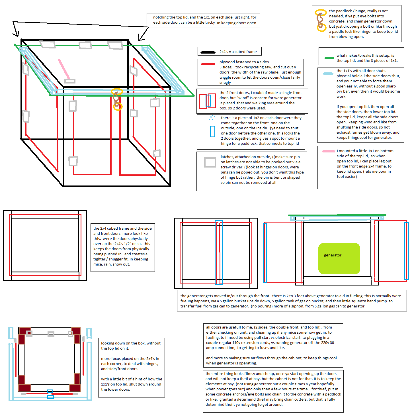

placing it in the shed, has some concerns of exhaust fumes / carbon monoxide gas.
when ya get into 50 amp plus, ok i will bite, placing generator out away from house, and by shed (on the outside) in its own little enclosure if need be, i will bite on that.

pouring a small concrete slab a couple feet wide couple feet long say 4 inches thick, (some 2x4's) and a few bags of pre mixxed concrete. pretty easy job, even if manually mixing it in a wheel barrow.
a couple sheets of plywood and some paint, or a sheet or 2 of metal siding for a metal barn or like. and some 2x4's or 2x2's and you have a mini enclosure / shed / doll house if you will. for generator to set outside. if ya toss in some eye bolt's in while concrete is being poured, you can run a chain through eye bolts and around generator with a paddlock to keep it from being stolen.
working on small engines, (weed eaters, push lawn mowers, etc...) to just driving in vehicles tractors into sheds. exhaust fumes get ugly quickly. and the fumes may not collect in area right were fumes are being created, but be concentrated much more in certain parts of the shed, and move about some with just a smallish fan or little blowing wind / opening a door togo in/out a couple times.
below not best diagram in world. but... *shrugs* maybe some more encourgment in placing genertor outside the shed. if not finding / buying / or building something to enclose generator.
