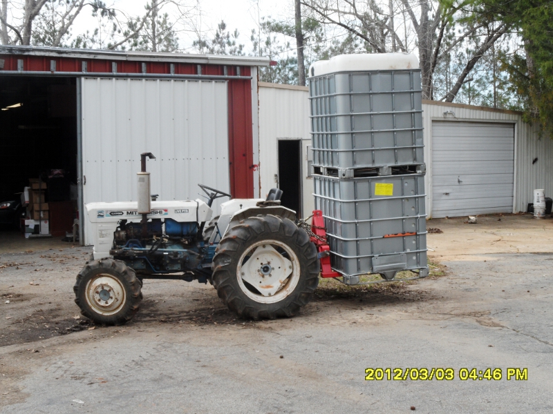

If a SHTF event occurs you'll need really large diesel tanks to survive long term (months) and a big investment in diesel. Wood powered is a good niche if you have wood, and many of us have acres of growing woods. I agree that a few jugs of diesel are handy. But even 600 gallons won't last long.

Sure it will. You just have to not run the generator 24/7. I can get by with my little gas generator on about 2 gallons a day just to run my freezer, refridgerator and well pump. We heat with wood and sleep when its dark. 600 gallons of gas would last me 200-300 days.
