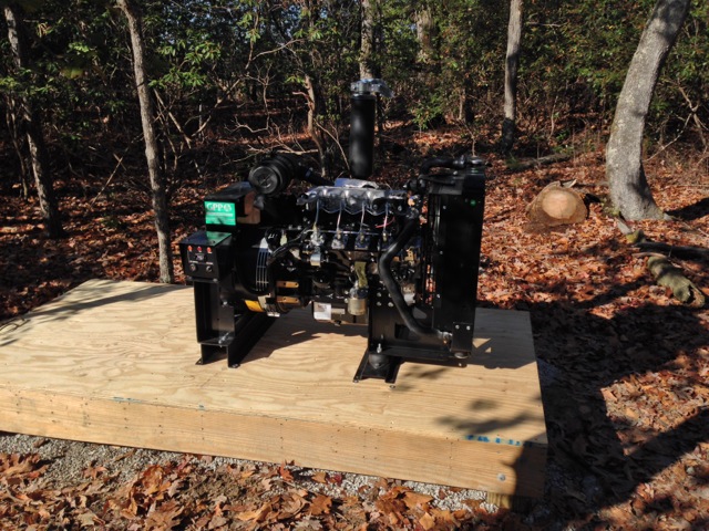

I bought a 21kW Isuzu from Central Main Diesel for $7500. Probably spent another $800-1000 in materials and supplies, and $1400 to build a shed for it. Have not had a power outage yet, but it should be able to handle our 4-ton geo-thermal system along with other necessities.
Here it is before we finished building the shed around the generator:
I'll do a full thread once I have time. Lots of pictures and notes to share.
