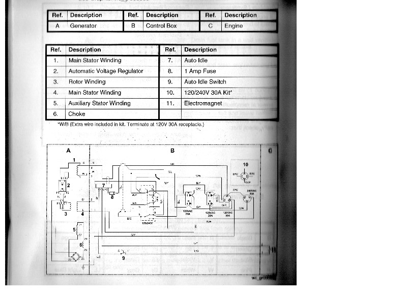

I considering a transfer switch installation for more convenience and versatility from the generator. The generator has a 240v 3 prong outlet and the transfer switch connectors are 4 prong. The generator schematic indicates the prongs are for hot, hot, and ground. Is there a practical way to get to the 4 wire cord with neutral and ground required for the transfer switch connection?

If the schematic for your generator looks like the circuit #2 in the attachment then the center tap that is drawn as a ground would be your white wire which is the neutral and not a true ground wire.
If it is drawn different than that could you put up a drawing so we can see what you have.

Maybe you can read this

Can't read the schematic, looks half faded out
Ref #10 120/240V 30A Kit
The note *W/B (extra wire included in kit, terminate at 120V 30A receptacle)
Clearly your generator supplies both 120V and 240V.

I was talking about the generator. There are two 120v, 15 amp duplex recepticals, and 1 30 amp L5 120v receptical that have both neutral and ground connections. My thought is to utilize the 240 volt outlet wires and pick up the neutral from the 120v circuits and run a 4 wire receptical. Sound reasonable?
/ generator/transfer switch connection #14
Yea sounds good.
