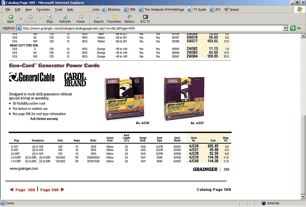

   / Generator Voltage Question #12
If your 120/240 volt outlet is a 20 amp outlet then this would probably work.
   / Generator Voltage Question #13
If your 120/240 volt outlet is a 30 amp outlet then this would probably work.
These cords have a box on the end with both standard 120 volt outlets and a 240 volt outlet.
They are pricey but if you want to utilize all of the power available from your generator this is the way to do it.
   / Generator Voltage Question #14
Here is the specs on these gen-cords.

Grainger has just about anything but one thing about them, they sure are proud of their stuff! If a fellow was handy he could build the same cord for $50 or under. The last time I bought SO cable, which you could use instead of the SOW, it was under a buck a foot for 12/2 w/ground. 10/2 shouldn't be a lot higher. If I think about it I'll price the parts out at Lowe's or Home Depot when I'm there in the next day or two and post them.

the cheapest 10-3 sow cable i could find was atr walmart in the rv section, colored orange and has a regular plug and recpticle on it about $27.00 for 25 feet, i cut off the ends and added my own special plugs ends to fit into my transfer panel and generator, used a separate ground wire on the generator (always a good idea). works well, and was the least expensive cord i could find.
