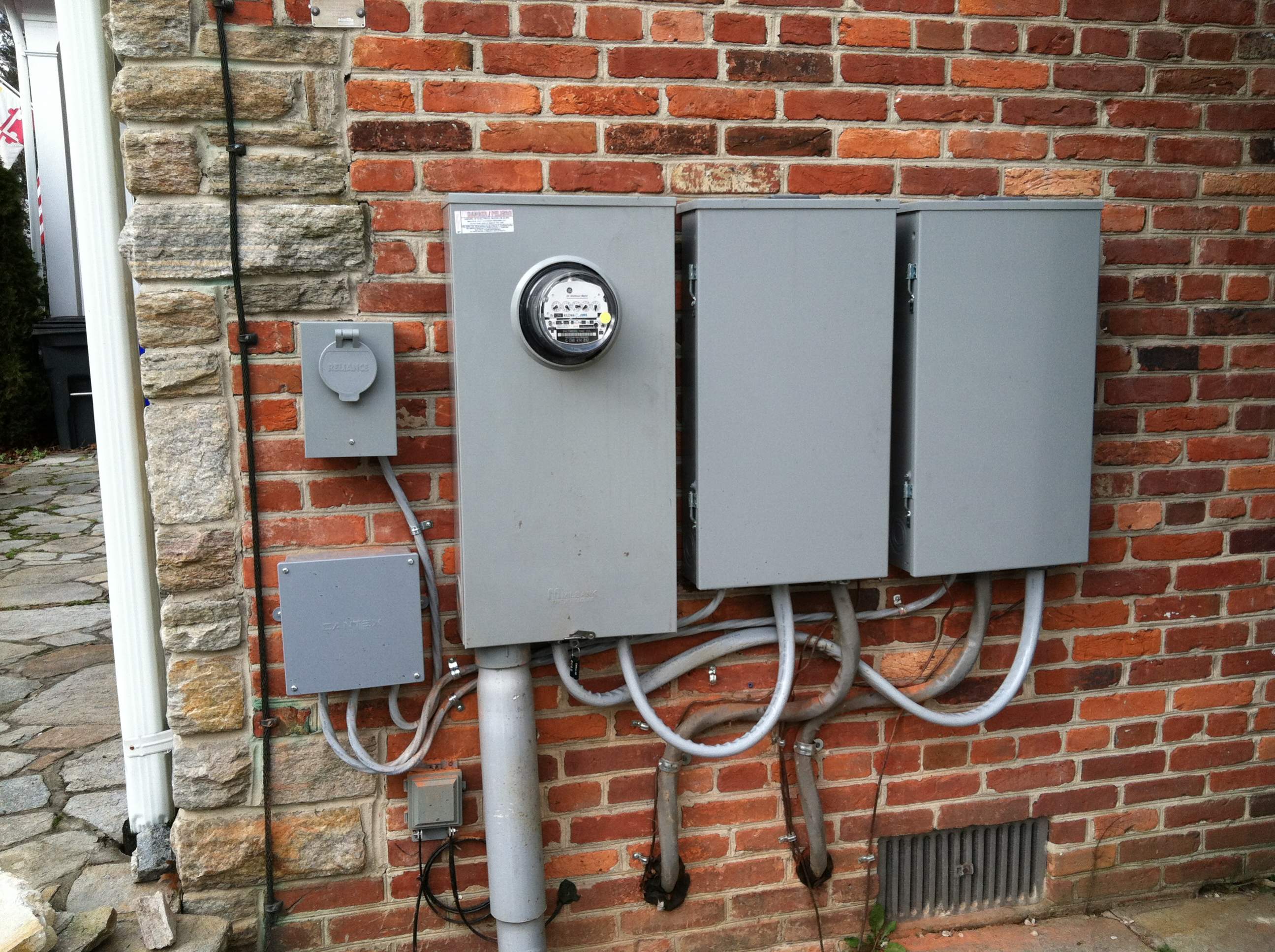

I just installed a whole house system for a little over $4000. The 10KW PTO generator and 50' cord where just over 2K and then two 200A manual transfer panels, inlet and installation by a qualified electrician came to just under $2000. I have a natural gas boiler and water heater that runs off the the boiler so they don't need a lot electricity to run but they won't run without it. I also have an 8 zone two compressor split AC unit and I should be able to run one compressor at a time.
