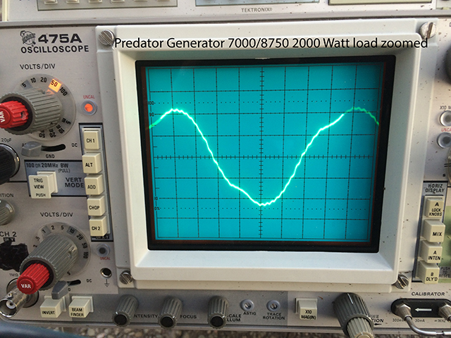

my harbor freight 7000 watt genny is close but not as good in regards, also doesn't hold close to hz like the wen more like 1.5 +/-.
THD on my HF generator is "< 23%" per the manufacturer.
/ Genset question on THD #7
this is the HF at 2000 watt load

/ Genset question on THD #11
It actually appears closer to a true sine wave than the Wen, which apparently outputs a modified sine wave that ramps in a linear fashion to max voltage, then ramps in a linear fashion to the negative peak. The hash you see in the YouTube video is not harmonic distortion, it is noise. The only way to measure harmonic distortion is through a Fourier analysis of the wave form. Here is a short demonstration of how to measure harmonic distortion.
