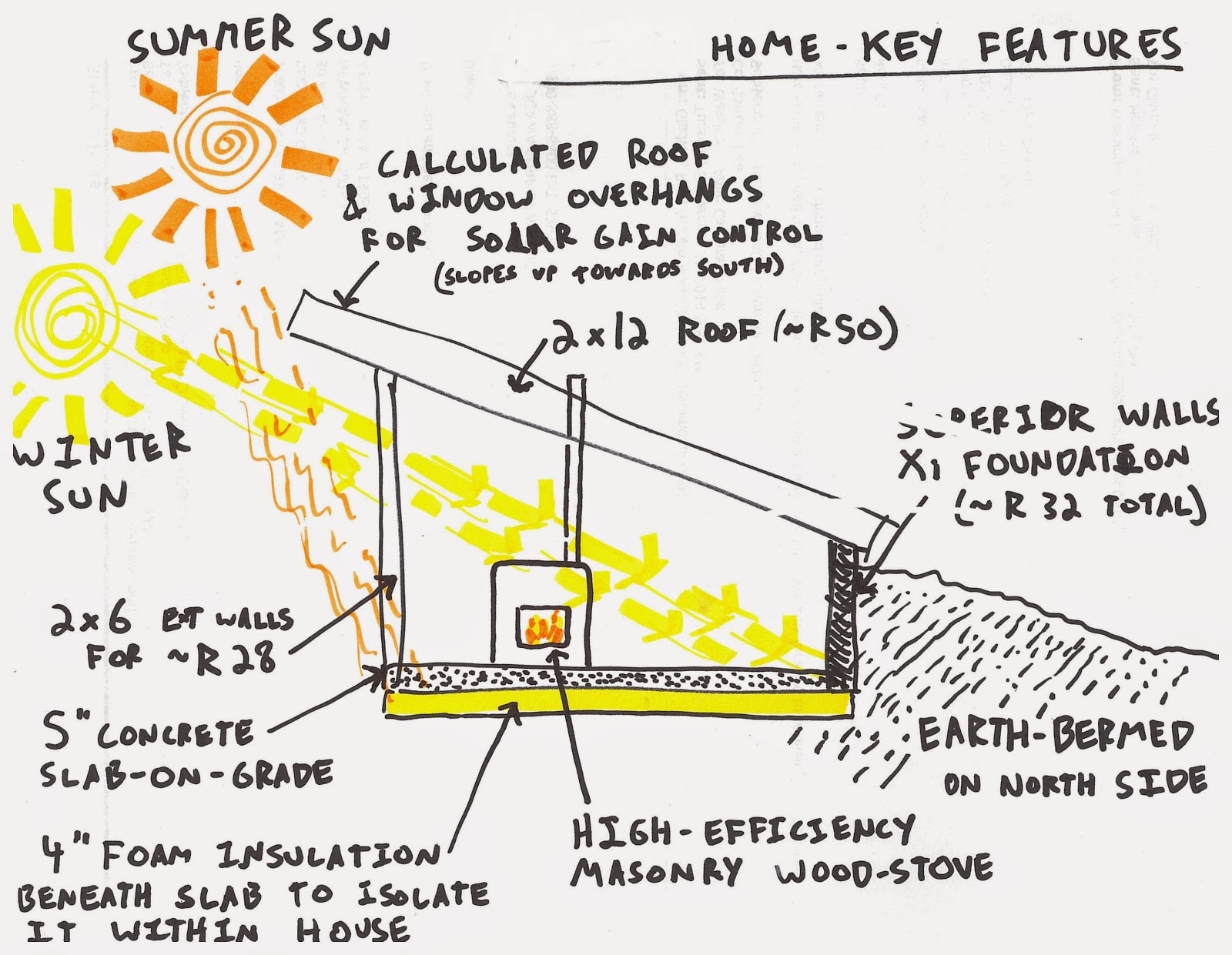

The current home is very well insulated but we also have a lot of big south facing windows which is great in the winter but we need to close big heavy curtains in the summer to keep the house cool.
You could consider building some roof overhangs/awnings. Awnings could even be hinged for seasonal adjustability.
Curtains might block some of the heat, but a ton of it is still coming through the glass and being trapped inside. You really need to just keep the direct sunlight out.
Here's a doodle I drew up when we were designing our home. These are basic home design features that essentially cost nothing to implement, if you plan for them.
