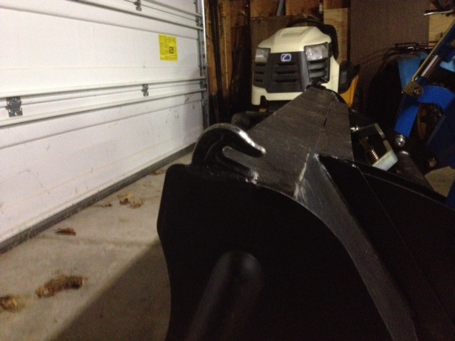

Here is where they welded the bucket hooks
I would have welded them in line with the FEL cylinder arms. It gives you a more stable platform that way. They are likely stronger at the point that the dealer added them on with less likely to bend the bucket lip since they are right up against the bucket side wall.
I always but a reinforcement pad under any chain hooks. I make the 3/8" thick pad square and as wide as the top lip on the bucket. I have hooked as much as my tractors would lift and no sign of bending, even used the chain hooks to drag out huge trees that the tractors would spin all four wheels doing so without issues.
