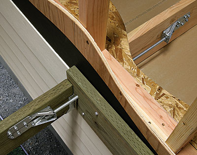

And for decks, new code requires structural brackets that actually tie the deck joists into the building framing. Simpson makes a bracket that screws on to the side of deck joists, and then threaded rod runs from that, through the rim, and into the building's framing -- tying into the interior joists (blocking can be used to help line them up). We have those about every 2-3 joists on my front porch framing. Really ensures that the joists are going to be held to the building. Here's a typical setup:
