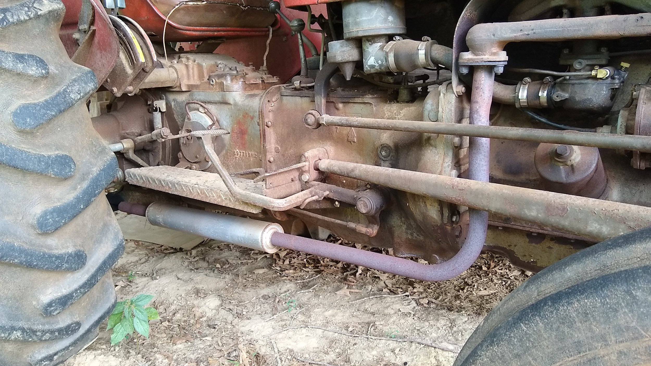

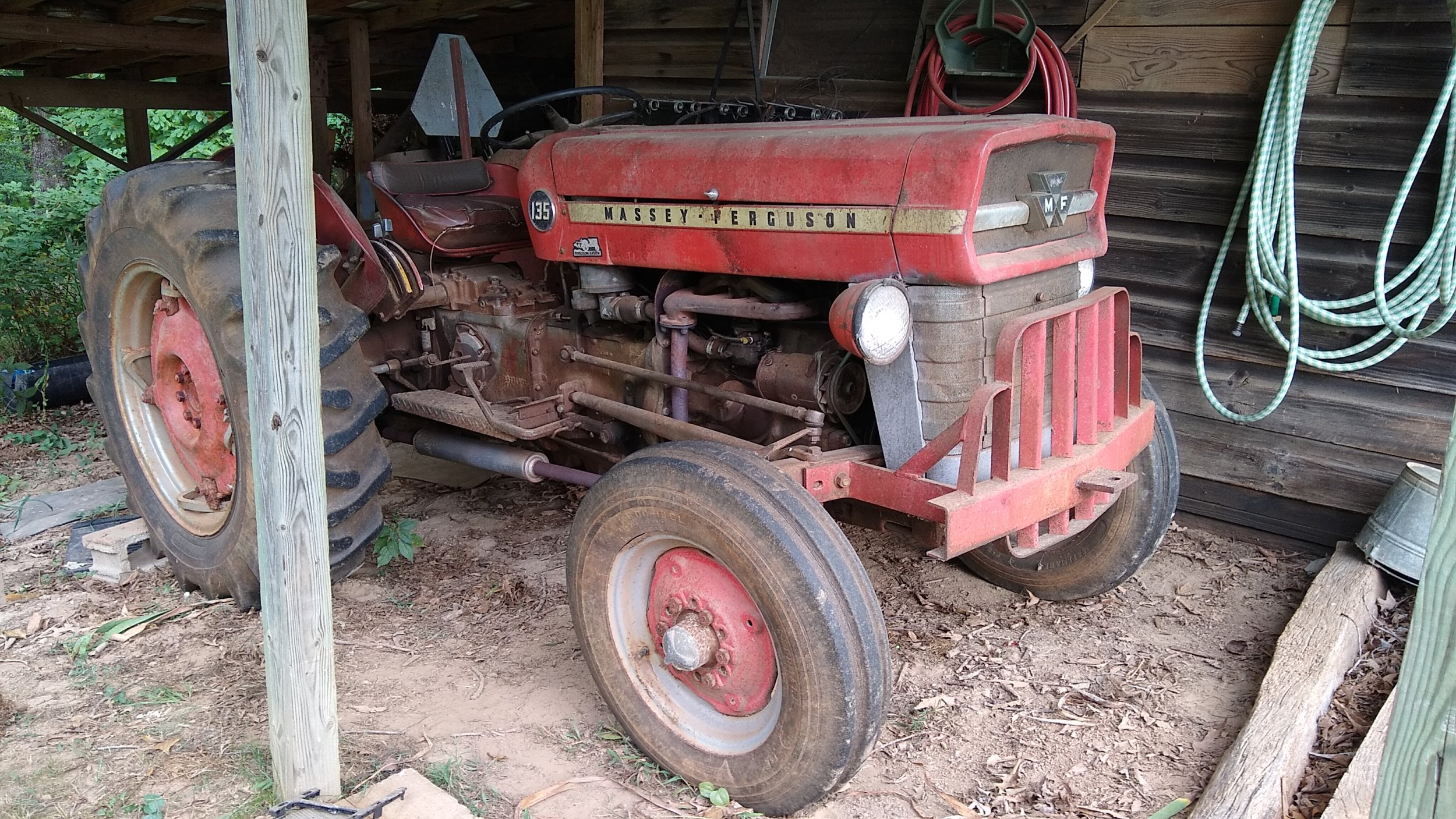

Here are some pictures of the tractor:

- I remember my father put the low pipe on it. It came with the pipe that went straight up. But that low pipe has nothing holding it up! Seems there should be some sort of hanger/support on it. I've looked at pictures online and seen others with nothing there too, but that just seems odd to me.

👍 Way to go. Now put the old beast to work. I would bend a piece of metal to fit from a lower transmission/bell housing bolt over to pipe then clamp with a regular muffler U clamp. Brush could push on pipe and crack manifold.

Observation: your left foot brake is on the floor. Probably just need a brake return spring.
